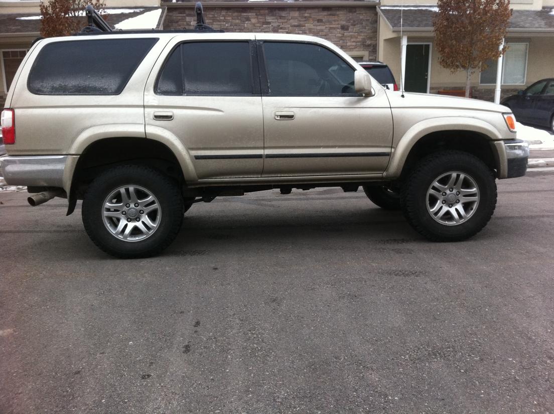

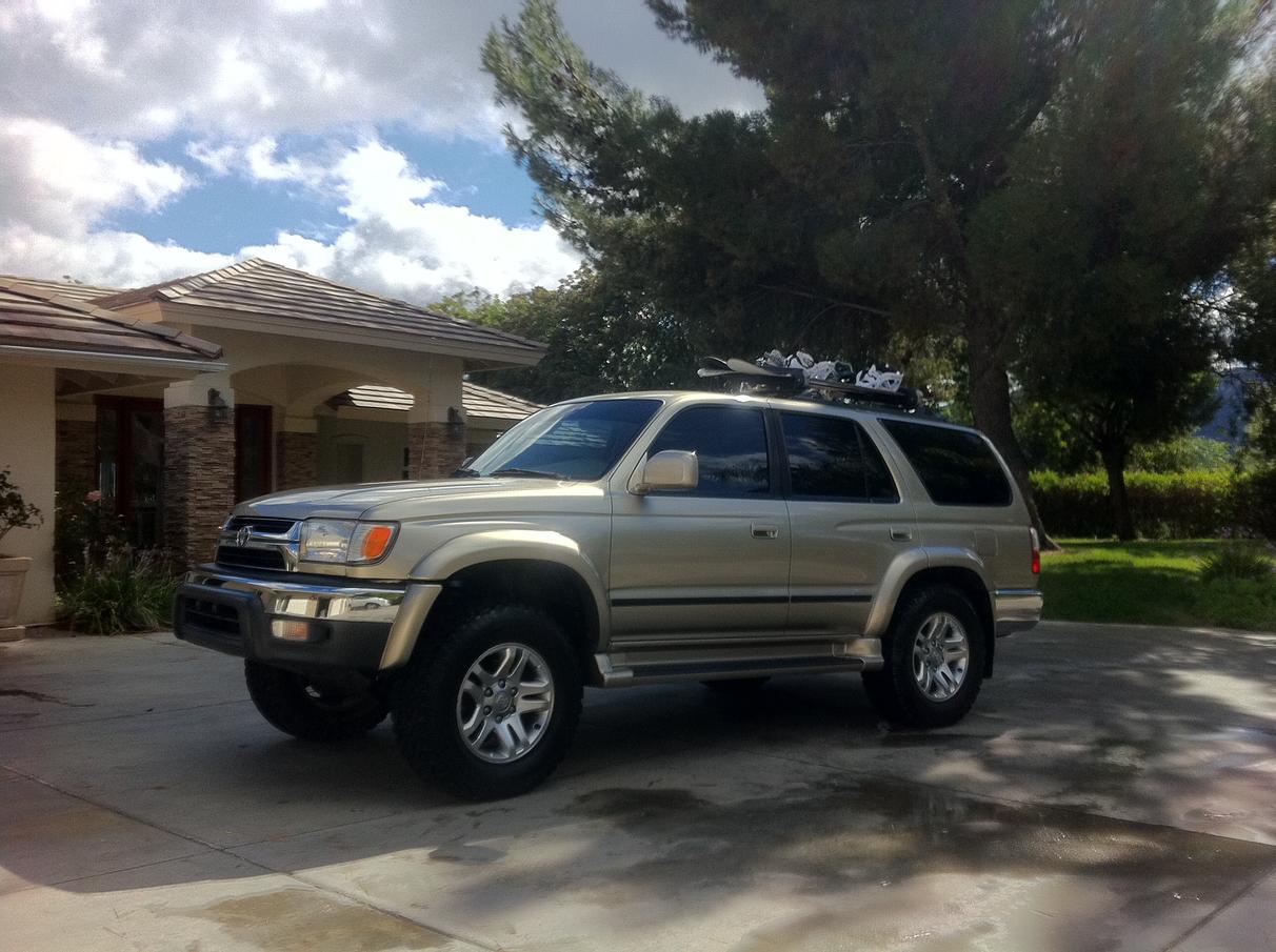

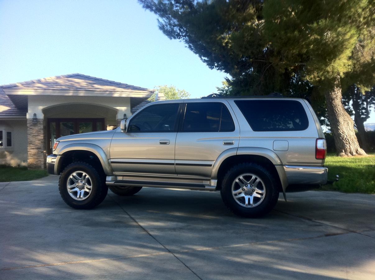

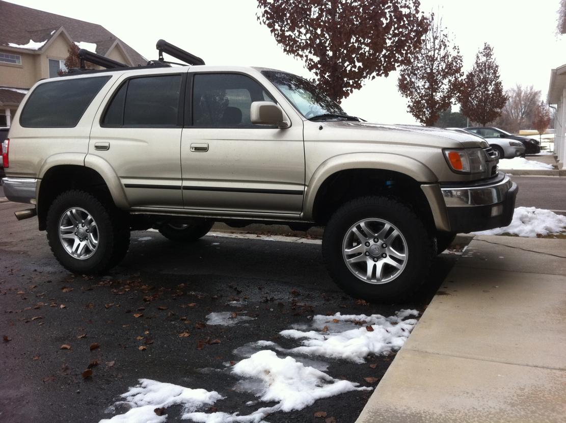

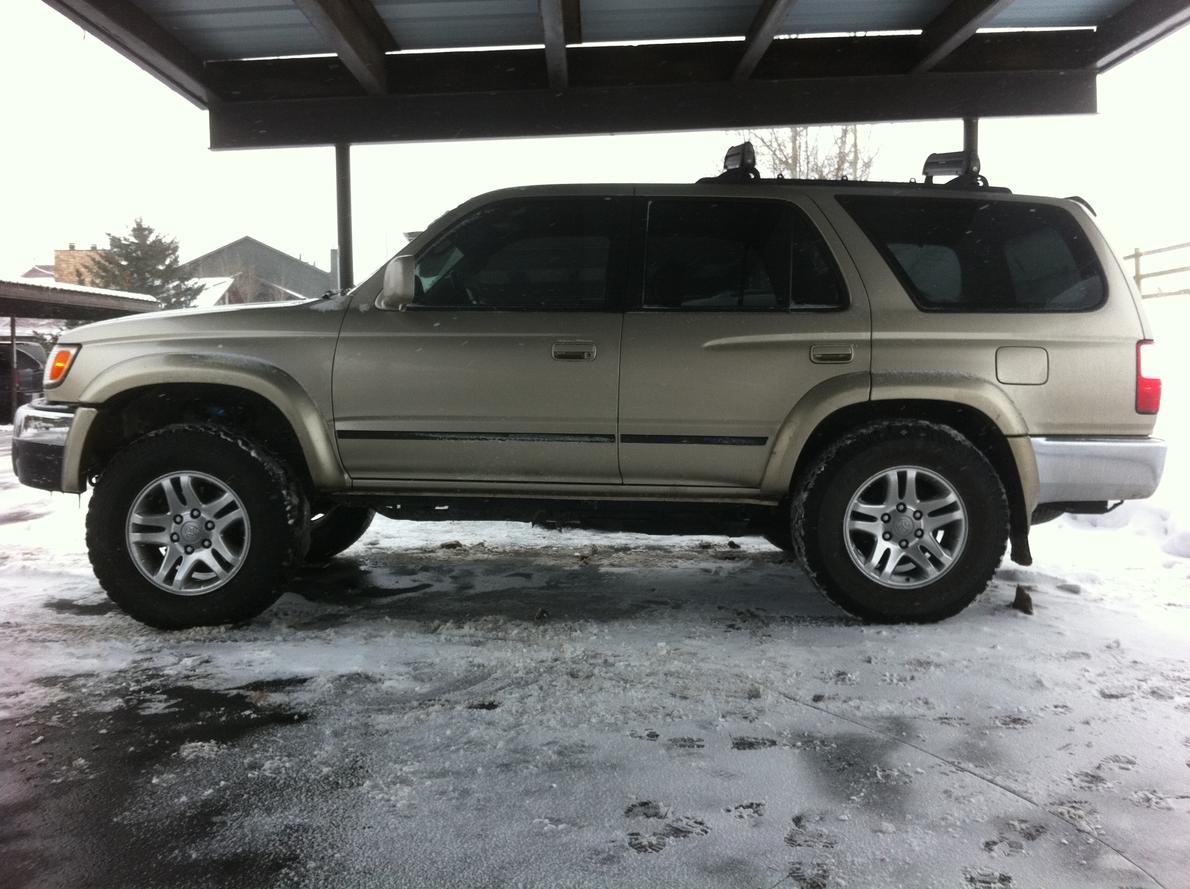

So I posted some pics before, and ppl gave me some advise that i was planning on doing anyways, and now that it is done I figured I would post some pictures, i just have kings in the front and LC 7.5 wraps in the rear, now the tires are to small at a 265/70/17, so once they wear out then ill get bigger till then they will have to work! Also need to level it so it sits even stitting 39.75in rear and 37.75in front. Thank you to all that helped me figure out what i need, and for the directions, i think she turned out alright for now! :thanks:
