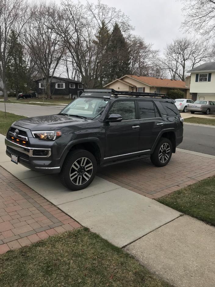

Bilstein 6112 Install on 2017 Limited
Install was pretty easy I would say the front came up higher than 2.5 from the measurements I took. I am guessing the stock suspension was sagging from the sliders and rack.

So with the setup you went with what are you’re initial impressions..?
Comparison going from stock to non stock suspension.
My xreas is still in good shape with only 50,000 mi. , freeway ride is very great on perfectly smooth roads and handling is great with xreas. I’d be willing to sacrifice some handling and nose dive with braking for a little more compliant and composed ride over less than perfect surfaces.

I only had 6k on my XREAS. I am happy with the ride I would say it handles as well or better than stock. The front is a little high but I am hoping it settels. I still need to get it aligned.
What clip settings in the front?
I'm going to do the same install on a 2014 LE. What circlip settings did you end up using for the front? And also what size rear springs did you go with?
