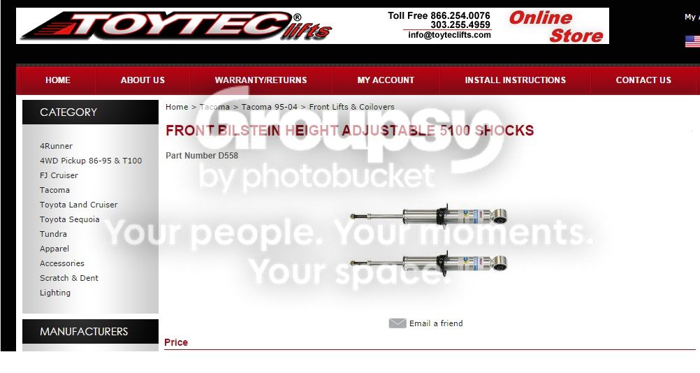

Toytec's 4runner Front Suspension Page-D558 Bilsteins
Toytec's Tacoma Front Suspension Page- D558 Bilsteins
