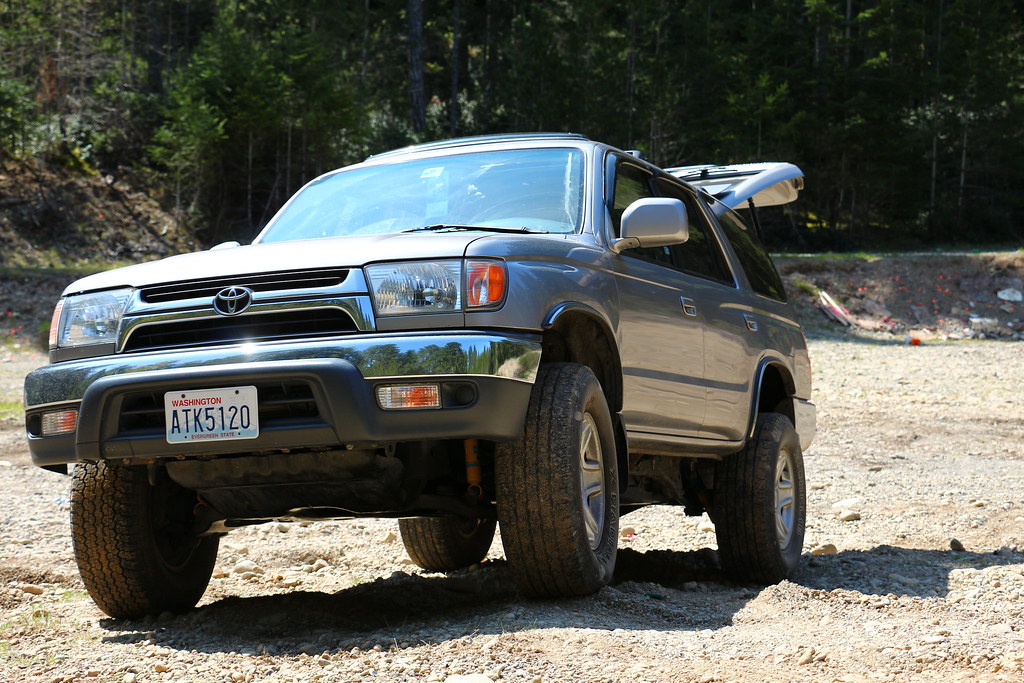

Great! Although I ended up going with Tacoma 5100's front & rear from Wheeler's Offroad instead of the HD's. These, along with the OME 880/906's provide a very smooth ride. For my preferences, this setup is perfect. I did install the 10mm trim packer on the driver's side front, so there is no lean at all. Unfortunately, I forgot to take before & after height measurements to see how much lift was gained, but it's definitely noticeable.
