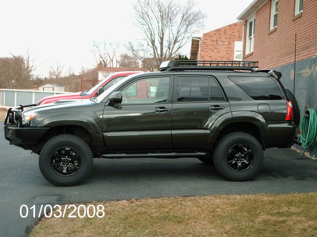

Cool just keep in mind with spidertrax spacers and this set up you can run 285-70-17 which are 33s for the most part I have a set of DR rear spring up 4 sale right now because I up graded to 895 to hold my tire carrier. If you are looking to go up all around I am trying to get 125 + shipping. For those. I attached a picture of mine so you could see what you would get.

DAMN!! thats a bad ass 4runner!! i'll let you know man
I totally agree !!!! Damn nice truck !!!
What size tires are you running ? What are the other specs on the truck ?? Impressive work my friend.
Falls arnt you on 120 if not I think someone is using your name.
Thanks for the comments and the build is as follows
ARB bumper front, I built a tire carrier that holds Hi lift and cb antenna for the rear.
884s over bilstein 5100 front
DR FJ springs and OME 142s. Soon to be 895s and 142s
Black widow roofrack that I cut and welded to make it what I wanted it to be I am going to add lights this summer side and back.
Spidertrax spacers.
4R sport wheels painted black. 285/70/17 Firestone Destinations A/T.
Best part I still get 17.5mpg corrected in town and 18 on the highway.
