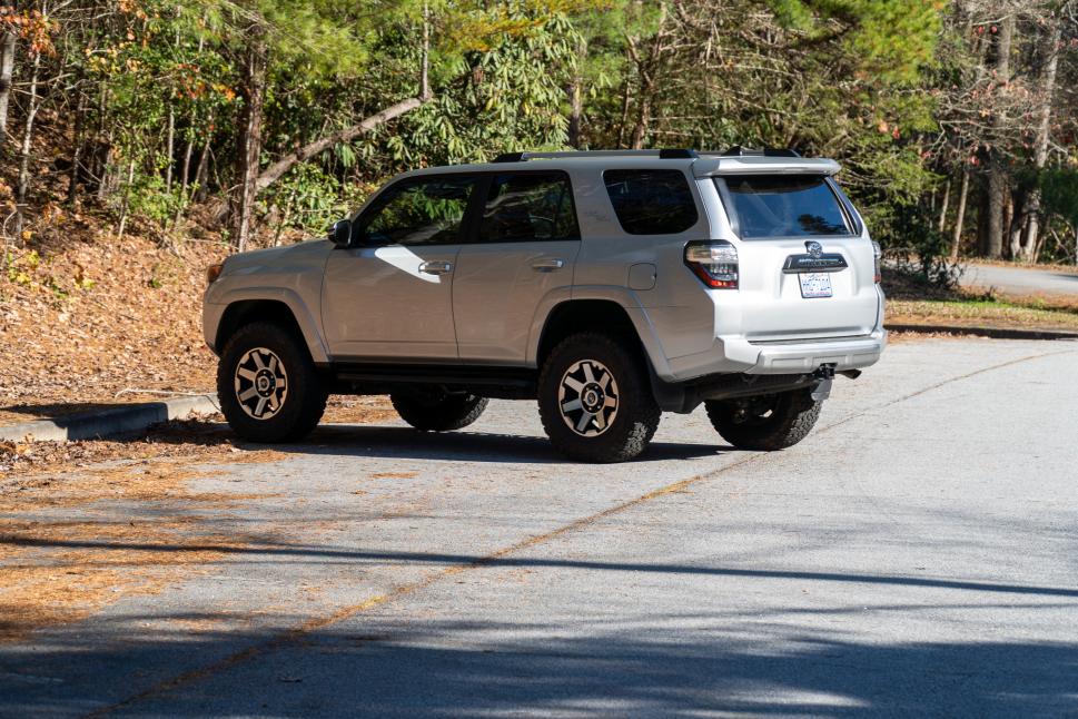

I have this lift and used the OME 2889 Medium Rear Springs. I attached an old pic of it....
I've been running that same suspension for a year now (21k miles) I installed the Icon 52700 rear springs to match the 2" lift in the rear. They made a HUGE difference supporting a heavier load in the back. Unloaded, the truck has a slight rake. Just for reference the only other mods I made to my suspension are JBA upper control arms and greaseable bushings for the front sway bar. I wouldn't worry about a diff drop but might consider the sway bar spacers. Zero problems so far
