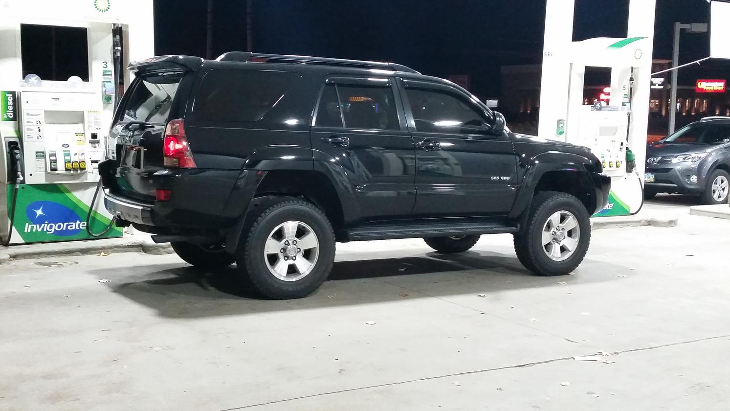

Here's mine set to Max at the front. Rest of details in sig. I'm pleased with how it turned out.

Lookin' real good, DTA1984. I'm thinking of FJ coils with the Bilstein 5100s and the Daystar 1.5" rear spacer for my 06 Sport V6 4x4. Have you discovered any drivetrain issues (i.e., CV axles or diff drops) with this set up?
Thanks
Thanks
Thanks! Sorry for the late response.
My cv axles are good, no leaks or tears. I have had a slight driveline vibration between 20-30 MPH. I have narrowed it down to most likely being the increased angle of the CVS. I am going to do a diff drop once it warms up a little.
