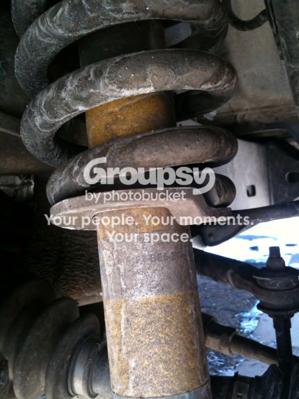

post up a picture of them installed. it is possible that the spring seat was installed upside down which would result in extra lift.

Make sure that the spring seat has been installed right side up. It should resemble the image below. The seat is now made from steel.
frontcoilshock.jpg~original

your shocks are probably the adjustable 5100s and you need to adjust the spring perch on it.
X2^^^
I installed 5100's on my 01 Tacoma a while back and they came set at the tallest setting (2.5) right out of the box (collar is on the top notch for 2.5, bottom notch for factory). Check the setting yours are at.
