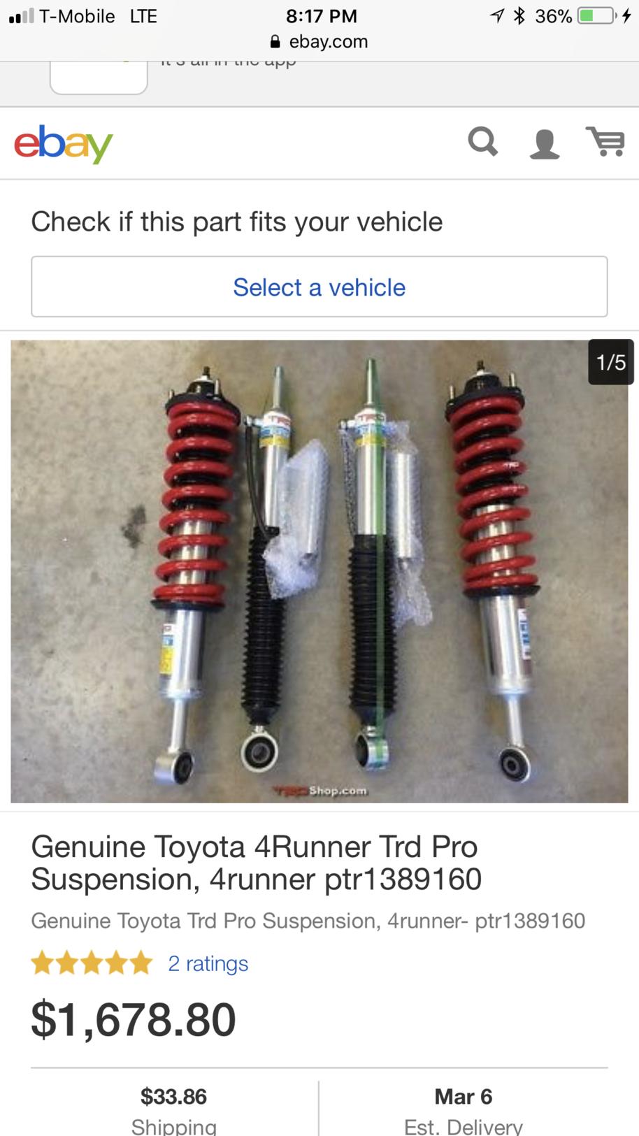

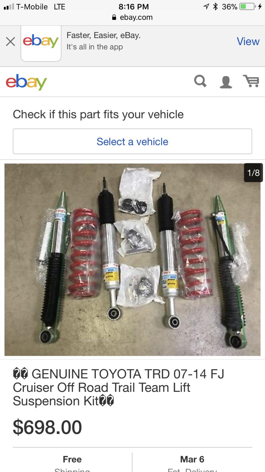

Here are a couple of links with pics to compare the FJ team trail kit to the T4R Pro kit. Top hats are included and coil overs are assembled on the T4r Pro kit. FJ kit, no top hats included so not assembled. Notice both kit’s 6112’s have 2 perch positions to compensate for lean. Rear 5160’s look to be identical. It’s interesting to note the Tacoma Pro kit, which was also on sale, also has 2 clip positions on the 6112’s. As far as I have read, all of these kits include 600lb eibach coils (Baja kit has 650lb coils). Both kits are claiming 1” lift (fronts).
Per the FJ forum and this forum, these should work on older FJ and 4th gen t4r’s. Rear Upper shock mounts will have to be enlarged and lower bushings trimmed though. http://www.toyota-4runner.org/4th-gen-t4rs/227434-4th-gen-trd-pro-suspension-retrofit.html
https://m.ebay.com/itm/GENUINE-TOYO...nsion-Kit-/183080402808?fits=Model:FJ+Cruiser
https://m.ebay.com/itm/NEW-OEM-TOYOTA-4RUNNER-TRD-PRO-FULL-SUSPENSION-KIT-/272299767862
