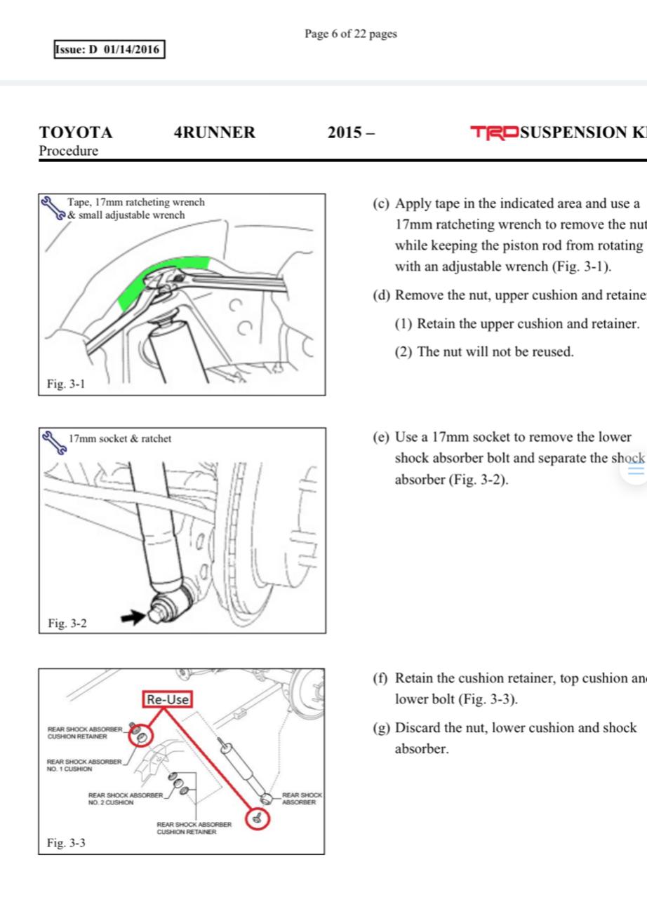

So I had a chance to purchase this kit on ebay, but I paid 900 bucks,

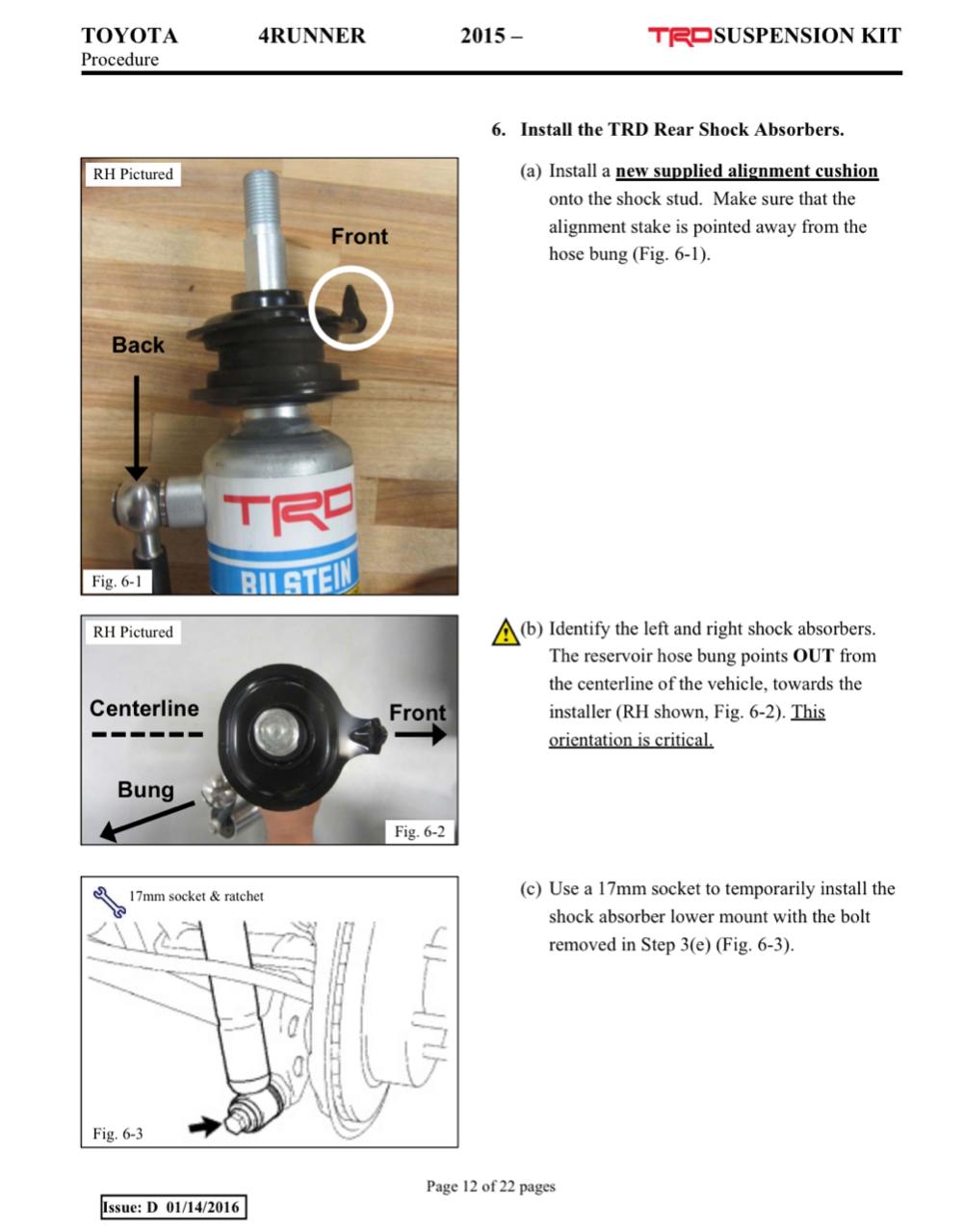

the only down side is it didnt come with the alignment cushion that is in the hardware bag #2.

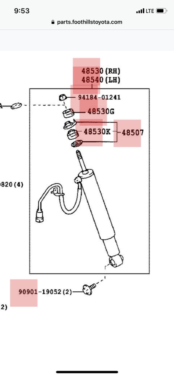

I think the part is only shown on the FJ suspension drawings from toyota. Has anyone else had to source this part and do you know if the the following is the correct part. I think I pulled it from the 2014 FJ diagrams, but I understand its also used on the 2018 4runner when installing the TRD pro suspension kit.
See figure 3.3 that calls for the part indicated in 6.1 photo. I believe this is the same part (48507)from the part diagram, but Id love to get some votes of confidence.
