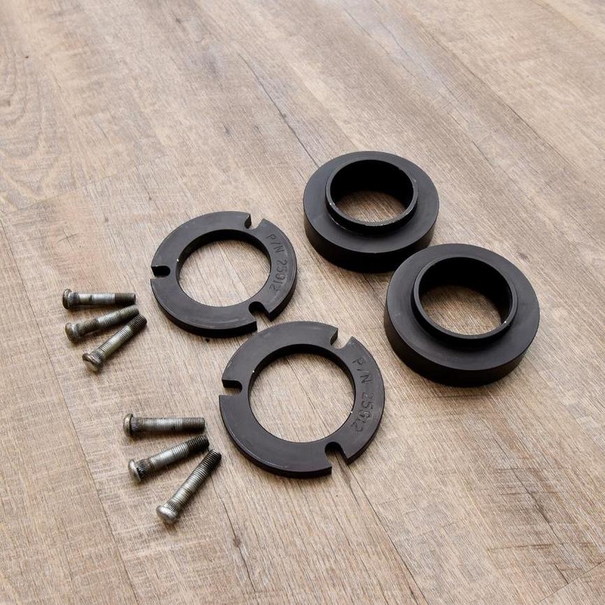

well the FJ guide cushions part didnt fit, called TRD USA and they couldnt help to get the two guide cushions that I need to install the shocks with. SO now Im back to you guys wondering if anyone has these parts or knows how to get them?
