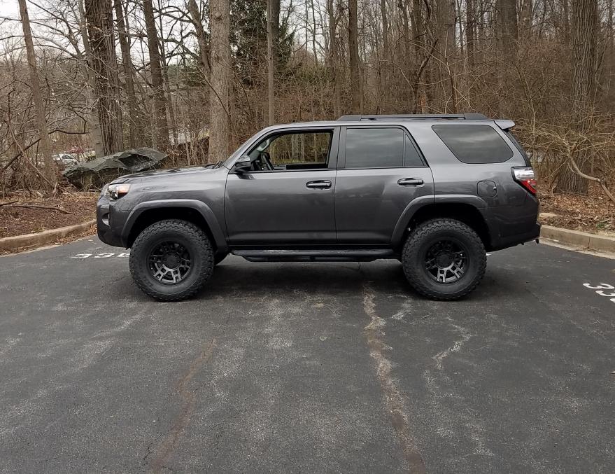

Yep they are in there to stay. Adding the Pro suspension provides .75" of lift over a stock SR5 Adding the lower ToyTec spring seat and 3/8" thick Cornfed top hat spacer provides an additional 1.75" of lift. I am at 2.5" over a stock SR5 up front with that setup.

No clue but I have aftermarket skids. That's really not how you measure lift. Only correct way to measure is center of hub to bottom of the fender with the truck on level ground. The Pro suspension adds 3/4" of lift on an SR5 which means the skid plate go up the same 3/4" If your fender height moves up 3/4" so does the skid plate height.

You only got more there because of a dip in the ground. You didn't gain anything more at the skid than you did at the fender, it's impossible. The body and frame move together, the skid is bolted to the frame. Now when you add larger tires that will increase ground clearance so that will of course increase the clearance between the skid and ground. The ATZ P3 have been great so far. I run them in 295 so they are E rated and very heavy. Each tire and wheel weighs in at about 95 pounds. So far it seems running them at about 32 PSI yields the best road contact patch.
