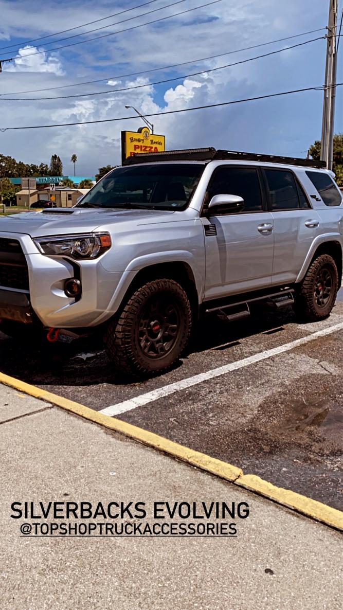

I’m planning on lifting my 2018 TRD OFP with the ToyTec + 2 FJ4RPRO kit for the Bilstein TRD Pro suspension on my 4 runner. I’m curious as to any issues I may encounter with doing a full 2” in the rear with KDSS and any issues with the front being this set ups already +1 compared to the OEM set up.
I’m current running a 1.5 inch difference from front / rear. What would you guys do? I’ve already purchased new UCA’s and the ToyTec kit but I rather ask now than later lifts scheduled for the end of this month. Here’s my current set up

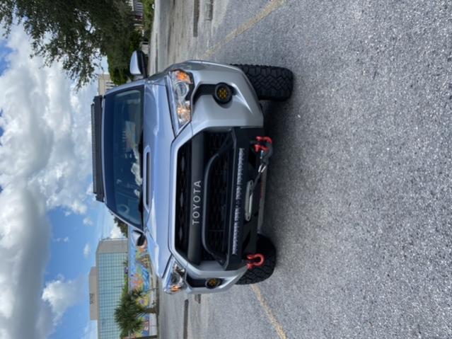

Just added this C4 Lo Pro bumper / winch / light bar as well - tried to add it to the above post sorry. I know that probably plays into things some it def wasn’t light picking it up so I know it probably brought the front down a little bit. Debating just buying new coil overs for the front instead of the Toytec spacer / thicker collar.
