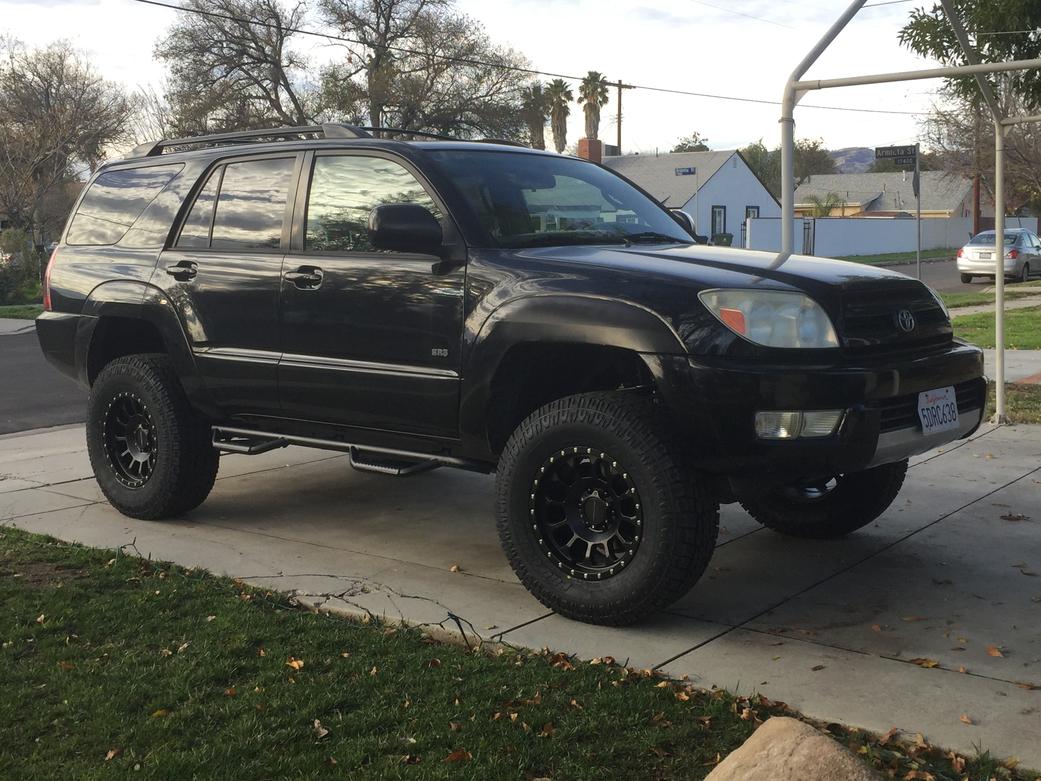

I debated for months between these two lifts. I wanted o keep cost down. However, I was finally convinced by a few close friends that had FOX to go with their stuff. I spent much more than I wanted but I am extremely happy! More pics to come when I get a few more things done.
Fox 2.5 Coil Overs with SPC upper arms
OME 884 coils in the back with Fox Shocks
