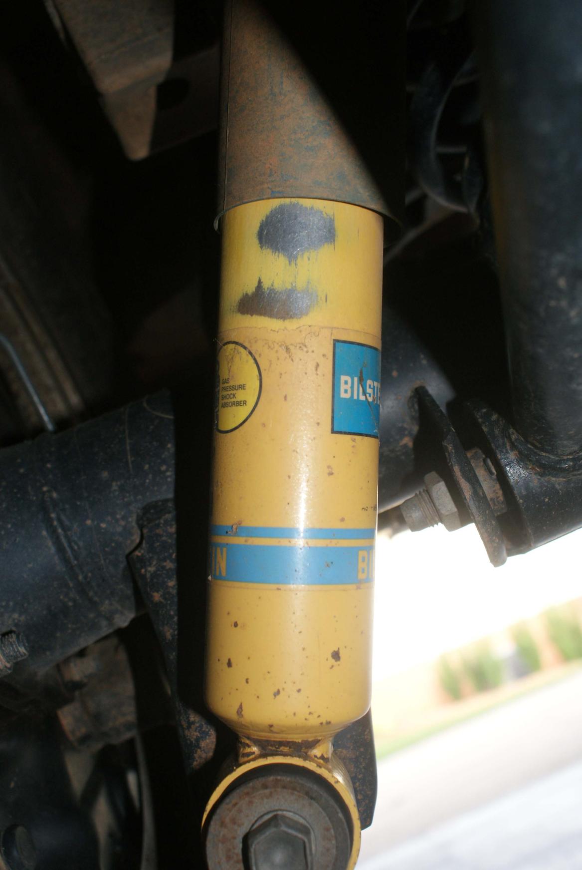

So i bought my '98 with Bilsteins already on it (front and back), however, the rear springs had not been replaced and were sagging a couple of inches (and were not covered under the recall). I had a set of coil spacers put on the rear springs which fixed most of the rear sag problem, only leaving about an inch difference. Although the inch difference is barely noticeable, it still bothers me and i have been searching for some new coil springs to replace the stock ones. does anyone know if OME springs combined with my Bilstein shocks will solve this rear sag issue?
also, i cannot get a good angle to look at the part # on the rear Bilsteins so if anyone can tell what model these are that would be very helpful

Those are bilstein HD shocks I have the same ones on my 98 and I called toytec to ask them the same thing the other day and yes they will work fine and solve your sagging problem..hope that helps..btw what size are the rear spacers?2.5 inch? I'm looking for some to buy
