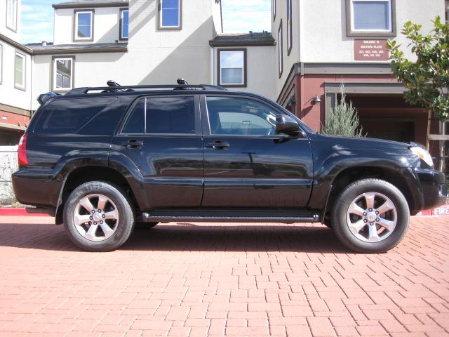

I got a reputable auto shop to install the Bilstein 5100 front on the 3rd line (1.75). They got the wrong part for the rear Bilstein 5100 and I will bring the vehicle in the next couple of days. As may be able to see in the picture, the front is slightly higher than the rear. The shop guys assure me that the front shocks take about 3000 miles to settle in. Also, they mentioned after I install the rear bilstein, the rear should raise about 0.5". What's your experience?
17.jpg~original
In the front, the space between the top of the wheel to the fender flare is wider than the rear as you can see in the pic. I do not like the look, I like it to be level or the front slightly lower than rear. I think here are my 3 options:
(1) Install the rear bilstein and hope the rear raise by 0.5"
(2) Install rear coil 1 inch spacers. (what manufacturer offers a rear coil 1 inch spacer for 2010 T4R?)
(3) Re-install the front to 2nd line at 0.8"?
Which option should I take?
Thanks.

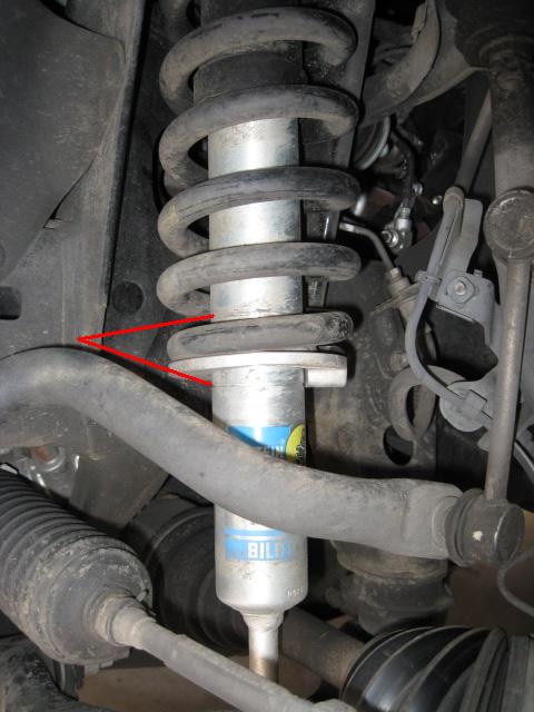

My 2007 Limited V8 measurements are with 265/60/R18 with the front 5100 setting on the 2nd ring from the bottom, 5100 in the rear, and zero pressure in the Firestone Ride Rite rear air sacks:
Front Driver's: 34 Tire gap 4 1/2"
Front Passenger's: 34 1/8 Tire Gap 5"
Rear Driver's: 35 Tire gap 6"
Rear Passenger's: 35 5/8 Tire Gap 6 3/8"
The difference between the driver and passenger side heights are likely due to the gas tank being full as it is located on the driver side.

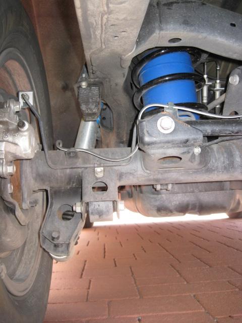

All, did anyone else have trouble installing the 2 new bushings on each of the top mount of the shock which came with the rear 5100s? I had to use one new and one old on each of the shocks. Also, if anyone else is planning on doing this mod I recommend getting the new Bilstein 5160 with remote reservoir, but it is about $100 more. I'm pissed it just came out a few months after I installed the 5100s.
17.jpg~original
Thanks.
Yes, I agree with jtanner do (1) Install the rear bilstein 5100, before moving onto 2 or 3. It's your decision on the function on whether you want a more lifted look (2) or an even look (3). For me, it was just to give a more even look. I even think my T4R probably goes unnoticed that it was lifted and that it has the SpiderTrax spacers. I'll post pics soon.
Interesting. Is yours a 2wd or v6 by chance? If so, that could explain the extra lift. I'm about to get a set of these (well, I'll look into the 5160's now) and also combine them with FJ springs so I'm trying to get a feel of numbers and if you're actually getting what they state you'll get.
Thanks for all the feedback and advice....
yes, I adjusted my headlights lower....
I am looking forward to pics and will post mine once all is done to satisfaction.

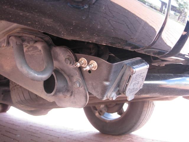

Here are my pics of after the Bilstein 5100 and Firestone Ride Rite install and 4500+ miles. The front is spring perch is set on the 2nd ring from the bottom. You can see from the picture that the top and bottom lines are visible - the 2 middle rings are covered by the spring perch. The air sacks are suppose to have a minimum of 5psi but I leave it at 0 because the rear ends up feeling too springy when unloaded. I installed the air valves on the towing socket bracket.

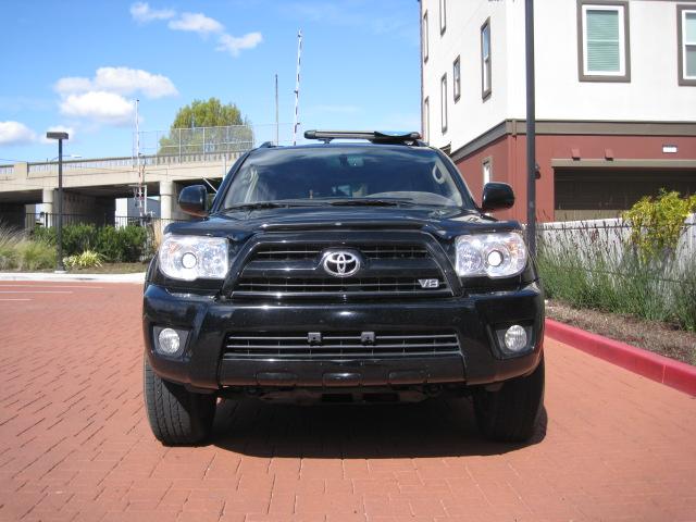

All Done
Here it is...all done....I am happy how it looks and drives now....Thanks to all for feedback.
Measurements:
Driver Front: 36.5"
Driver Rear: 37.75"
Pax Front: 36.9"
Pax Rear: 38.25"
