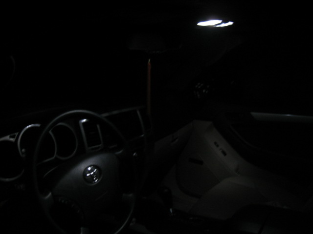

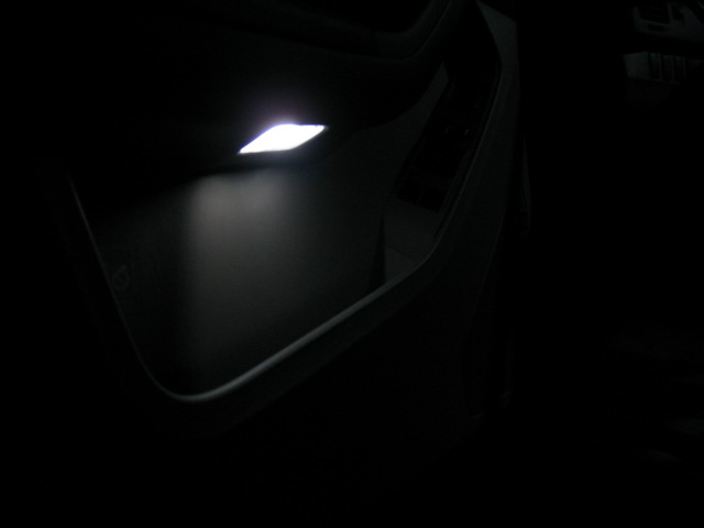

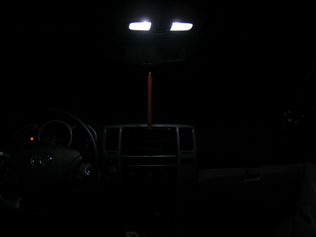

Sorry, forgot to finish writing on that last one...
so, I went fishing on ebay for the 194/168 bulbs which satisfy all but the dome lights. They look amazing. The brand is Aidlite. They are made in Japan, lifetime warranty. 5 pair for $10 plus $5 shipping. This isn't too bad! I'm still searching for the dome lights, DE3175, from the same manufacturer. I'll update if I find anything.. here are some more pics.
last one... I thought I would go out to the garage and capture how amazing these look w/ this new dig. camera, but I guess our eyes are still better technology then cameras, cause it looks ALOT better in person!

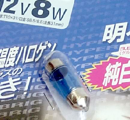

If you found where to buy the DE3175 for the dome light, let me know. I came to several local stores but I couldn't find the right xeno bulb for the dome light.
The stock bulb for the dome light is 12V 8W, and found one online. I think it is the same size as the stock bulb.
