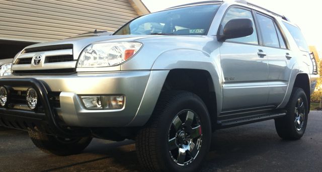

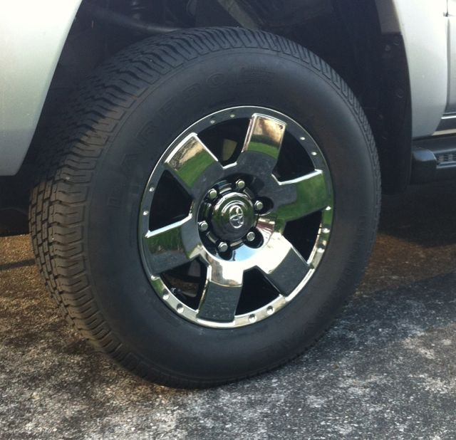

Finally got my FJ Wheels back from powder coating and put em on the T4R.
These are now one of a kind :frog:
I had them cleaned and then thru a three coat process:
- Powder Primer
- Black Chrome PVD
- Acrylic Clear Powder
This is the same process used by some OEM's for high end aluminum wheels. I'll keep these as my summer wheels and have the OEM T4R wheels off to get powder coated with a two coat process:
- Hybrid Powder Primer
- Black Lava Texture Powder
This system was just approved by Chrysler for some limited edition programs. I'll wrap those rims with BFG AT KO and use them for my winter wheels.
