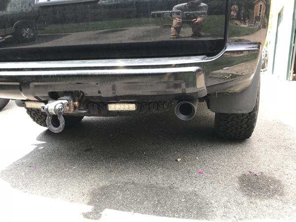

This is how it looks:

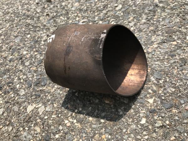

This is what has to be cut:
No issues with melted bumper skins or vibration with it touching the bumper?
The tip does not touch the plastic, there is just enough room. The tip also is multi part/section: it has an inner perforated section and then an outer steel part, it is not just a simple sleeve. (As seen in the second photo of Cobalt Anubis' post: http://www.toyota-4runner.org/2992466-post12.html )The design may contribute to cooler surface temperatures.
