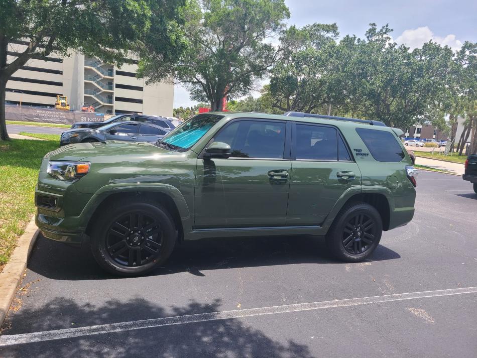

Quick question. Anyone have Black Rhino Armory wheels? I currently have an Army Green TRD sport with tone stock 20” wheels that i had powder coated. I wanted the wheels more flush with the fenders. Wheel spacers arent an option at the moment, so I’m looking at other wheels. Like the Armory, and possibly the Arsenal. Anyon rocking these in 20”? Will these wheel widen the stance? And, would I be able to use my stock wheels? Thanks.

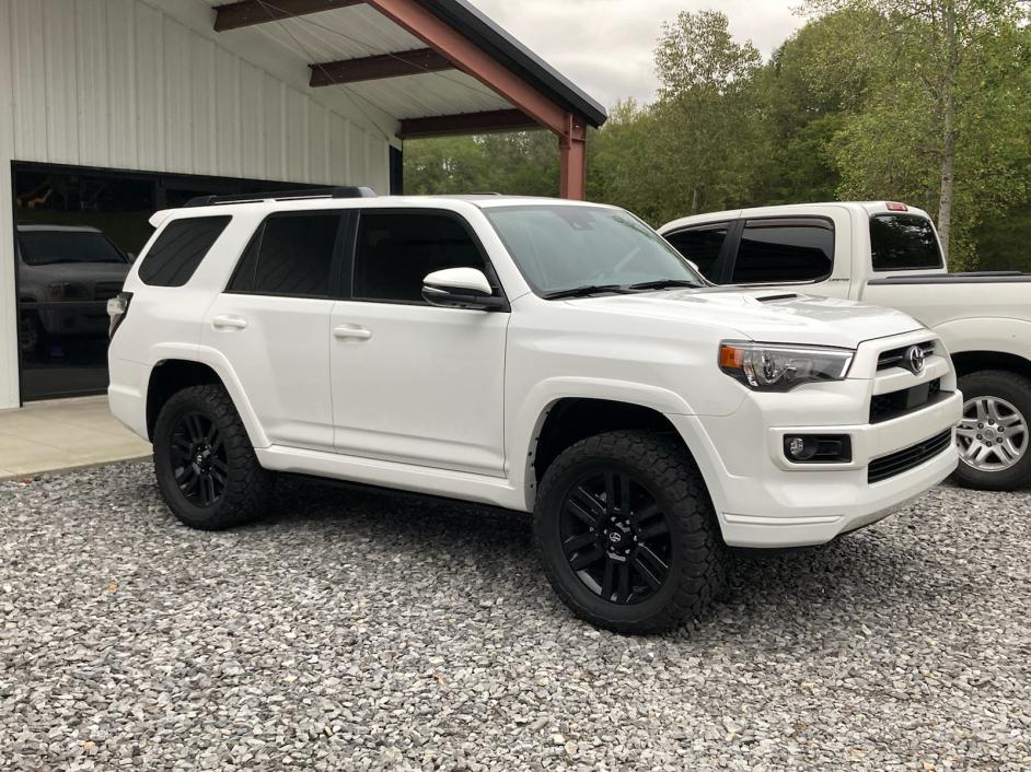

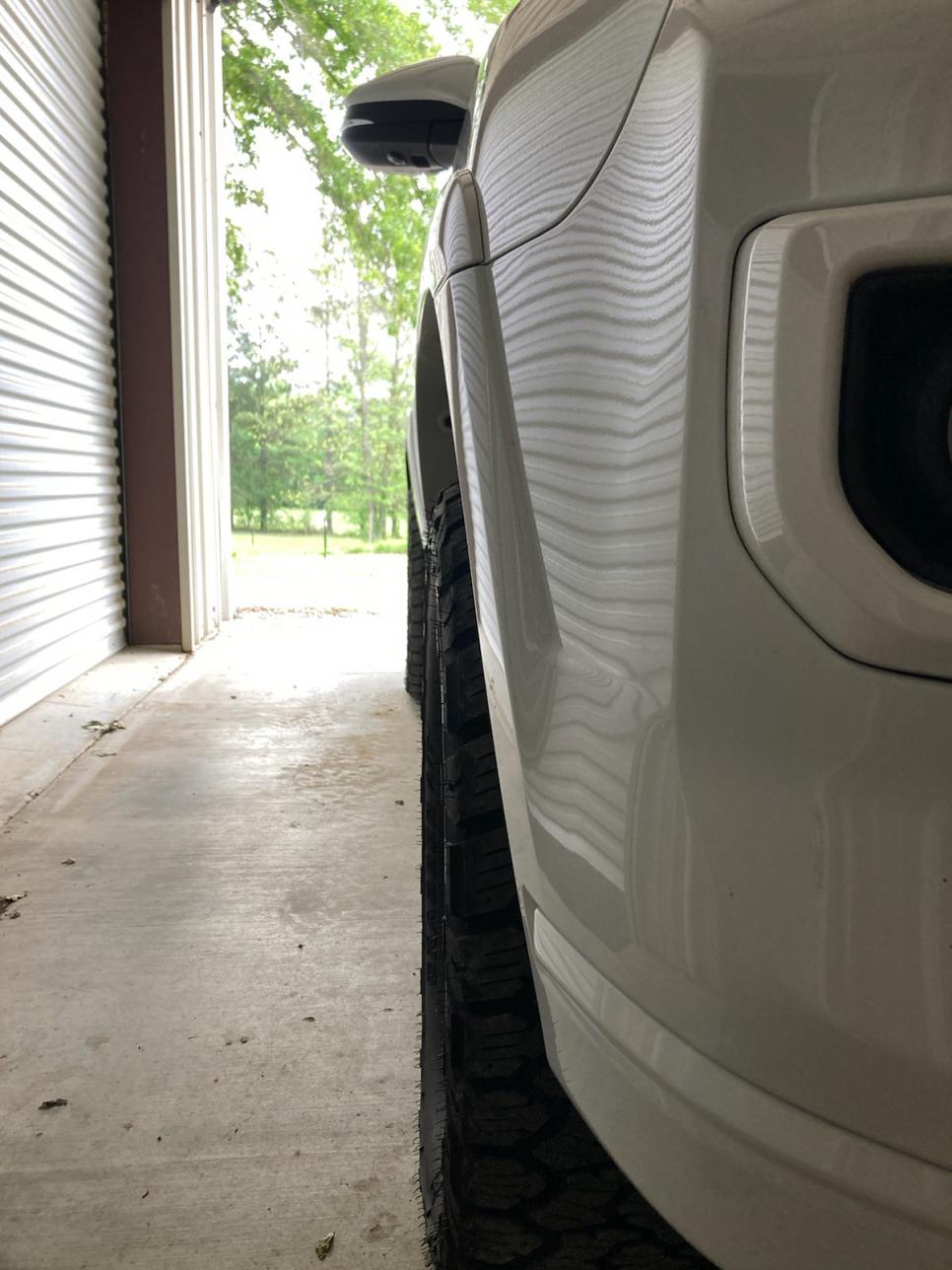

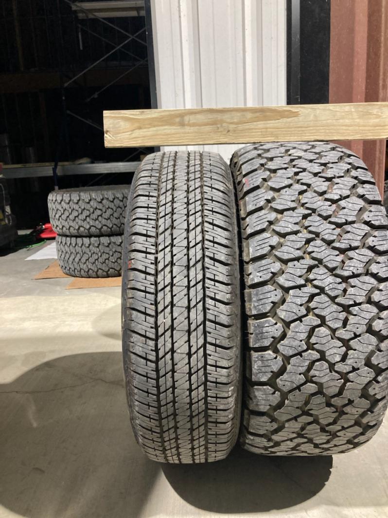

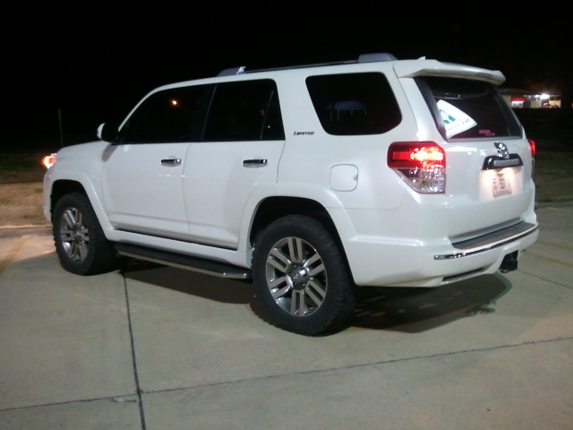

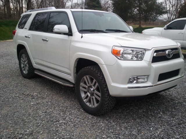

I have owned 275/55-20 and 285/55-20 and 305/55-20 on the 20" limited wheels, Just do a lift up front to clear them and rock out. Personally i prefer the 305/50-20 General AT/X over everything else, they fit so amazing with a 2.5" lift up front and 1" in the back. They fit, clear, dont rub, and look great. I have had them on both of my 5th gens. These will basically sit the outside of the tire flush with the front and rear fender flares, with no spacers.
The 285/55-20 will almost sit flush with the fender flares with no spacers.
Last picture is the 305/50-20 General AT/X on stock limited wheels powder coated black. 2.5" lift, no wheel spacers, tires are practically flush with the fender flares.
