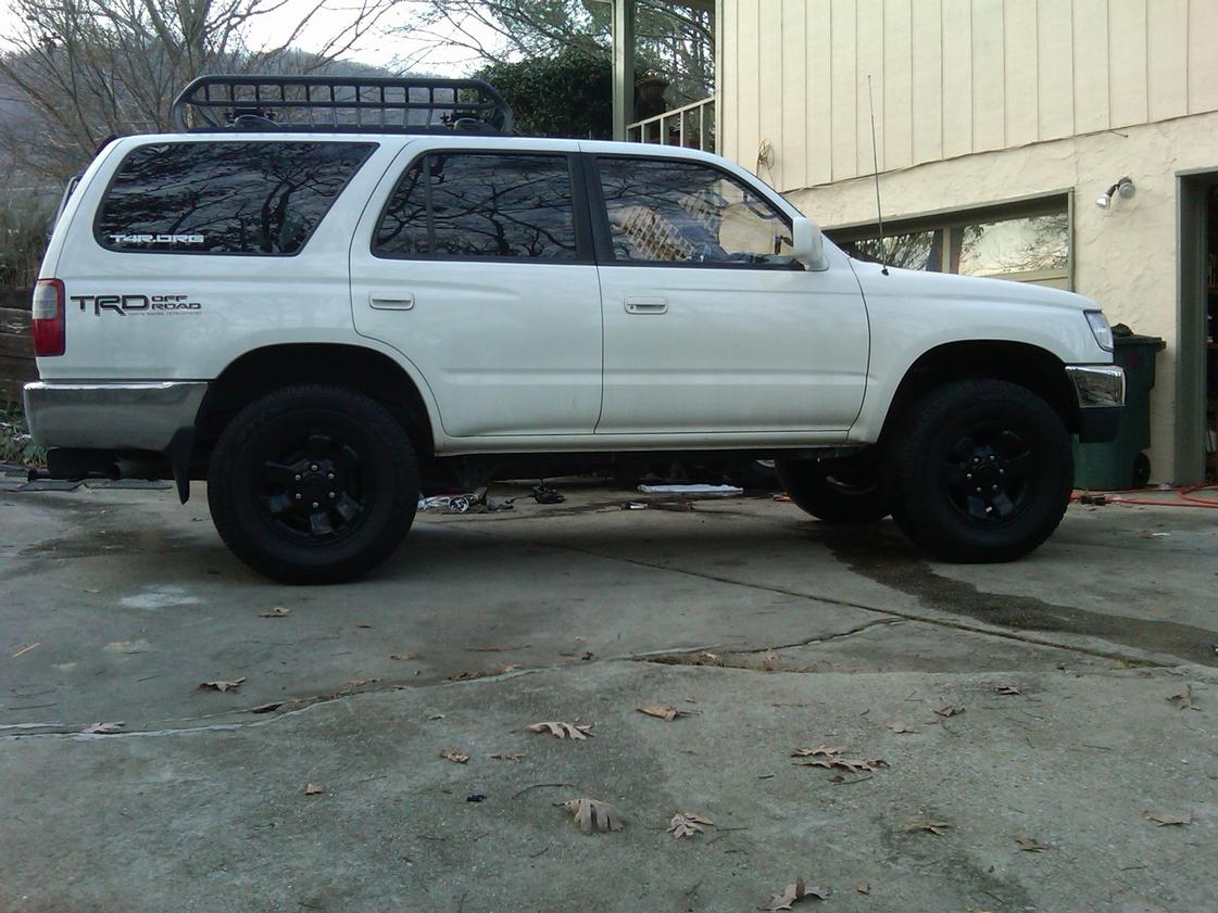

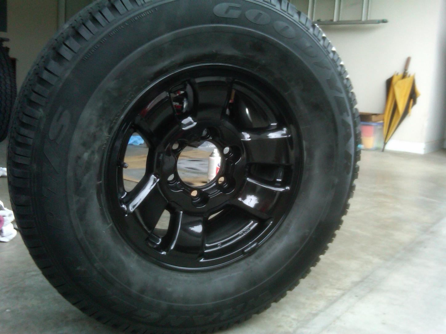

Paint em black!
Paint them black! I used Rust-o-leum flat black high heat engine enamel for mine. Been that way for 7 months, no chipping, nothing! Look brand new when I clean them up.
Key is to clean them good, sand them, primer and paint multiple layers and you won't have problems! I'm a flat black kinda guy so I'd high recommend it. Check out my build thread for pics.
