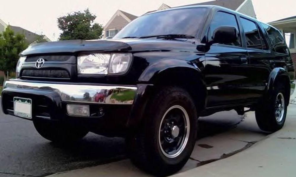

I like the look of black wheels, and the silver thing is getting just too old :cool:
I still think I'm going to plasti-dip them because it removes so easily, and then I could just sell them as stock when the time comes
Gunmetal! (Graphite, technically....)
They were a little dirty for the picture, the paint job is clean...except the spot on the rim from mounting the tire, which I touched up later.
How dare you guys have a different opinion! Lol. J/K. I love my black wheels, but could totally see how people might be getting tired of the look.
Your rims look awesome black. I think gray and white 4runners look good with black rims, depending on the rim. I was gonna paint mine black, but that would just be a little too much on a black body. I honestly like the look of the flat allow rims on mine. But come warmer temperatures this spring, my rims are going gunmetal.

Meh, I don't know about selling the stockers and putting towards new ones. They don't sell for much. Plus I think both the stock 4runner wheels look pretty darn good painted black or gunmetal.
I wouldn't go glossy if I were you, I think it would clash with the flat black of the plastic fender flares and running boards. I'd go with a nice flat black or that bedliner, it would blend with the rest better IMO. Glossy looks good on Xideshows cuz its chrome and white with no black bits to throw it off.

Scuff well with red Scotch-Brite, degrease with paint thinner, 3 or 4 coats Duplicolor Self-Etching Primer, 3 or 4 coats Duplicolor Sandable primer, some touch-up sanding/degreasing, then 4 coats Duplicolor Graphite Wheel Paint, 3 coats Duplicolor Wheel Clearcoat. Sounds like a lot of coats, but drying time is 2-10 minutes between coats, and 30 min. or so between types of paint. I just used a cooking timer while I was doing something else more involved that I could stop every few minutes.
I went with the acid-etch primer because I had to scuff down to bare metal in a few places on each wheel. I did mine with tire off because I was going to new tires so I had to do minor touch up after mounting. Wait a week before touching up or it runs. Paint still looks good now after 5 months and some winter and a few washes. Mine were lightly curb rashed and clear coat was nasty over maybe 40%. Before pic:
