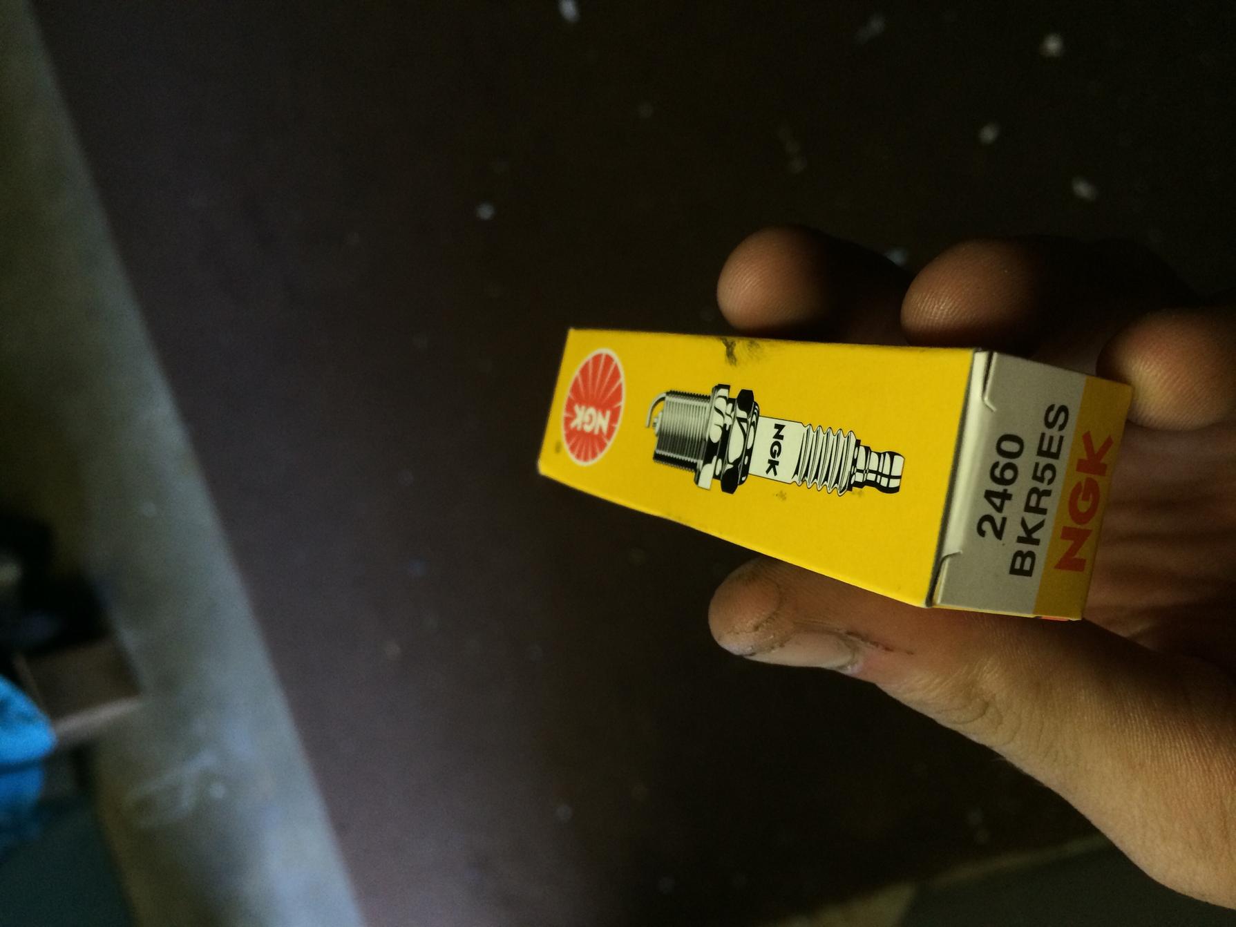

Yes Iv checked the spark plug wires and made sure they weren't crossed, millions of times
And bwd wires, the other ones did not work and spark plugs I used ngk the basic ones
No they aren't v-power
There NGK basic and the number is 2560 and BKR5ES
And how can a bad tps cause black smoke?
