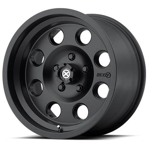

How about an alloy that has the steelie "utilitarian look" you seek? ATX Mojave comes to mind......there are probably others too.
Mmmm yeah. I could dig those.
