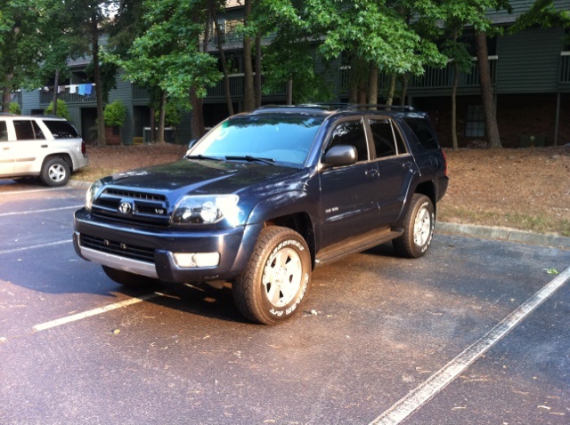

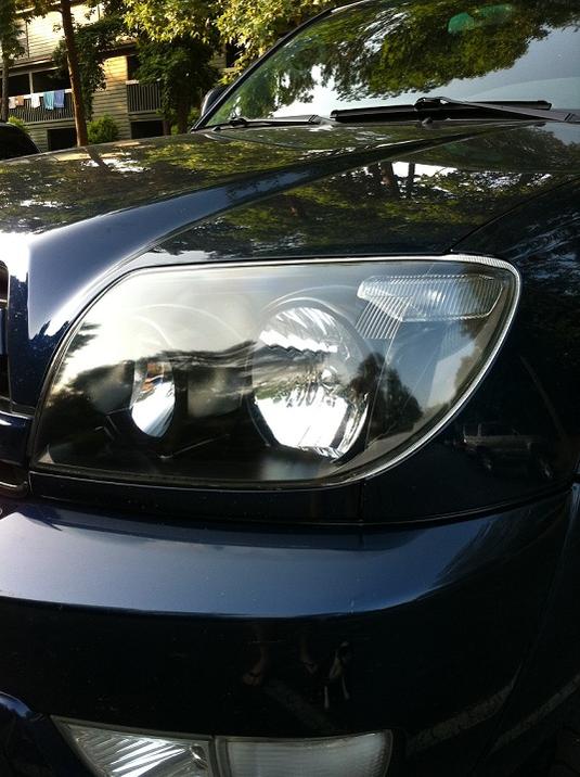

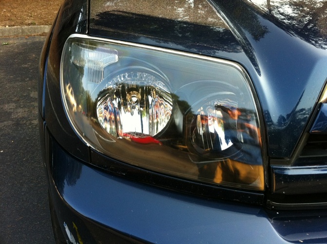

So while I was in Lowes today it hit me that I've been meaning to do this for a while. Since I had the day off I figured why not. I got a can of Valspar plastic paint semi-gloss, no primer needed, and gathered up some tools and got started.
Tools required: 10mm socket, ratchet, screwdriver

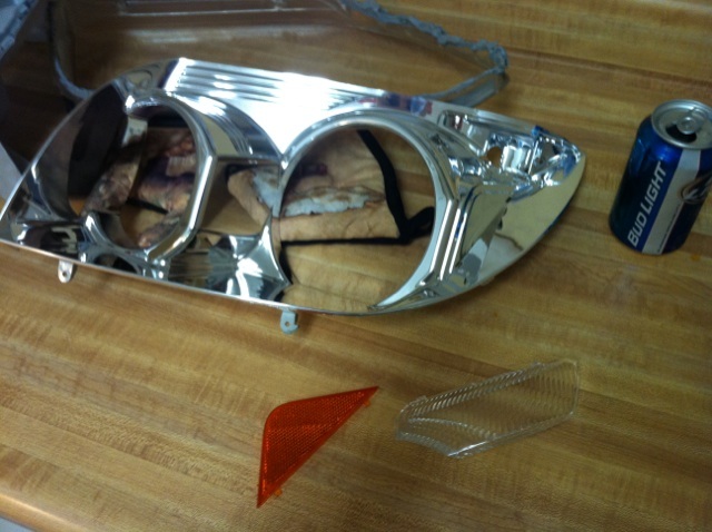

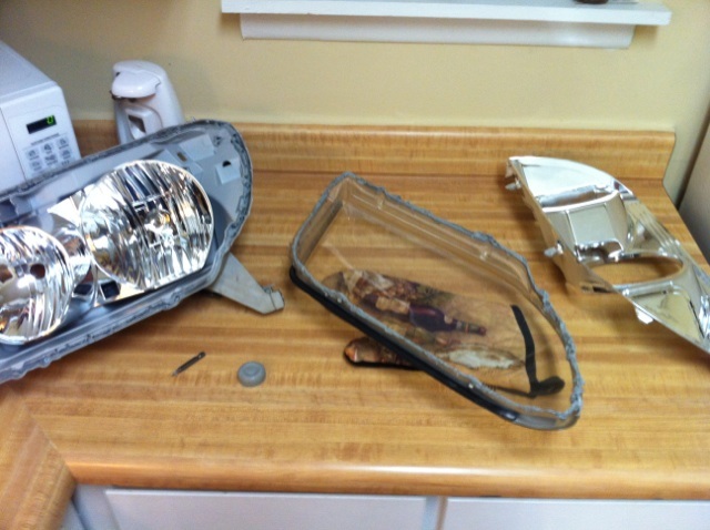

I followed the instructions exactly as I read from other member's posts and overall it was pretty easy. I used a 10mm socket to get to the 4th bolt in the headlights everybody says is a PITA. I had to remove it from under the bumper. Removing the 3-4 bolts in the lower part of the fender liner helped. I was also able to get them back in pretty easily.

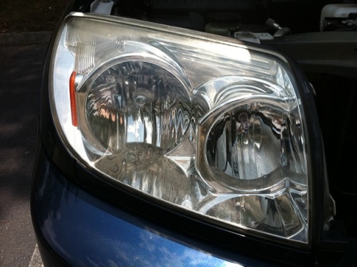

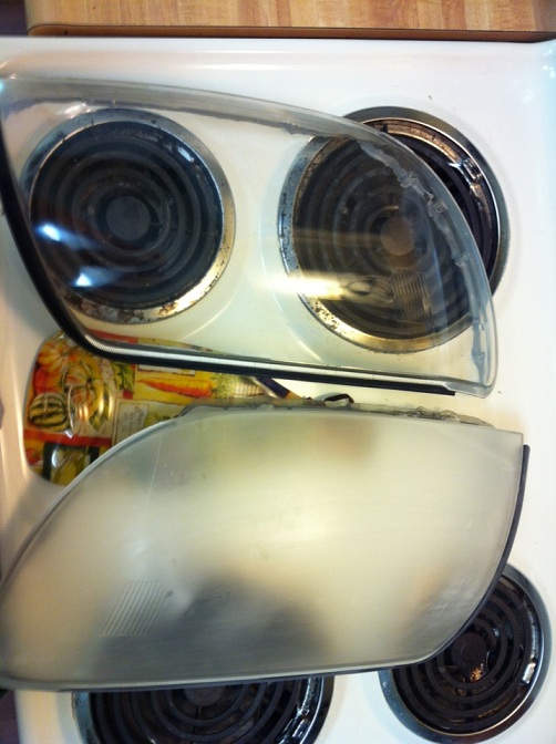

While I had my headlights out, I started to notice how oxidized they looked so I did some research and bought CV headlight restoration kit after reading a ton of good reviews. Stuff is serious business, incredible job.

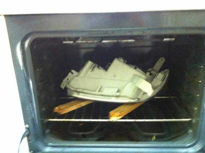

The whole job took about 4 hours but most of it was waiting for paint to dry or lights to cook. I used 4 coats of the Valspar black paint with light coats in the first 2. The headlights I baked in the oven at 250 degrees for about 10 mins. They came apart pretty easily just gotta take your time. I left the orange reflectors off cause I liked the look better without it.
Here's a few pics I took. Not really a instruction manual but just a few so you can get the idea. The DIY guides from other members pretty much cover everything.

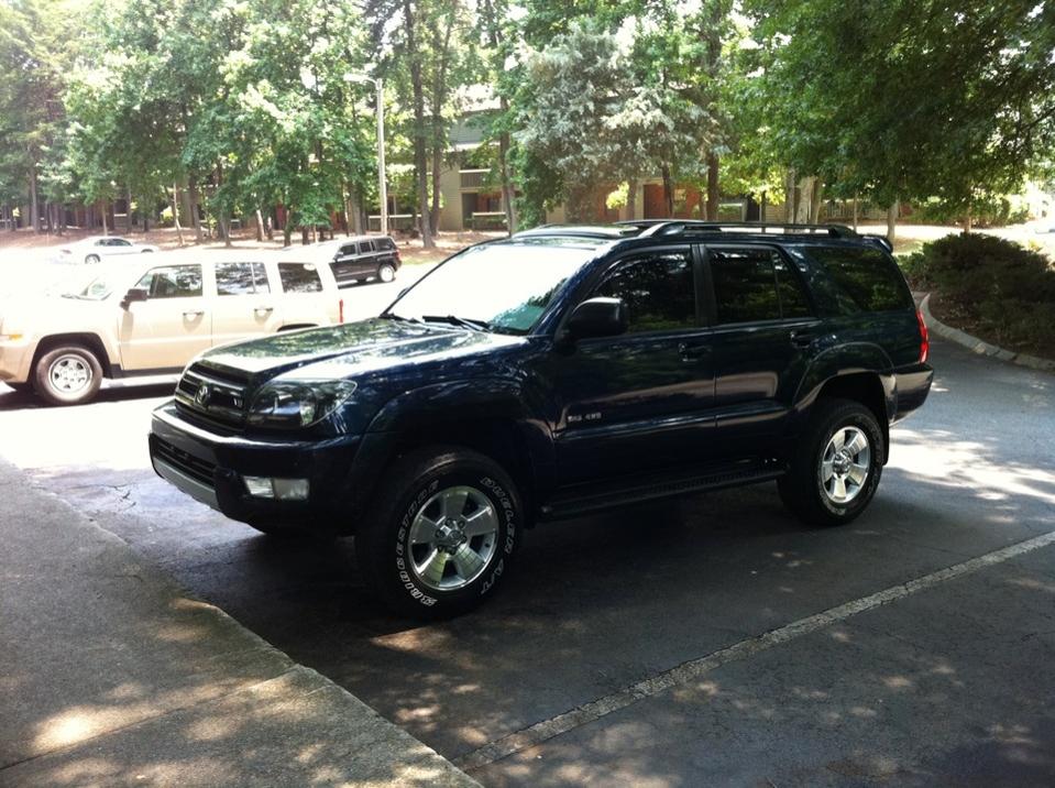

Awesome, not sure I've seen the black headlights on a blue 4Runner yet, been waiting on it.
I think it'd look even better if you did the turns/fogs.

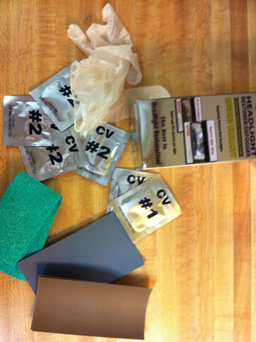

Well with that said I will admit my first attempt with this stuff didnt go very well either. This was my 2nd time working with this amazing stuff. I had always been very skeptical about "sanding" my headlights. I would have never thought the outcome would have looked so good. I read a lot of reviews on headlight restoration products and it seems CV is the best (i've tried 3M and turtlewax, no compare). It comes with a hardner that will seal the headlights for a long lasting finish. I'll take a $19 box of this stuff anyday before I spend $200 on new ones.
The first few steps are pretty simple: Sand, sand, polish, wipe clean etc. The hard part is the CV#2. That stuff has the consistency of water but dries almost instantly. The trick is that you can't touch it once it starts to dry. If you "over wipe" the lens you will ruin it. You pretty much make 1-2 passes over the whole lens and then leave it alone and wait for the 2nd coat.
Doesn't take that long from start to finish, 20 minutes maybe.

Looks very good!! Awesome job. Just watch out for the reflector (amber), there could be a law (state or otherwise) that requires them on........ not sure though.
Your truck looks sick man. Love the blacked out head lights. I can't wait to do my HID/projector retro this summer...might have to black out the head lights while I'm at it.
Now you need to plasti-dip that silver bumber peice to make it match the headlights.
I'm going to finish up the fogs/turns this weekend when I'm off work.

Question, anyone have issues w/ leaving the amber reflector off? It seams that some people break it off, others it comes out fine. I'd rather just do w/out it, but don't want to have an issue w/ the 5-0.
Little thread re-vival.
youll be fine removing it and having an amber bulb
