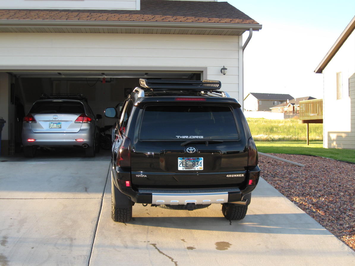

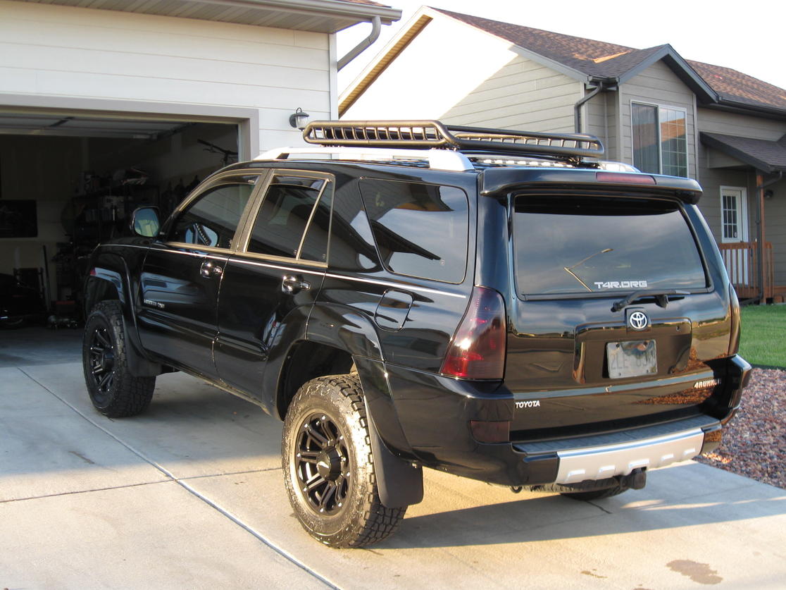

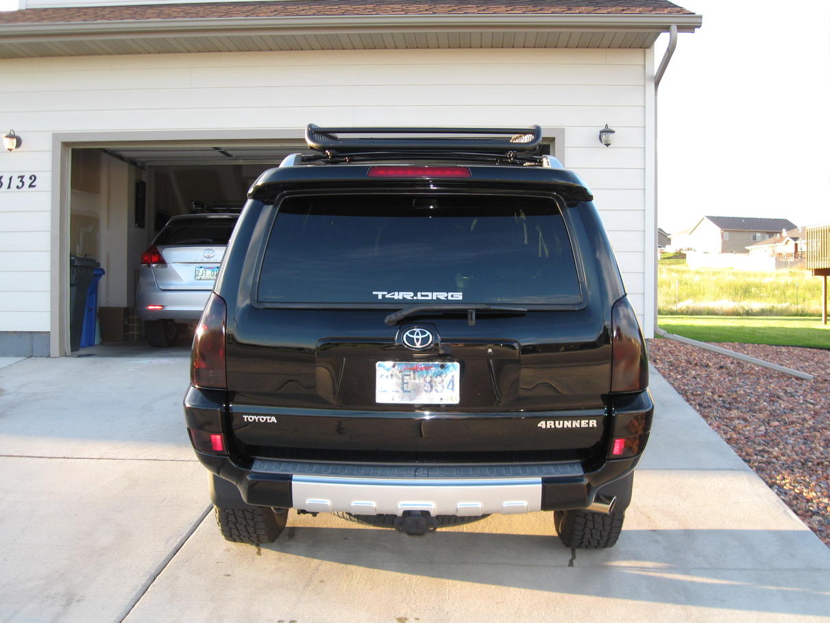

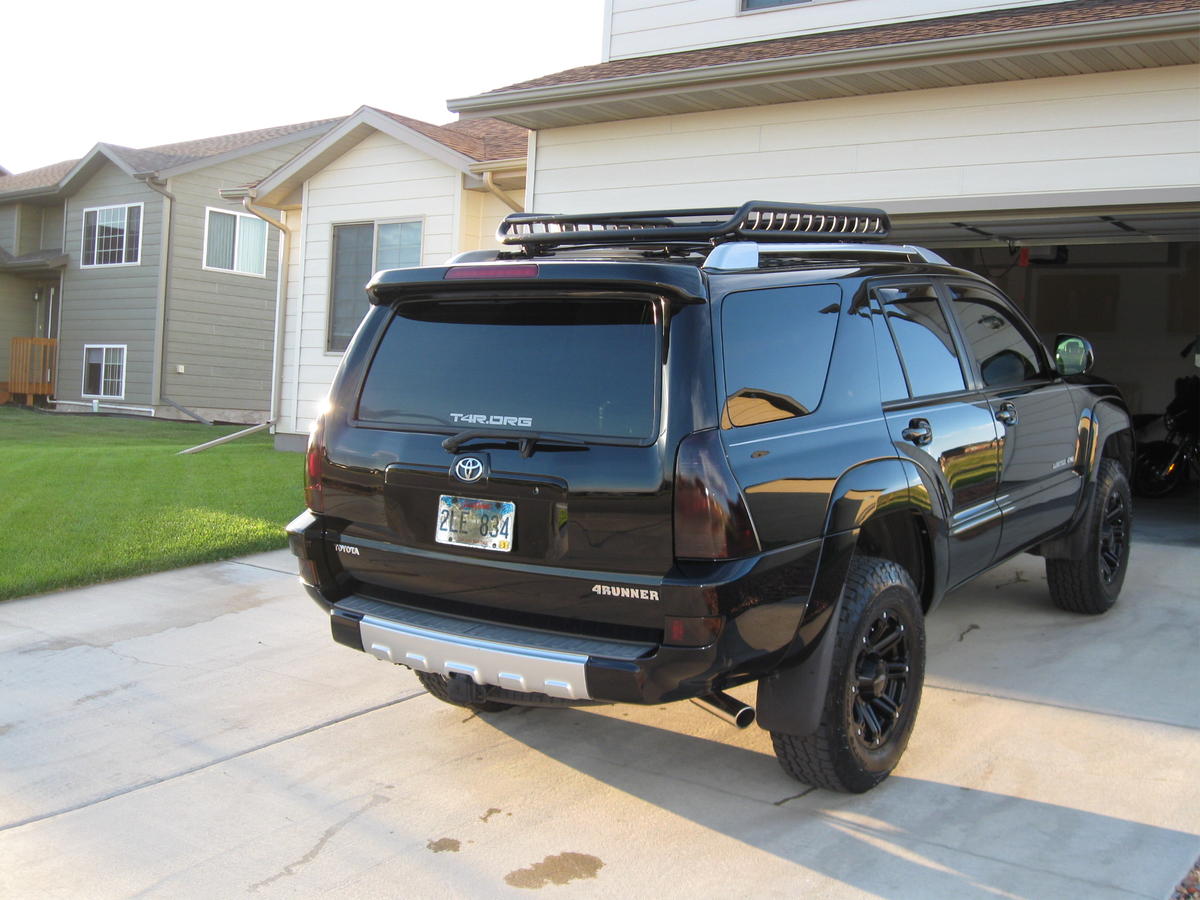

There is a small square access panel on both sides open it up and there is 2 10mm nuts per light and they pop right out. I did mine last week I used VHT nightshades and scuff between each coat then did a few coats of clear over it scuffing between coats as well I used the red scotch bright scuff pads. Also depending how dark you go and the angle of the vehicle and light sometimes one light looks darker then the other as you can see in one of my pictures
How many dark coats of the Nightshades did you do? And where they light or thick coats?

I had done this a year or two ago before I removed it - if you have an 03-05, the pink lights will turn a nice reddish about 2 coats in. I've done 3, and any more than 3 (including 3 depending on how heavy the coats are) starts to look ricey and becomes a safety issue, especially without LED lights as they become too dim.
If you paint using the NightShade and want to do it properly - add a final light coat ontop of your original amount; if you want the look of 2, do 2 coats and one light coat, so that you can sand it with 2000 grit and polish it out for a perfect finish. This will remove some of the paint and thus why it's recommended to add a little bit more.
If you don't polish the lights after adding the paint, they look pretty bad. 2 coats + a polish/compound looks like the factory 2006 lights, without the LEDs.
