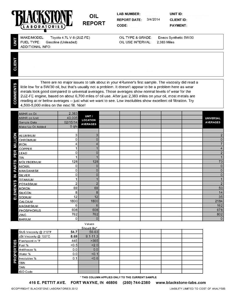

What do you guys think of these results? This is my first oil analysis so I am not sure what I am looking at. Is the aluminum content too high?
I had 2 x FilterMag RA300 magnets on my oil filter too.

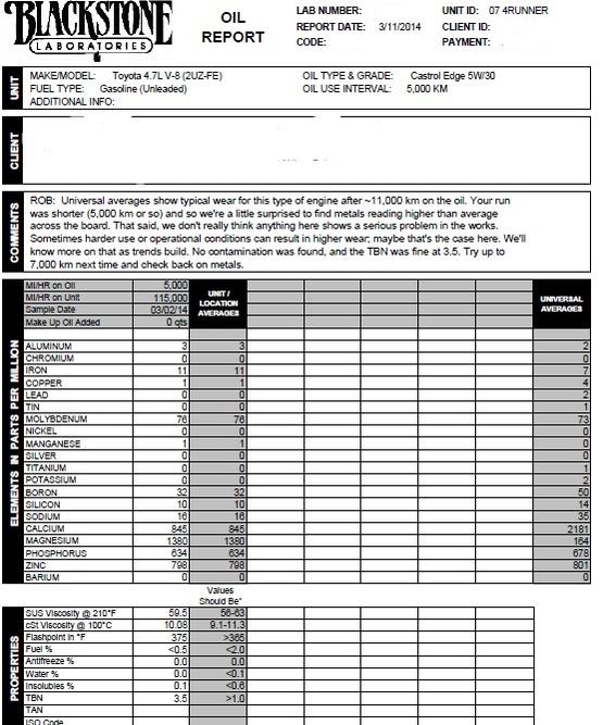

My aluminium content was 3 after 10 000km on Castrol Edge 5-30W. If I could figure out how to hide my email and phone number I would post my report as well.
Looks very good. Remember that the biggest advantage of a UOA is to develop a trend for your oil, engine and usage. I would extend it to 5K, I think it would be perfect. Why didn't they give you the TBN #?
