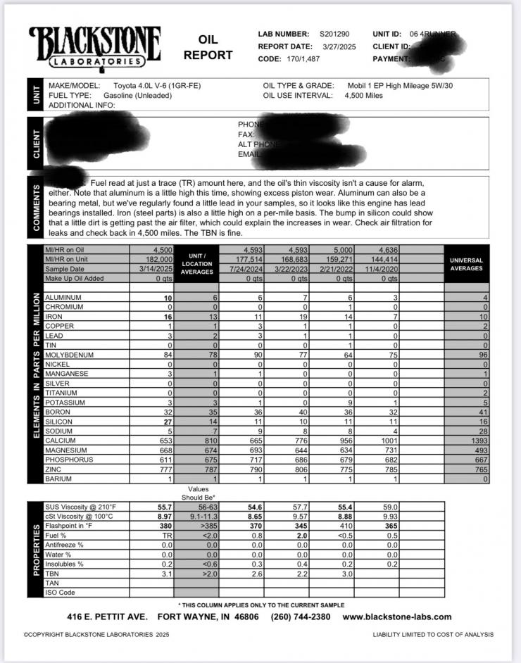

I am beginning to become concerned over my oil analysis results and wanted to see if anyone can provide any input or suggestions. My engine has had oil changes done meticulously from new.

Take their advice and check your air filtration system. What air cleaner do you use? Check the entire system for a possible leak.
My UOAs showed high wear metals with Mobil 1.
I switched to Quaker State Full Synthetic 5w/30 and wear metals gradually decreased. As of the 3rd UOA with QS FS 5w/30, my wear metals are now lower than average. Toyota Oil Filter.

I bought it without knowing what oil was used. I used Pennzoil Ultra Platinum and Mobil 1 and both oils showed high wear metals. I started getting concerned thinking the previous owner neglected it. Then someone recommended Quaker State Full Synthetic. I was skeptical at first, but the results gradually improved and now I'm getting good results.

I've been using M1 0w40 FS for years with great analysis results in the 4.7. It's a low weight 40 and generally shears down a little. As others have said, double check your air intake, something may be loose or ???
