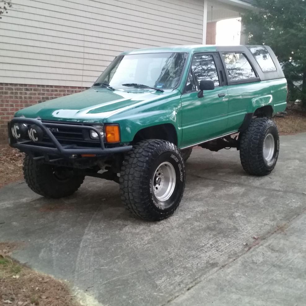

Pic of the truck as she sits now.

Sweet! I been thinking about doing the same to my 4runner. But I need to finish up the pickup before I get to the 4runner. I plan on running 35s with my truck and coilovers. I might do the blazeland DIY kit since I got all the tools to do it. Looking forward to seeing your progress. Keep us updated.

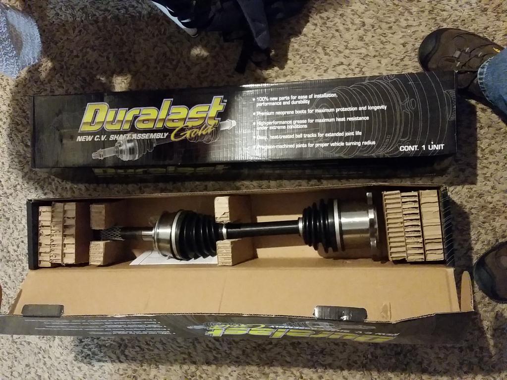

CV Axles came in today.

It looks like you have a super clean 1st gen! Nice build man!

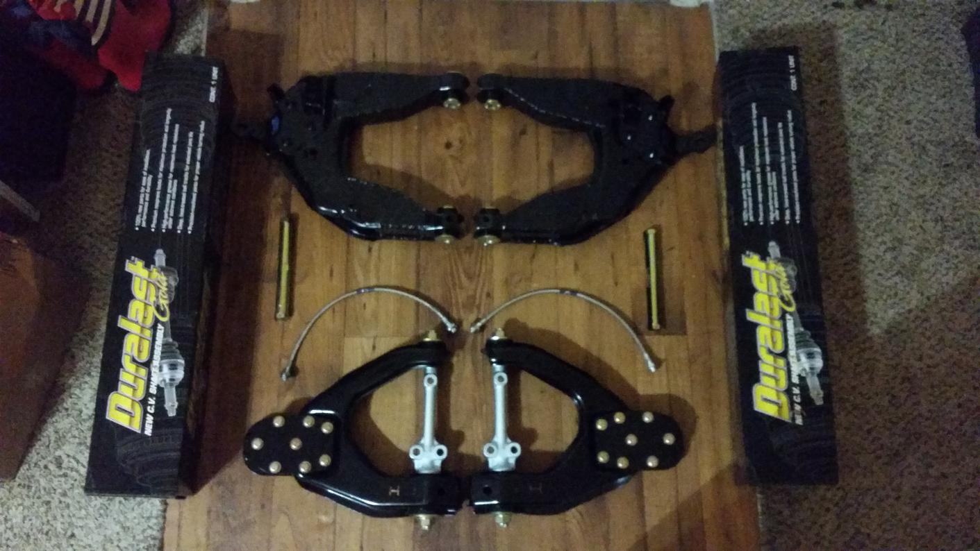

The Blazeland kit came in the mail yesterday. I had planned on doing the install this weekend, but found something that may cause delays unless i can get it sorted out today. I have two alignment cams that are completely seized. There is a guy local to me who says he may have a couple that he can spare, don't know what he wants for them but i hope i can get them today.
Looks like I can buy them from Summit and Jegs for about $35 per cam bolt. That's a bit more than i want to pay for what is essentially a bolt with a flat section machined into it.
Found out two of my alignment cams were seized a couple of days ago. Managed to get ahold of a local guy who had some parts trucks he let me raid for a price. Thank god for parts trucks. Anywho, moving forward with the install this weekend. Just a shot of everything together
