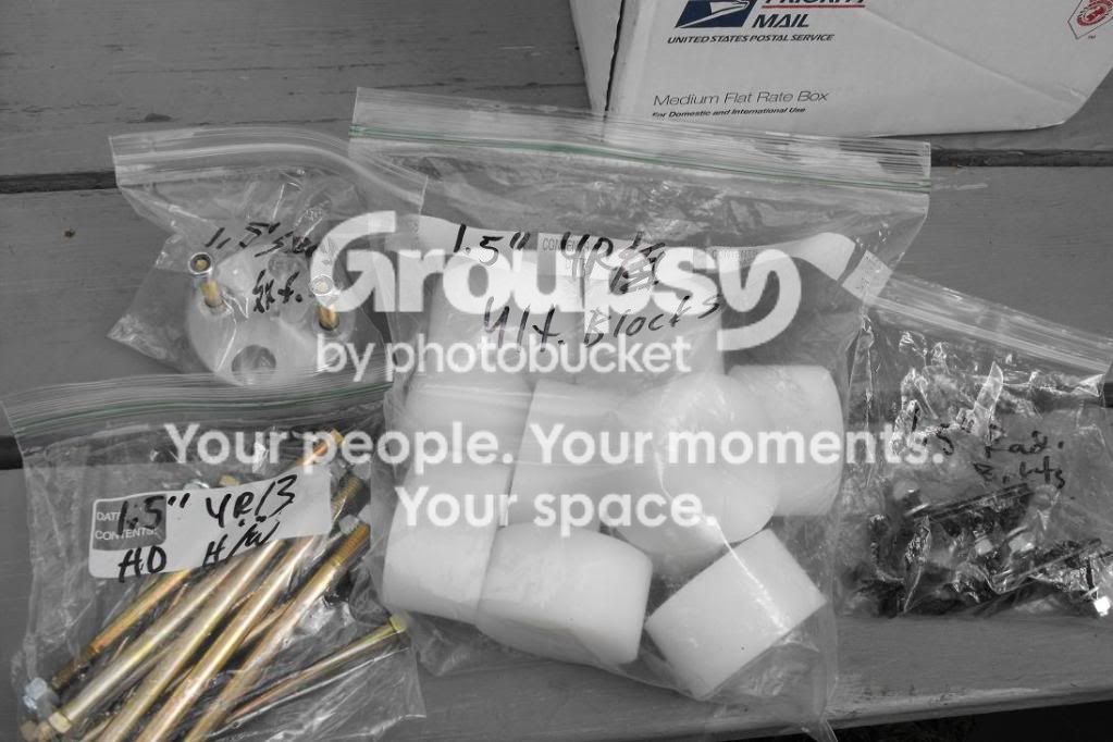

With the wider 305's, I was rubbing ever so slightly at full turn flexed, so I ordered a 1.5" BL kit with HD hardware from Roger Brown and replaced my 1" ones..it was just what I needed to eliminate the rubbing.

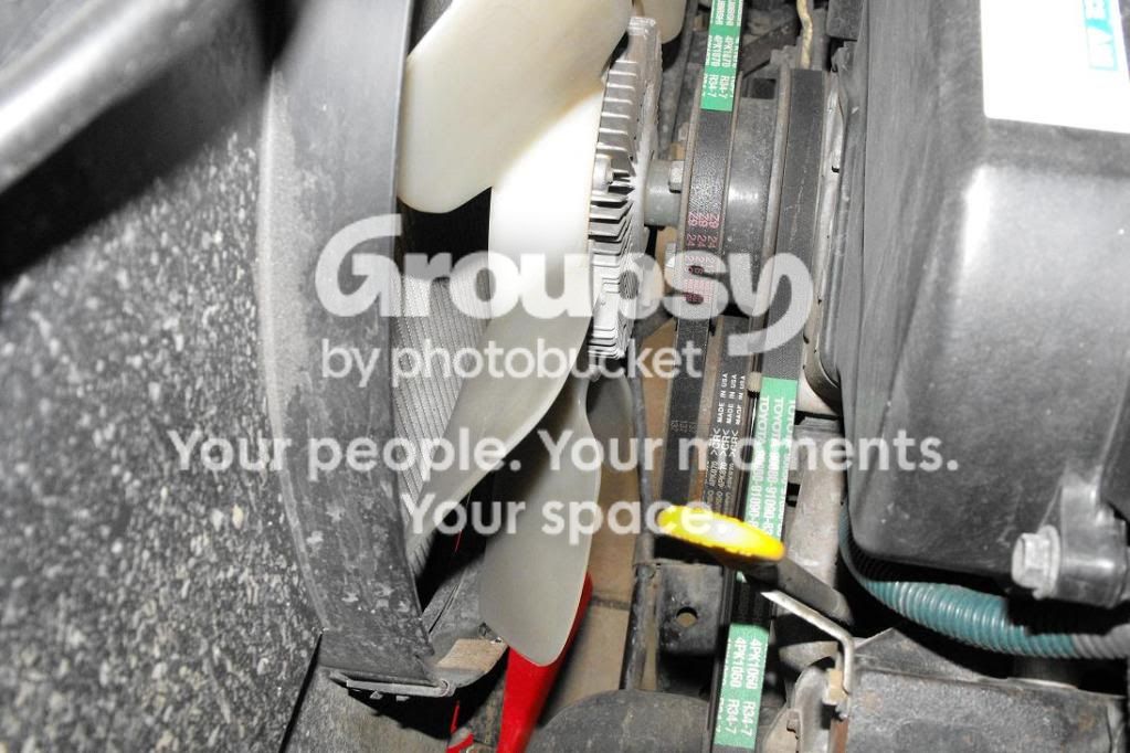

Install went just as easily but with the exception of the radiator fan hitting the bottom portion of the fan shroud..I chose to lower the radiator for the purposes of maintaining it's cooling efficiency with the fan centered within the shroud----so I read:boxer:. I could've gone and just took the bottom shroud off and be done with it, but I had plenty time...tik tok.
Smoker.gif~original
Oh was I ever lucky I didn't start the engine and head off before realizing the fan was stuck without any chance of rotating.:bravo: So Bodylifters be aware!!

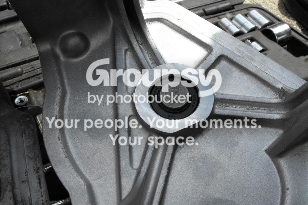

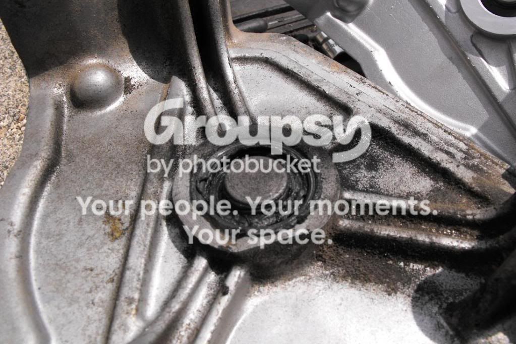

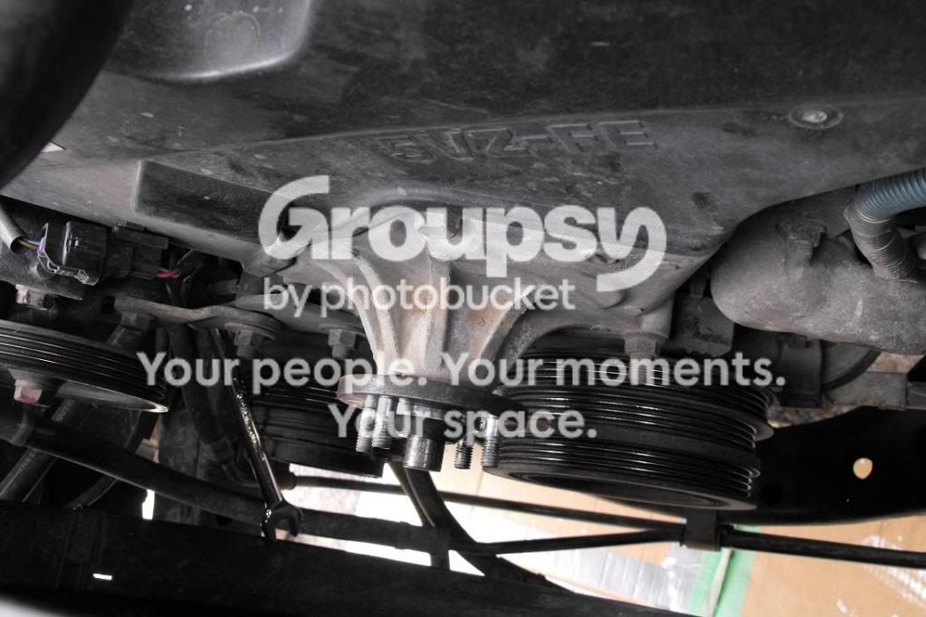

When I asked my friend to help me change the waterpump and all the belts awhile back, he noticed that the Fan Pulley Mounting Brackets bearing was grinding and making some whirring sounds. We just re-greased it at the time 'til I can replace it with a new one.
But I knew it was just a matter of time before the grease dried & the bearings seized and the threat of an overheated engine would be imminent. I got some Aisin brand one and spared no time to install it.
the stock "fake water pump"

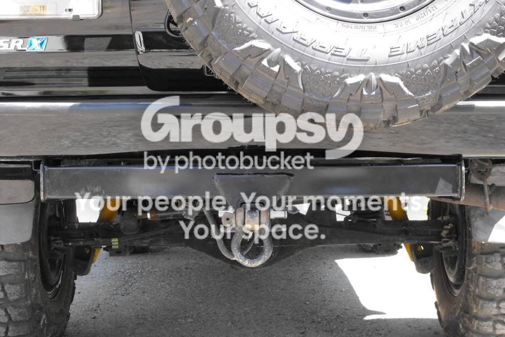

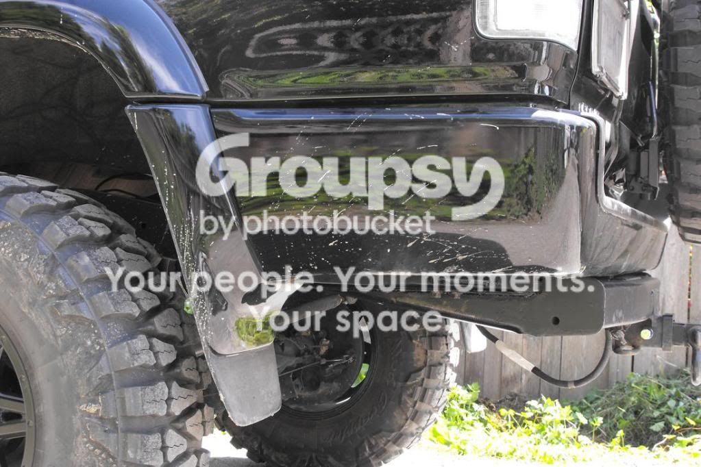

.....and lastly, to those who still have their trailer hitch but dreads the gapped look created by the Bodylift well, too bad! jk! jk!:biggrin2:
Here's what I did to put the hitch back up to stock form..
6-3.jpg~original
7-4.jpg~original
9-1.jpg~original

From underneath the truck with the hacked up hitch?, probably with a little more modification, if that's what you were asking....But that's the whole point of my having a tire carrier now, though!

Nice job on the hitch match... ive been wondering why n one has done this and now that i know it works for sure ill def be doing it since i hate the look of the gap. More pics or info if u could to clarify all the details

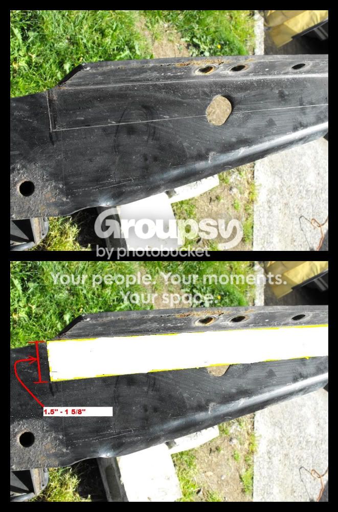

Thanks, I've been wanting to do this eversince the 1" BL I had, and now that the gap became more conspicuous with the 1.5" BL, I needed to do something about it since I want to retain the hitch.
Here's a collage photo of the original and the modified section removed from the hitch.
above..Pre-scored according to the height of the gap between the bumper and hitch + a little allowance
below..material taken out showing in blank.
6-31-1-1.jpg~original
I took away 1 5/8" of material across on both sides of the hitch to leave just a tiny gap between the under part of the bumper and the hitch itself...kinda like the original configuration.
I used an angle grinder to cut with. Once you've done that, all you'll have left is the flange or the flap that actually attaches the hitch to the frame and just re-weld.
Good luck buddy!
8-5.jpg~original
Figured that was all the steps but just wanted clarification... thnx for doing that. Getting my bl on later today so hopefully ill have some time with a friend to knock out all the welding that needs to be done on the ARB, rock sliders, and now the hitch.
You're welcome! Can't wait to see the truck lifted and with the added sliders too! Post some pics during and after all the install!
