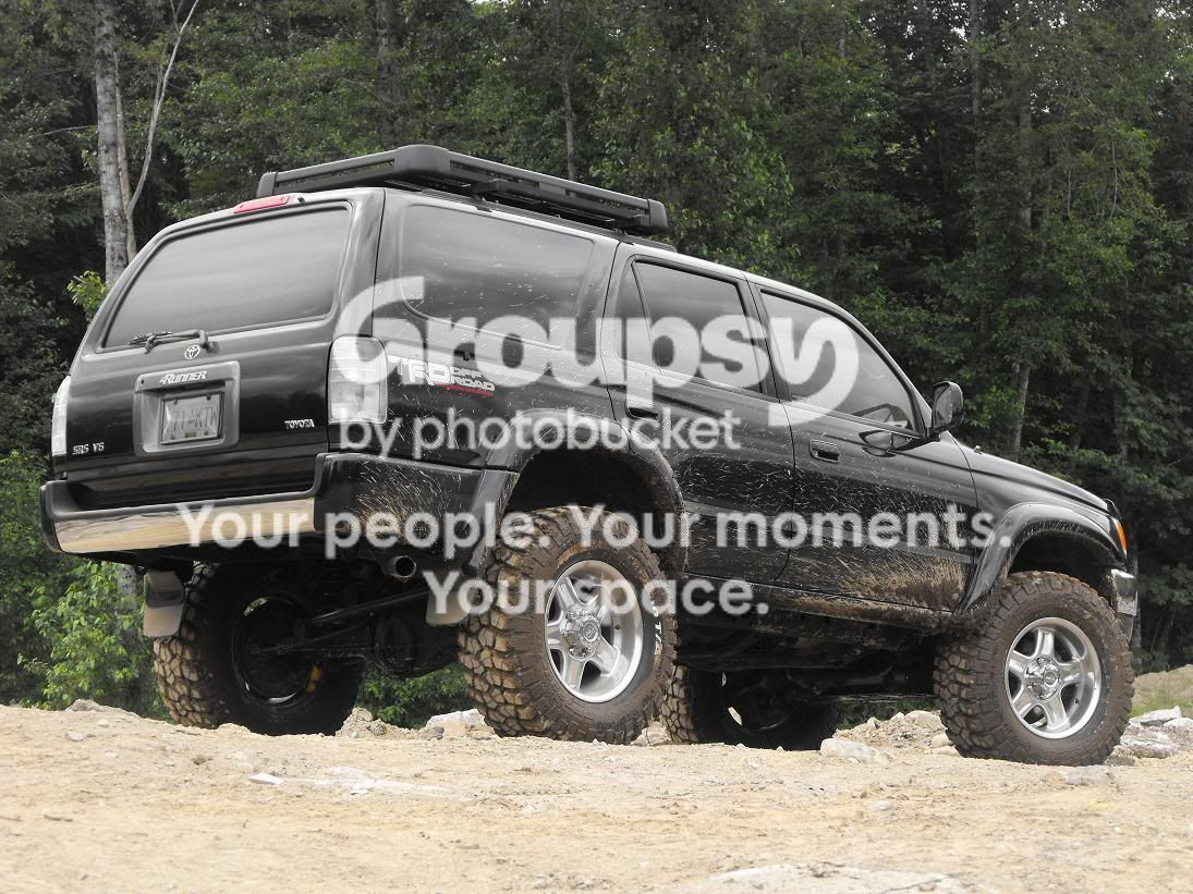

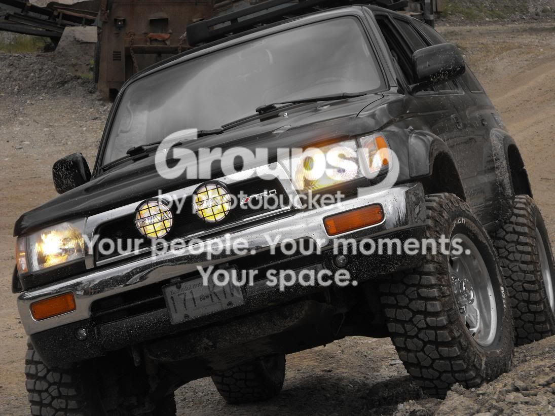

Just a little update...I have since added B&M tranny cooler, installed Rear Diff breather, replaced fuel filter, clear frosted tail lights, compustar 2-way alarm and starter, DVD deck and had a bit of an off road adventure...Big bump...

Very impressive;I'm partial to the job you did with the grill to fit the PIAAs flush which is a very nice detail and the lower valence came looks great.

Thanks Ron. I'm inclined towards doing minor custom works..after all we do want to set our trucks, if not by much from the rest, right?

Your rig is awesome! I love the look and all the little custom stuff you did....it's all very slick. I also like how you used cornfed spacers on top of the 890's in the rear, gives it a perfect rake!

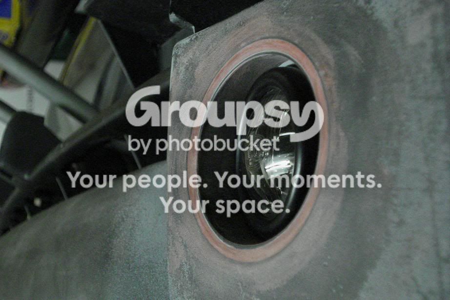

How did you make the foglight holes so clean? They look like they were moulded that way....but you had to have cut them.

I didn't want to end up having a leveled stance so having that 1.5" Cornfed in the rears gave me just the look I wanted. The ride isn't harsh or stiff at all.
As for the holes, I used a 2 1/4" hole saw, used some pvc pipes to make the housing and fiberglass, to mend it together, some bondo to finish it off. JB weld is another alternative to fiberglass.

I see a lot of 3rd gen owners seem to like a little rake in their stance. I find this funny as with every other vehicle it seems people want to take the rake out and have them leveled, hence all the leveling kits.
Is it that 4runner look better with some rake vs leveled?

I personally prefer 4runners with the rake over leveled stance, even under load the rear end won't look saggy. Alot of guys get the SS 1.2 kit and that has atleast 1-1.5" rake..It looks and performs good...again it's down to personal preference..

Like blcktpgsr said, a little rake looks aggressive, and when it's loaded it doesn't sag. For me, the bottom line is: if the rear end is saggy or even slightly lower EVER, it makes the truck looks old and neglected.
