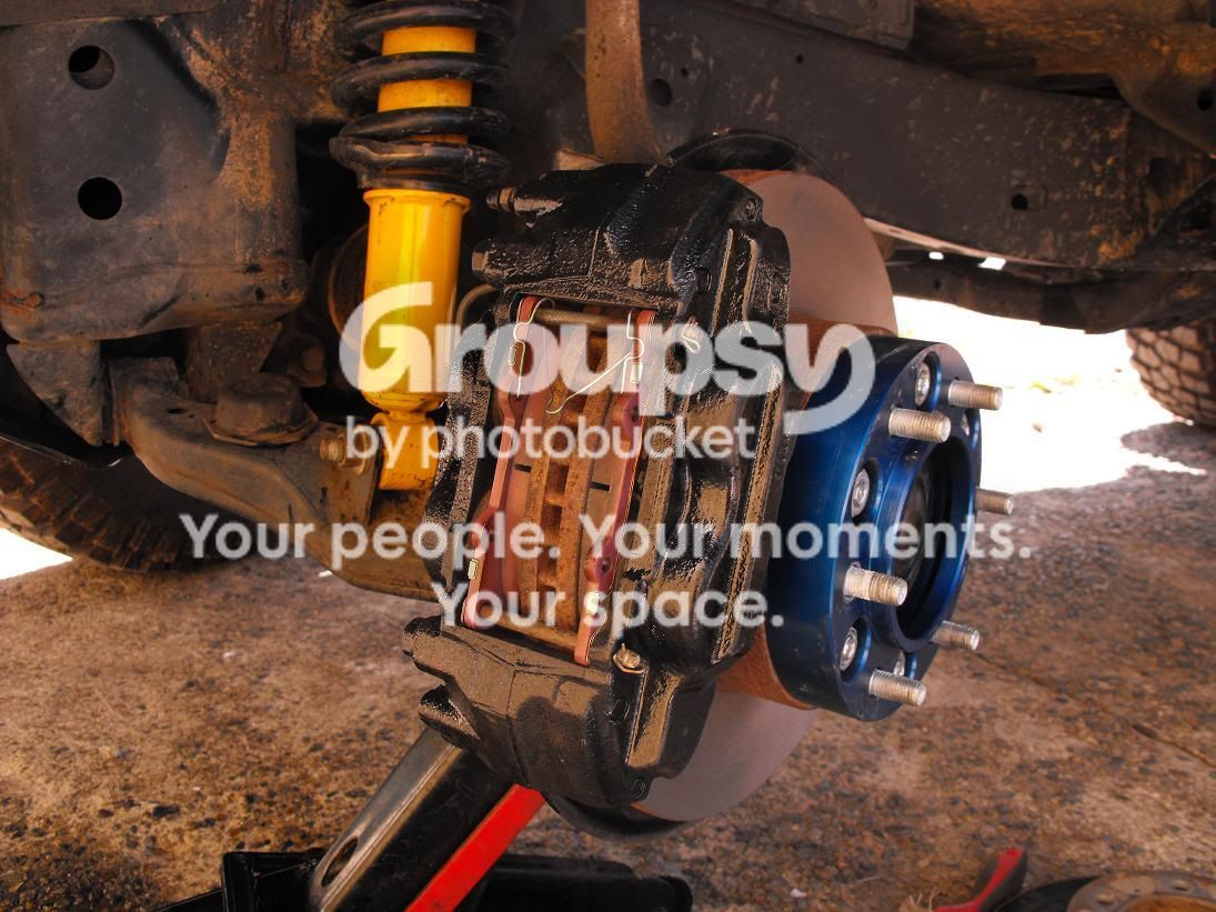

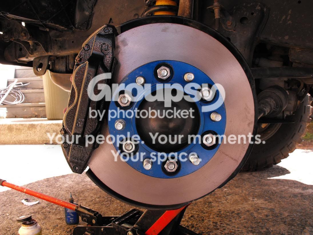

10 days later....I have upgraded my braking system to Tundra 231mm calipers, rotors and brand new pads, it's a definite improvement over stock..after trimming the brake dust shields and bleeding..there was no spongy feel after but rather a firm on the dime braking.

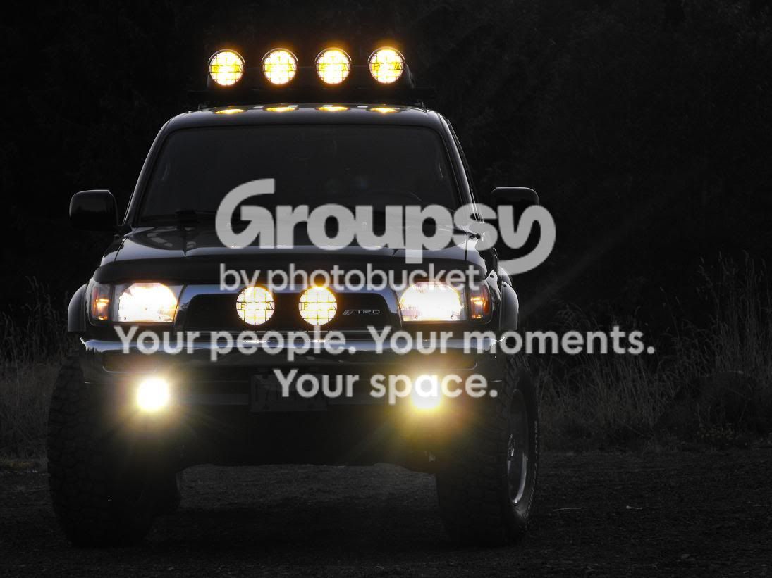

also added more lighting on my roof rack to match my PIAA's up front, took me a good 2 days to mount, run and tuck the wires as stealthy as possible. they are switched in pairs. total of 8 14ga. were used to run them.

WOW u have a great looking rig. I wanna get lights mounted like that too. How much did the tundra brake upgrade run you I wanna do it soon
Man I just tried those lights in the dark..those PIAA's are serious bling..anyway I got the Tundra set for $100 plus $40 resurfacing and $90 for the brand new Tundra pads..they are off of a 2005..

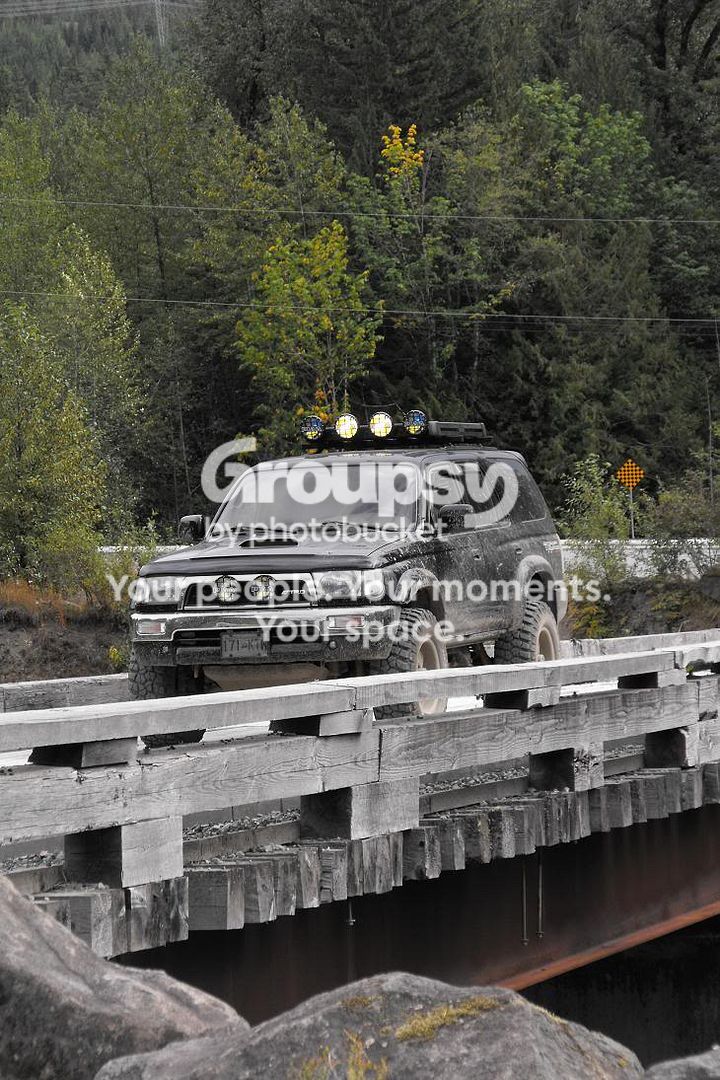

Just a few updated shots from my recent trail ride on the way back from Tricouni Meadows in Squamish, BC...Didn't quite get there due to miles and miles of rough road plus the remoteness of the area renders GPS useless. Although it suits the look for an off road vehicle looking all dirty, it's time I cleaned her up.
