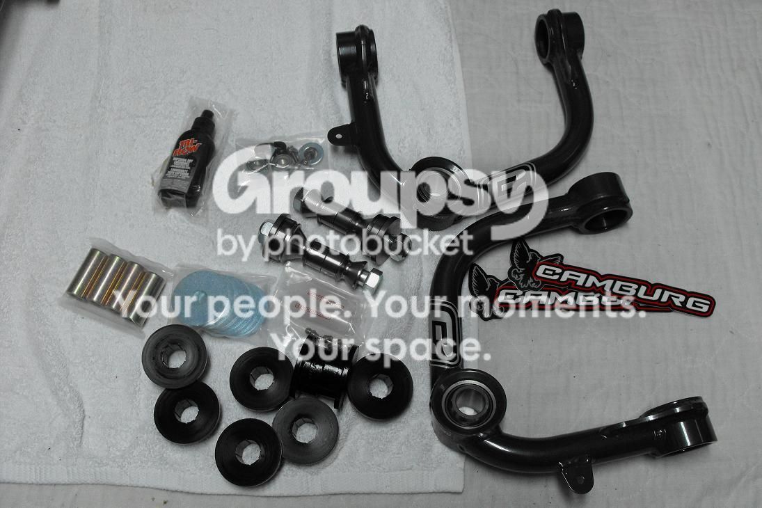

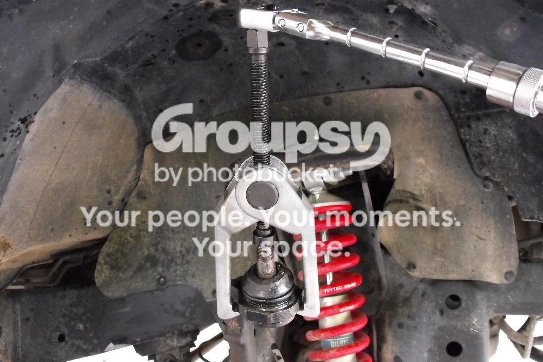

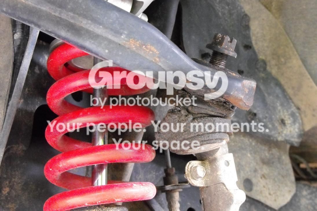

My driver's side UBJ needed some attention and I thought since i'm replacing it anyway, why not upgrade? So a month ago, I got some Camburgs ordered and installed.:guitar2:
Oh poor ball joint
Got these from Wheelers

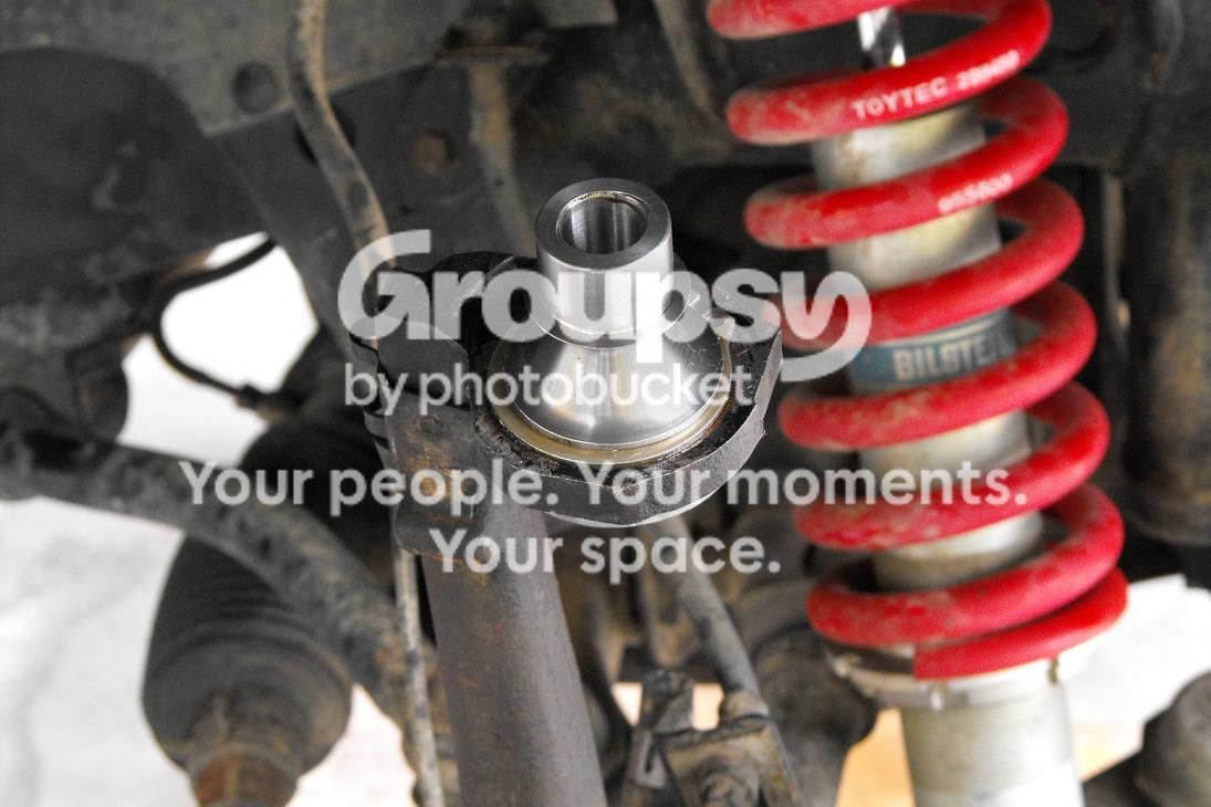

BJ being pressed out of the spindle.
And the new uniball spindle adaptor seated with the supplied snap ring in place.

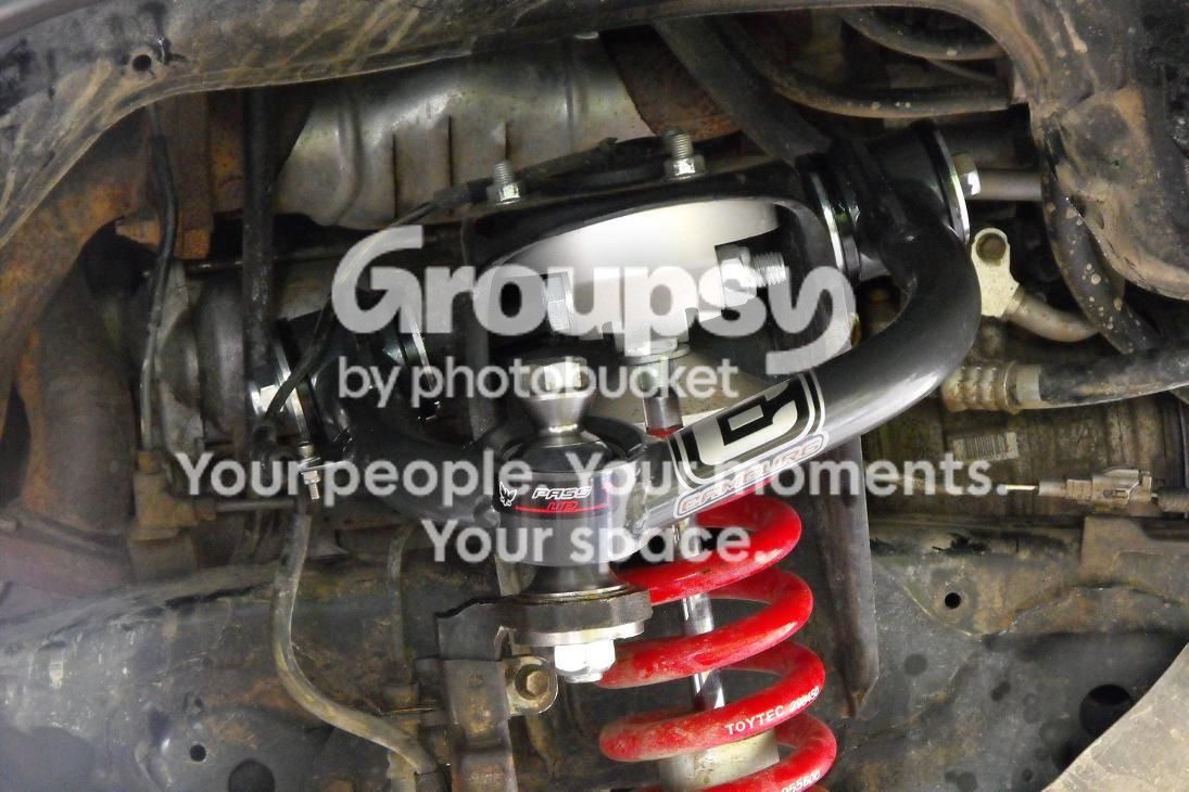

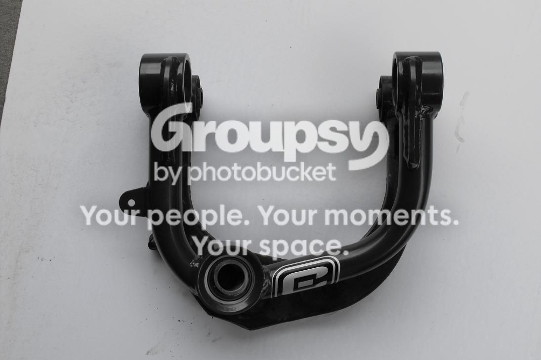

Here's a good comparison shot of the uniball UCA and the factory UCA.

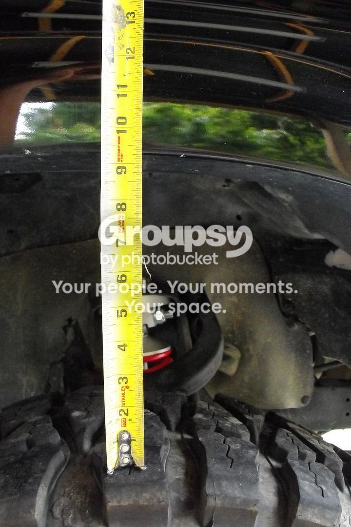

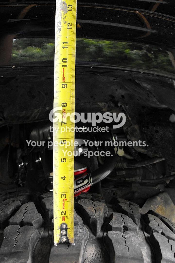

Everything buttoned up and torqued to specs. With the new uniball system, I gained just a little over 3/4" of wheel down travel which equates to available wheel traction out on the trails.
Top of wheel to fender with the stock UCA
....and the Camburg UCA.

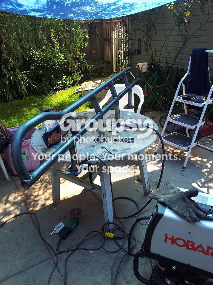

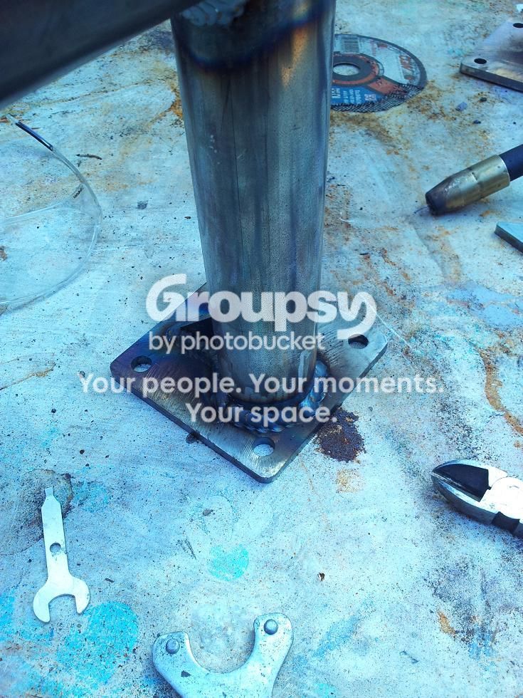

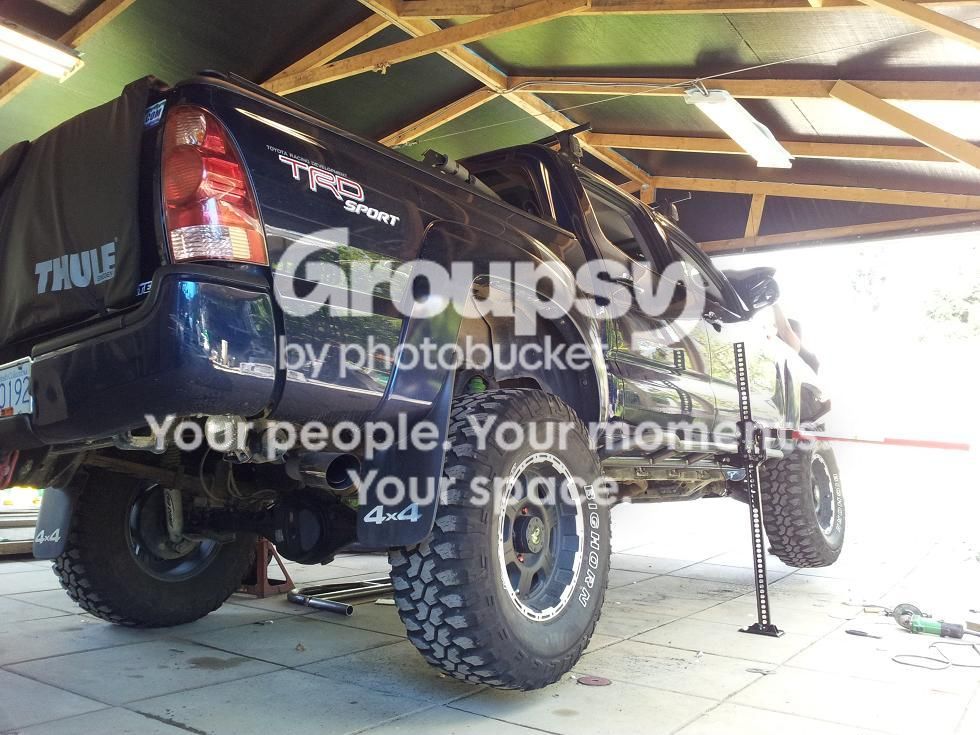

In preparation for our upcoming trip to Whipsaw, my buddy had me weld his 4XInnovations sliders for him.
3-39.jpg~original
4-38.jpg~original
And an obligatory pic validating that the welds are indeed legit.:biggrin2:

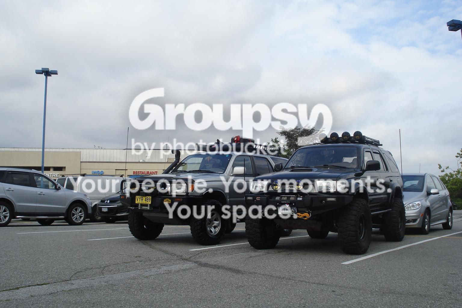

Recently, a friend from Calgary came to town and contacted me for a meet before they head back home the day after.
We headed to the mall to chat and eat for abit and ofcourse....
6-34.jpg~original
Hmm? CBI in the flesh....I like it!

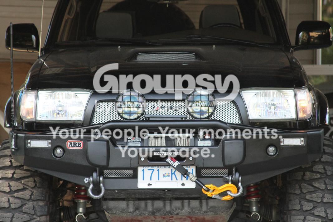

A little modification to the front end of my beloved 4Runner!
103.jpg~original
.....Oh yah, I've also completed the sound system with the the JL amp all hooked up too.......darn loud guys I tell ya!
