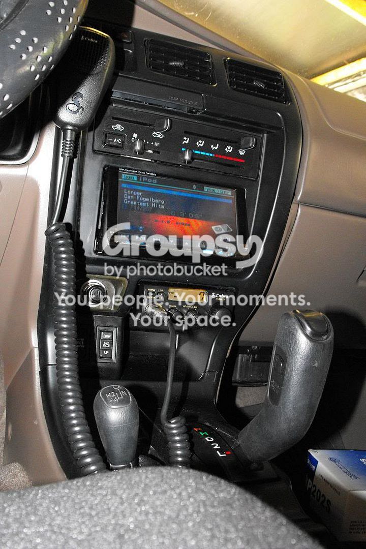

I've since installed my Cobra 19 DX IV CB radio as well as the 4 ft. Firestik antenna. Also routed the cable thru the rear vent just like everyone else.
10-5.jpg~original
That's an awesome CB setup, is there any threads on here on how to do it? Any custom bracketry? I've seen it done before, so I would like to know how to do it as well. Thanks, beautiful rig!
Thanks...to be honest I can't remember if anyone on here made a thread on CB installation. In any case, mounting the unit is relatively easy, I didn't have to use any kinda bracket to hold the CB in place..You'll find how a double-sided tape and some electrical tape works real wonders when paired together. lol!
Once you remove the center dashboard panel and pre-fit your CB, you'll figure out easy what needs to be trimmed to properly mount it.

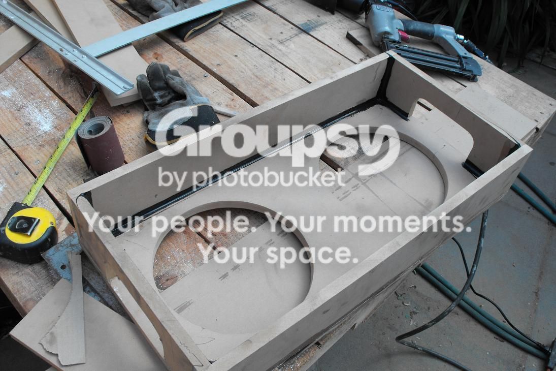

The one thing I've always wanted was to have a subwoofer just to better the sound quality of my stereo system....it's all factory speakers at the moment. I also wanted something compact meant for confined spaces per se. So to the electronics store I went and saw a shallow type sub in a small enclosure...Perfect!!!!

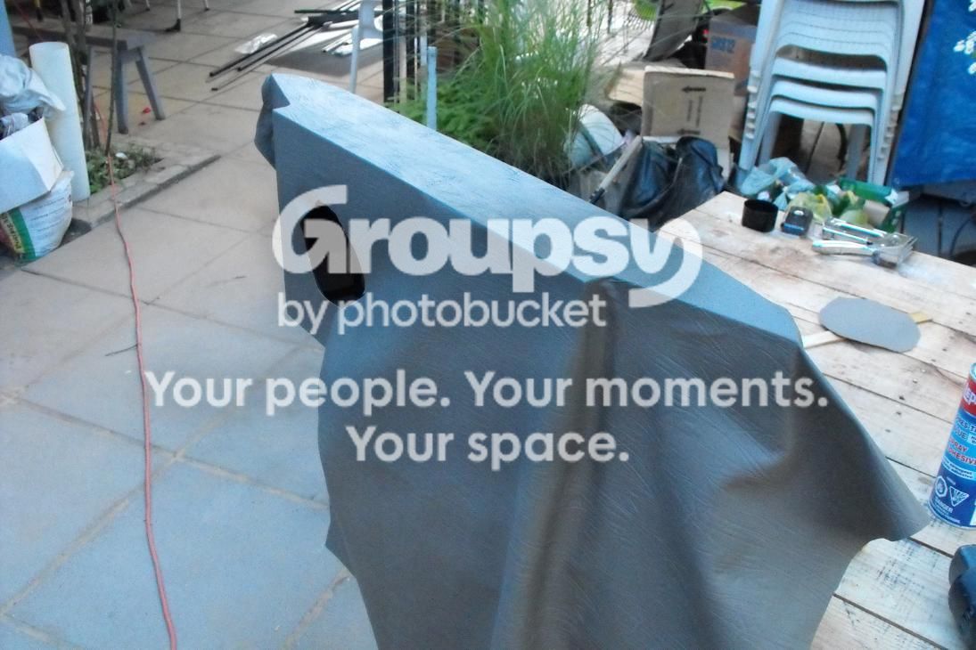

Only gripe is that the box only comes in a plain square/rectangular shape, the height is also perfect for my intended placement of it. Somehow this boxy sub enclosure just wasn't gonna cut it for me....Let's go custom!

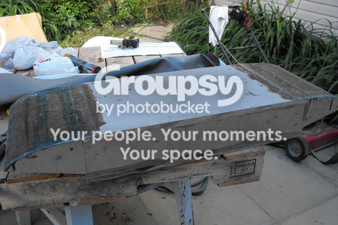

So I went with a 5/8' MDF and went into building.

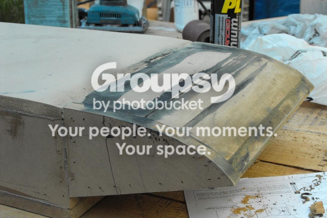

The box needed some shaping.
The joints were all sealed with an acoustic sealant to air tight the box. Furthermore where the curve parts are, I covered 'em up with another layer of fiberglass.
Guess by now you have a general Idea where the box is going?
For the cover, I went with an almost color matched wrinkled finished vinyl. This was one sheet to cover the box, and to adhere it I used a LePage pres-tite heavy duty spray adhesive meant for upholstery use. I also needed a heat gun to conform the fabric to the shape I made.
.......To vent out frustations:mad:...I used some curse words in the process, what a relief! :D
I wrapped the box with a saran wrap just to protect the vinyl from dirt, mainly from my dirty hands.

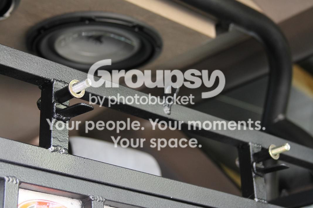

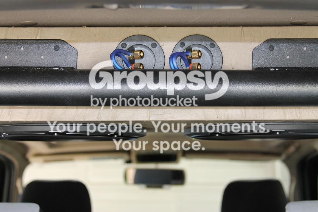

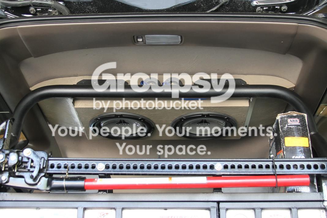

This next photo is a familiar one...yup that's where I wanted to incorporate it on. Let the imagination begin. This was an arduous process to get the right angle of the horizontal bars in relation with the sub box against the head liner. I didn't get a photo of it but what I did was jack up the box tight up on the head liner and tack weld the supporting metal structures to eliminate guessing.

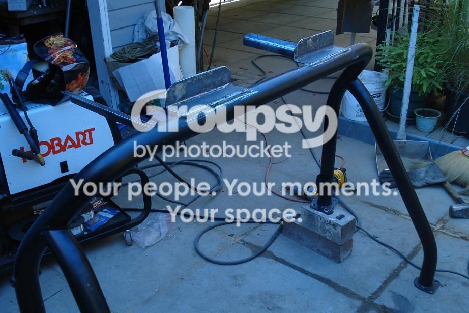

And just to make sure that my welds were all good, I mocked up the box on the two horizontal angle mounts and I put all my weight on it..I really didn't need the additional angle bars sitting on top of the roll bar at all..but what the heck?

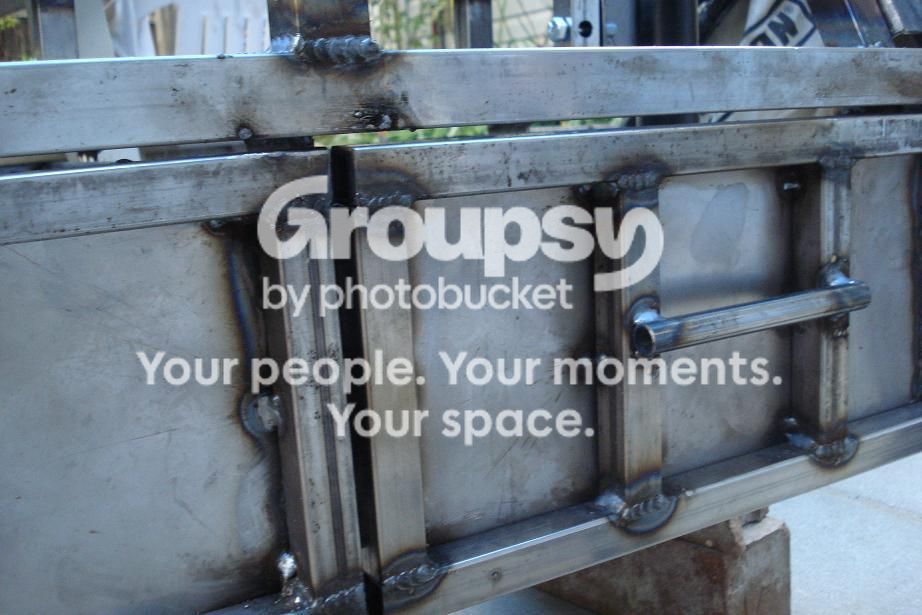

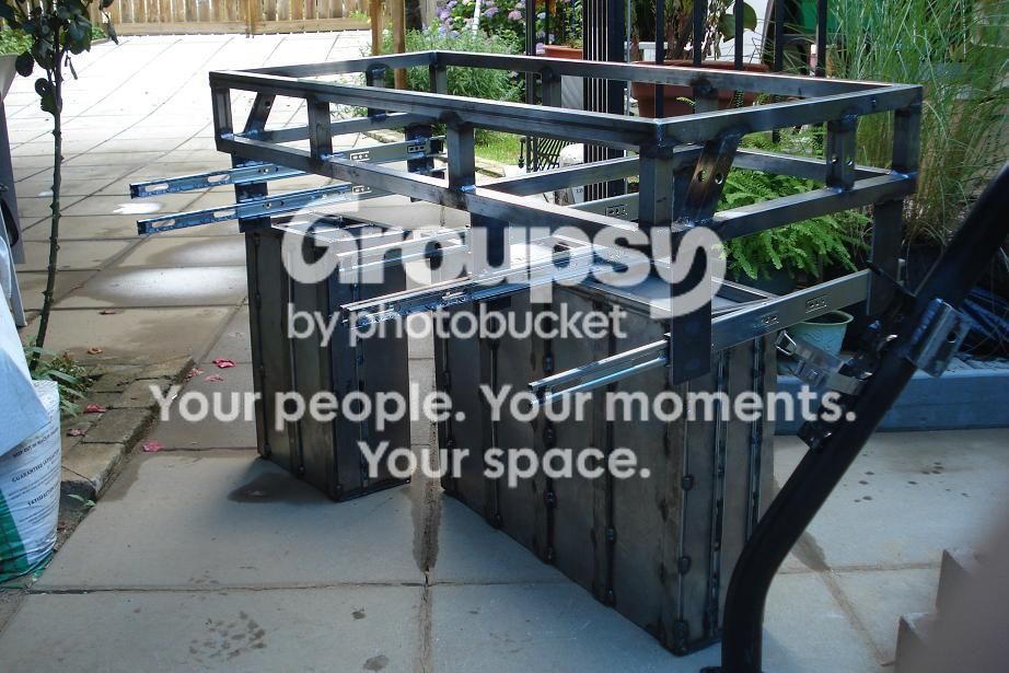

Ok so this next step is all part of my pre-planned idea while the roll bar is out of the truck, I wanted to do my own take on the roll bar mod that Dirtco started. It's not easy to think of a different design setup than he had when it's that nice and functional. So I added a sliding drawer system for my large and small tools and accesories. I went with the light 24 gauge sheet metal and reinforce them with some ribs. Dual heavy duty sliders for the large drawer.
Fishin' in the 12 gauge Stingers inside the roll bar. See Big Fish, I fish too, man. lol!

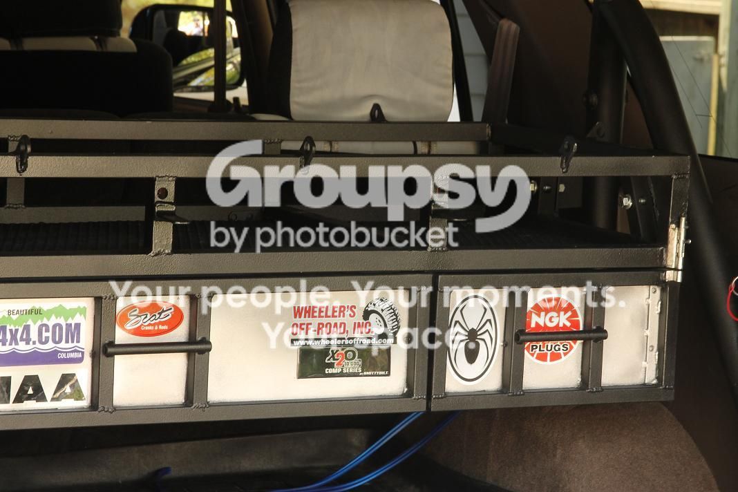

I also re-painted the roll bar and the the shelf/drawer with EZ liner bedliner for durability, the face of the drawers
with an aluminum finish replica..

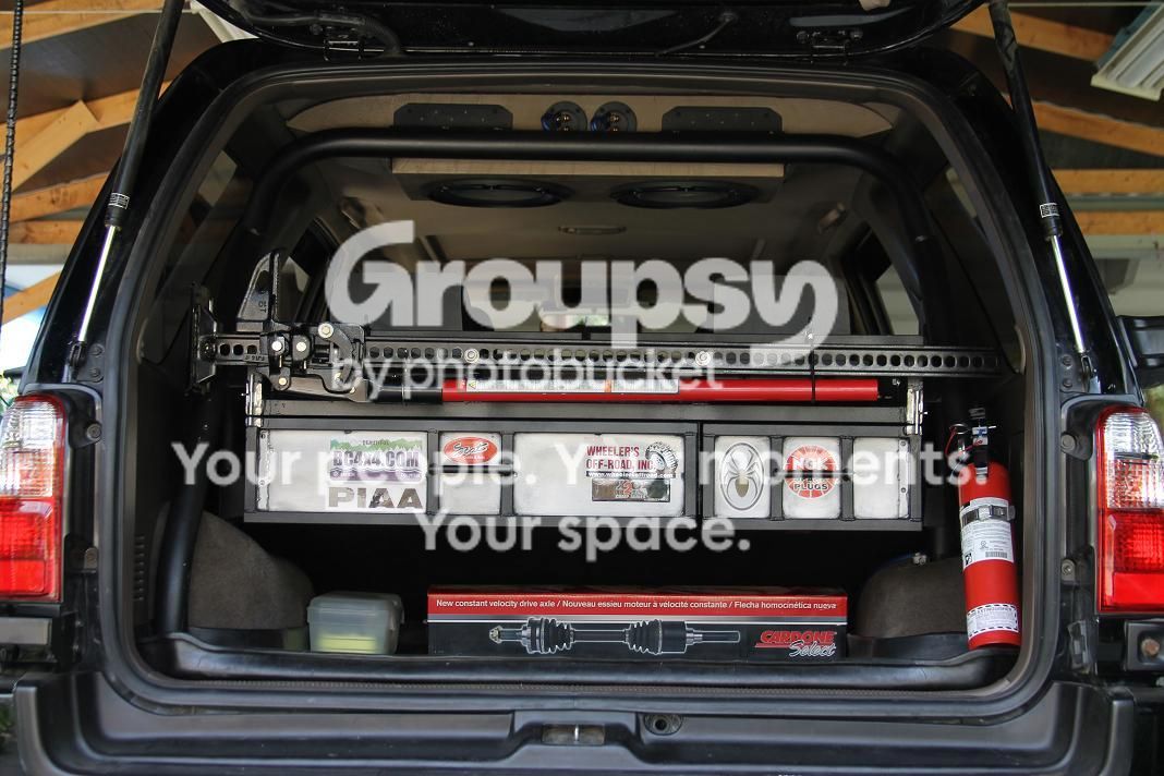

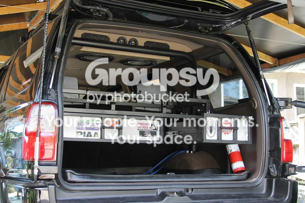

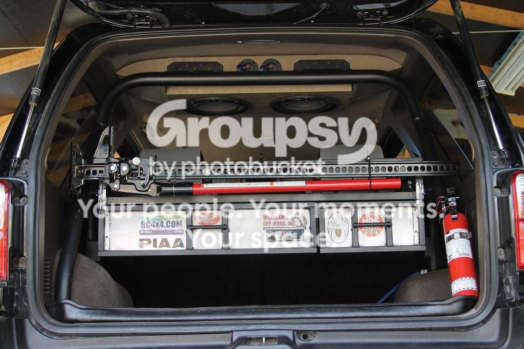

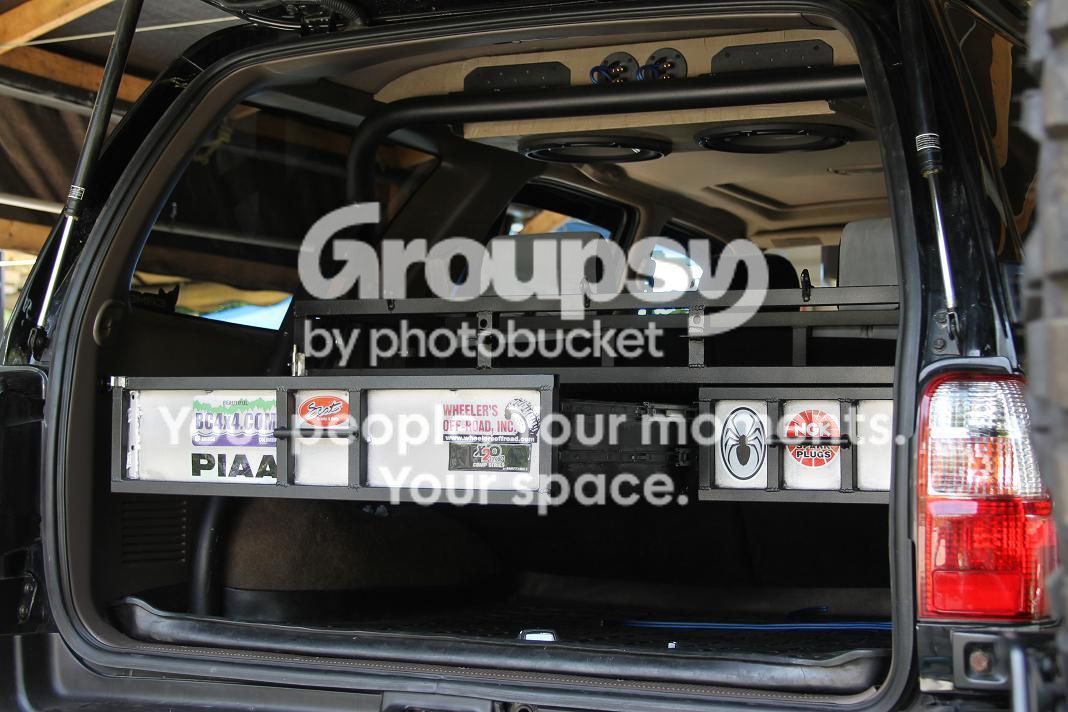

Here's the finished product for your enjoyment.
The drawers slide out as far as the lift gate so no more over reaching here.

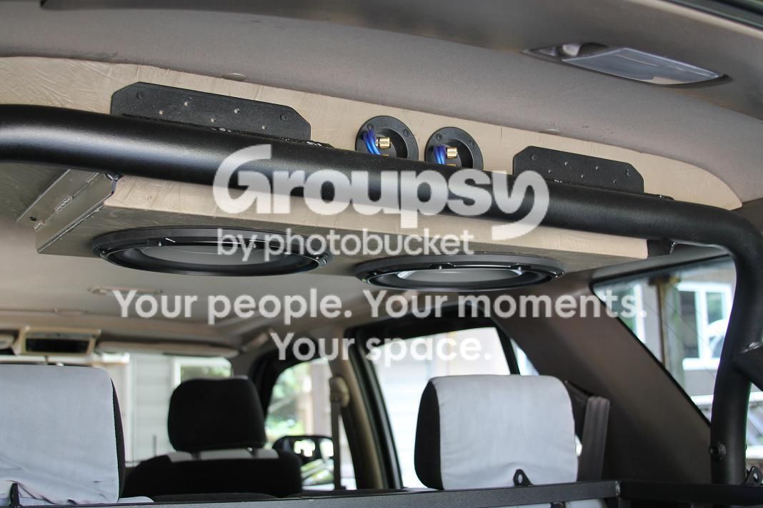

I like how the subs turn out. not obstructive to the view. Just need to connect an amp but that won't be 'til later.
Jack mounts.
My view from the mirror just in case you ask what it's like.
