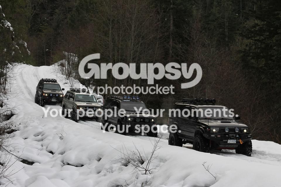

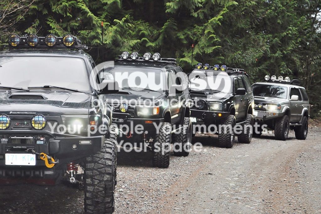

With all of that said, here's some photos I promised of the 4 Retrofitted 4Runners...........and BIG THANKS for the votes guys..I'm indebted with everyone for this recognition............ 3rd Gens represent!
1.jpg~original
10-7_zpsdfca6ede.jpg~original
47-3_zpscaa95dcc.jpg~original
The rest of the photos are found through this link by clicking it! Again, a million thanks and Have a Happy New Year!
