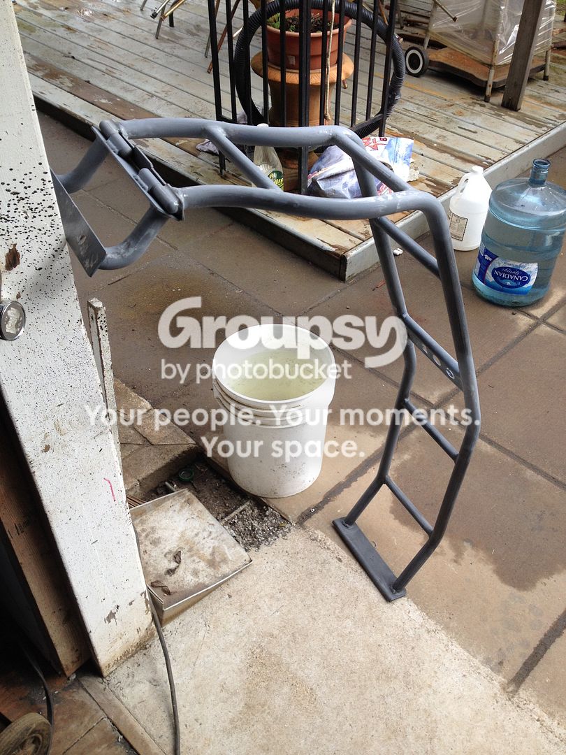

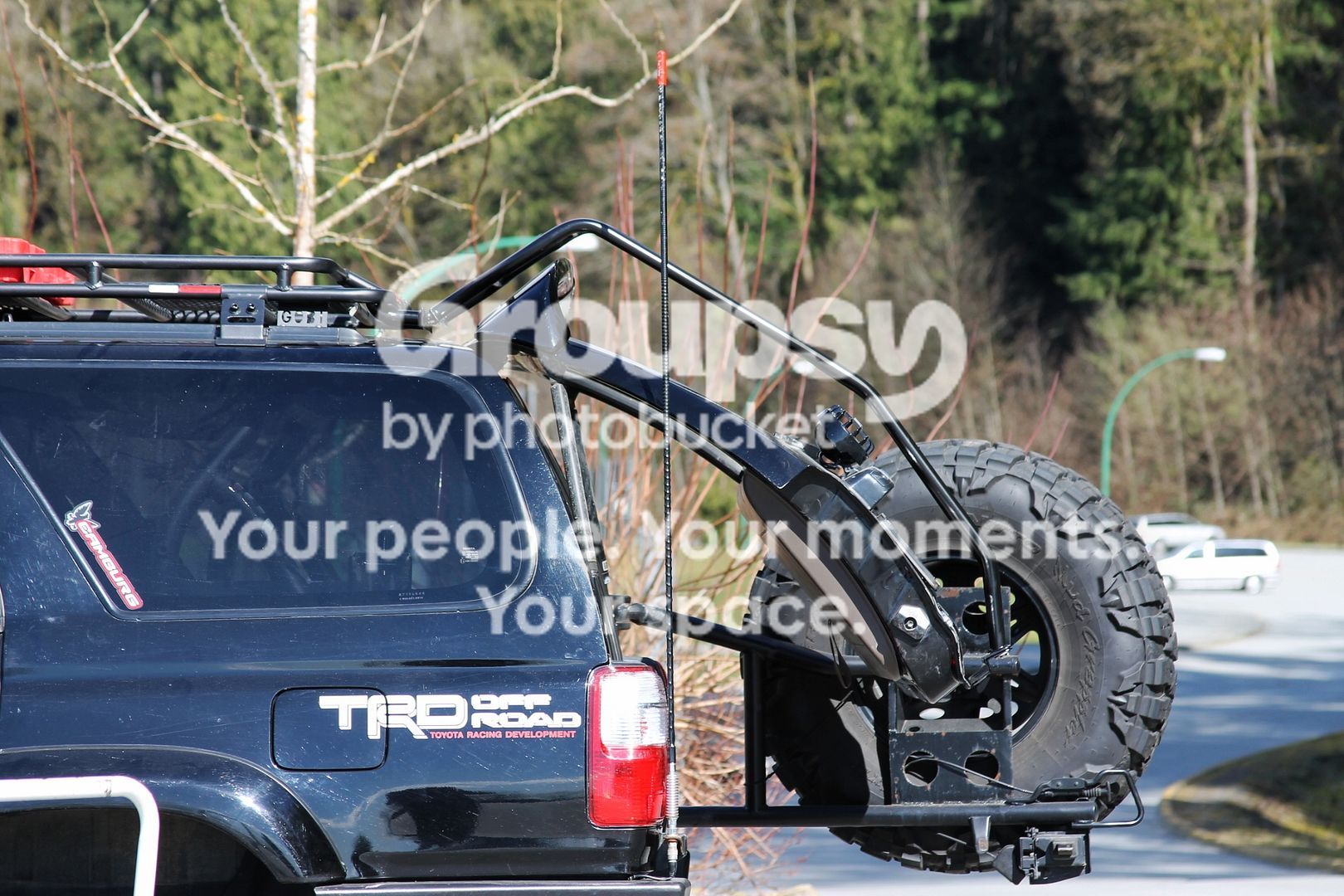

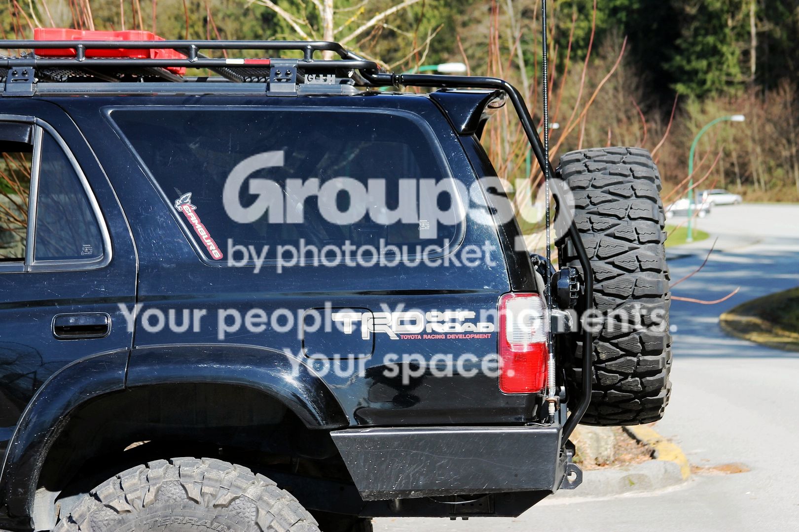

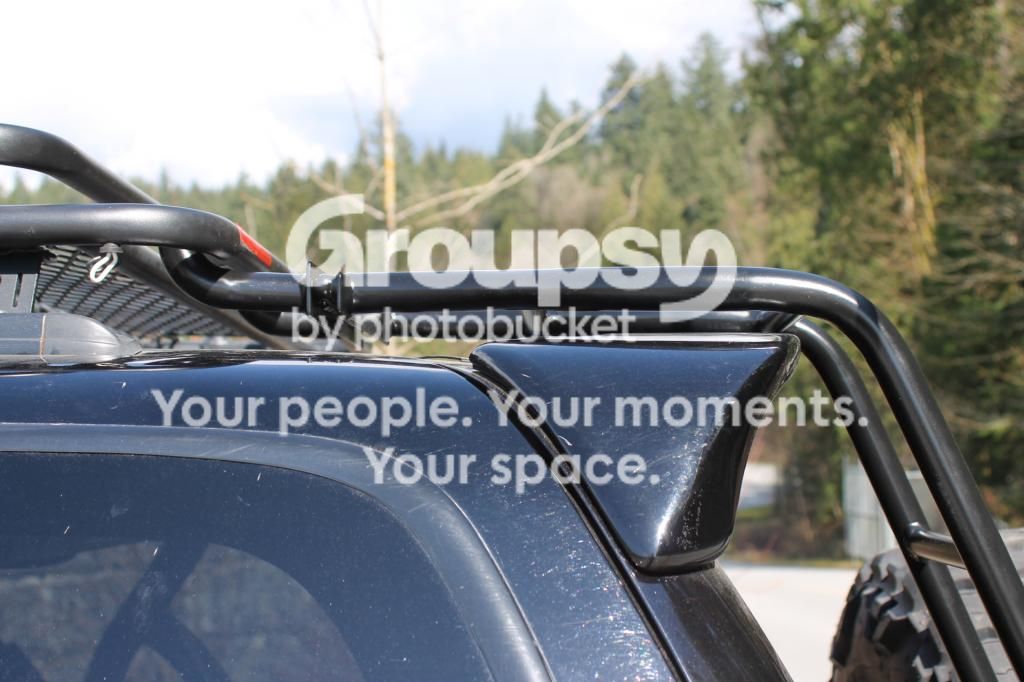

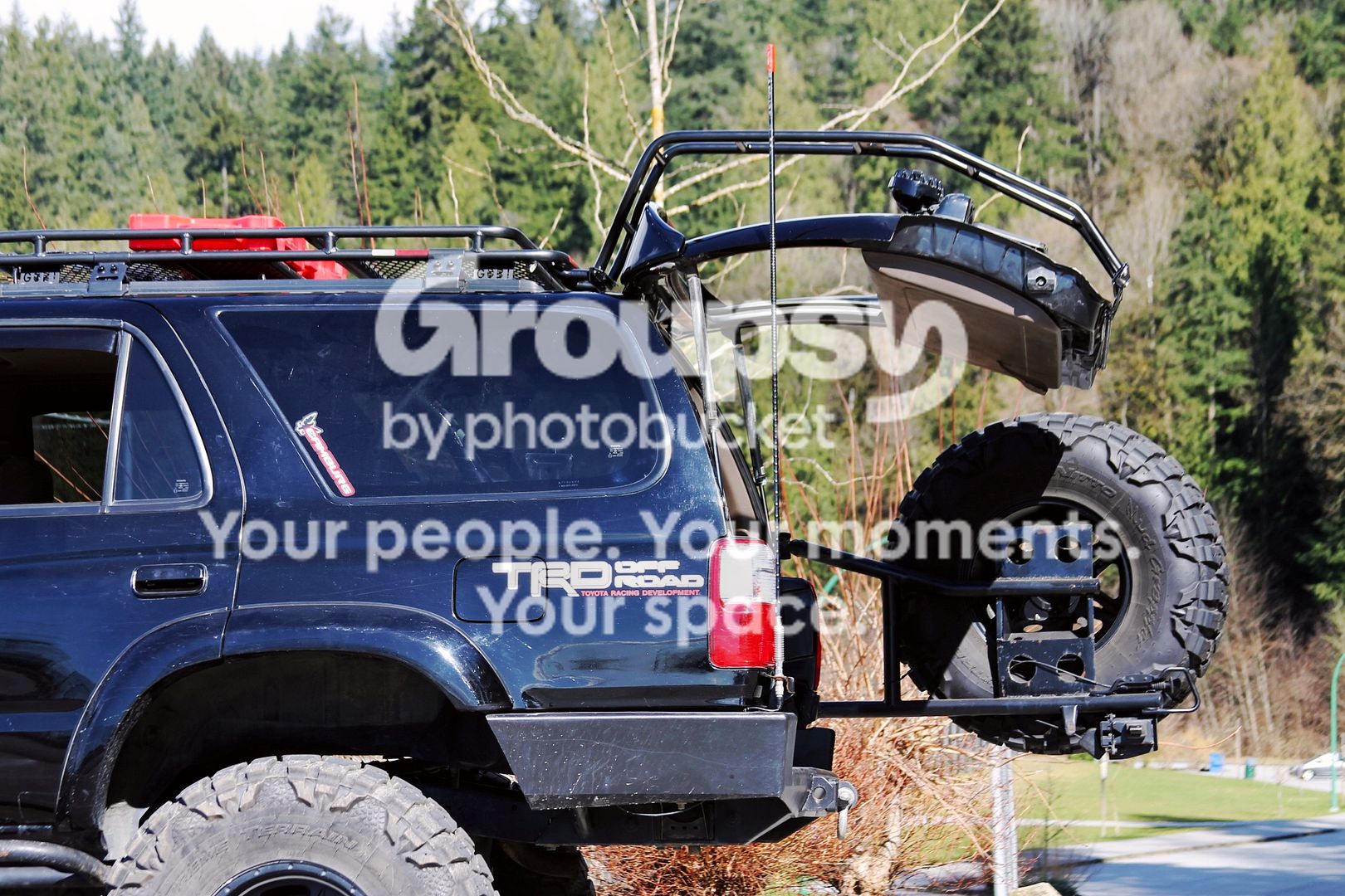

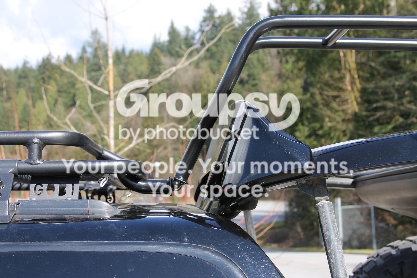

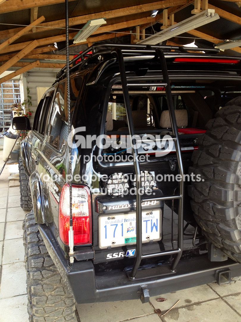

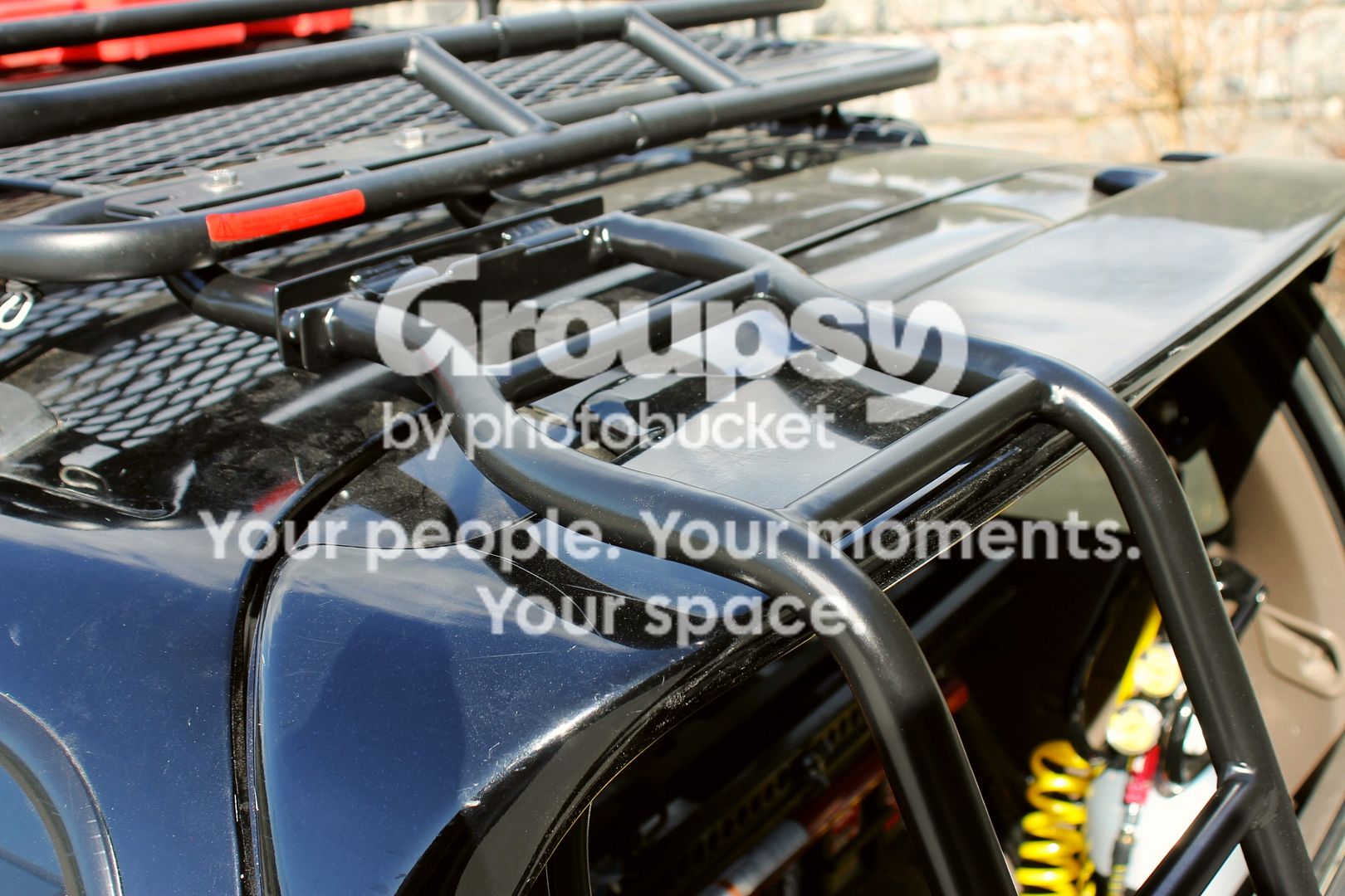

When I ordered my Gobi rack from Trail Duty last July, it came with a rear ladder that I never got to install. That ladder was meant to be installed on a 4Runner equipped with a rear blade wind deflector only.
My dilemma, I have a Jaos type rear wing and things weren't gonna work no matter how far I stretch my imagination without altering the ladder itself.
I started chopping the top portion of the ladder and the idea was to connect it to the roof rack itself as I had no viable option of mounting what was left of the chopped ladder onto the top of the rear door where conventionally, it was supposed to be mounted on. The old Jaos's mounting system got in the way for a mounting possibility, so onwards I go.
At the back of the roof rack was a light tab wide enough to accept the width of the ladder for an easy mounting point and so I went with that, that being the only choice I have.

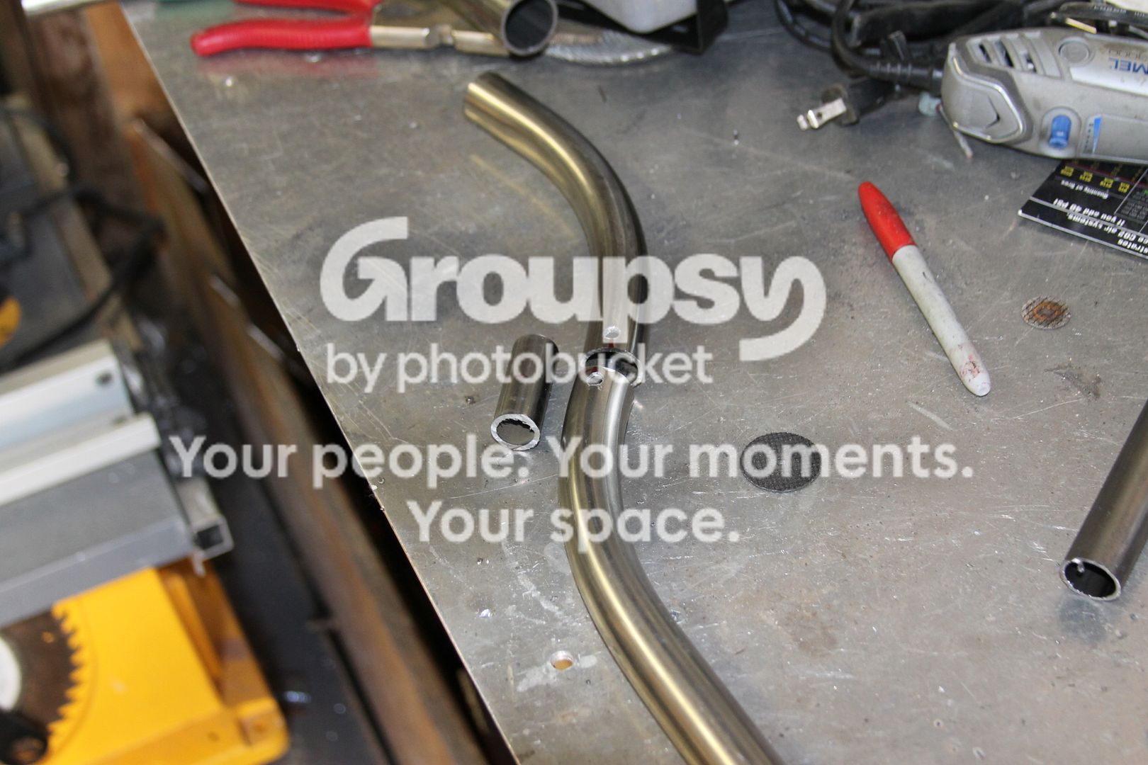

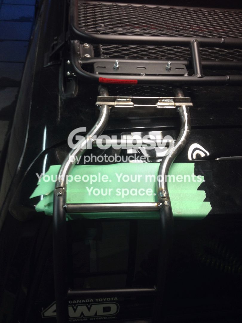

I used an emt tube bender and bent 4 pieces of 1" tubing that would eventually form an S-shape.
See the part where I chopped the ladder, the amount of offset in relation of the ladders location to where it was gonna connect to.
Of course the newly formed ladder would use a hinge system as well. Now this part took alot of adjustments just in order to make the pivot work with the rear door.
I had this ladder powder coated to finish it off.
I recycled the Gobi signature that was originally on top of the ladder and welded it on the ladders rung.
WOW!! Love the ladder/hatch setup! The light bar looks great---- the whole front grill/bumper/winch---- fantastic! Truly inspiring!

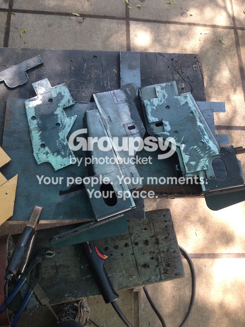

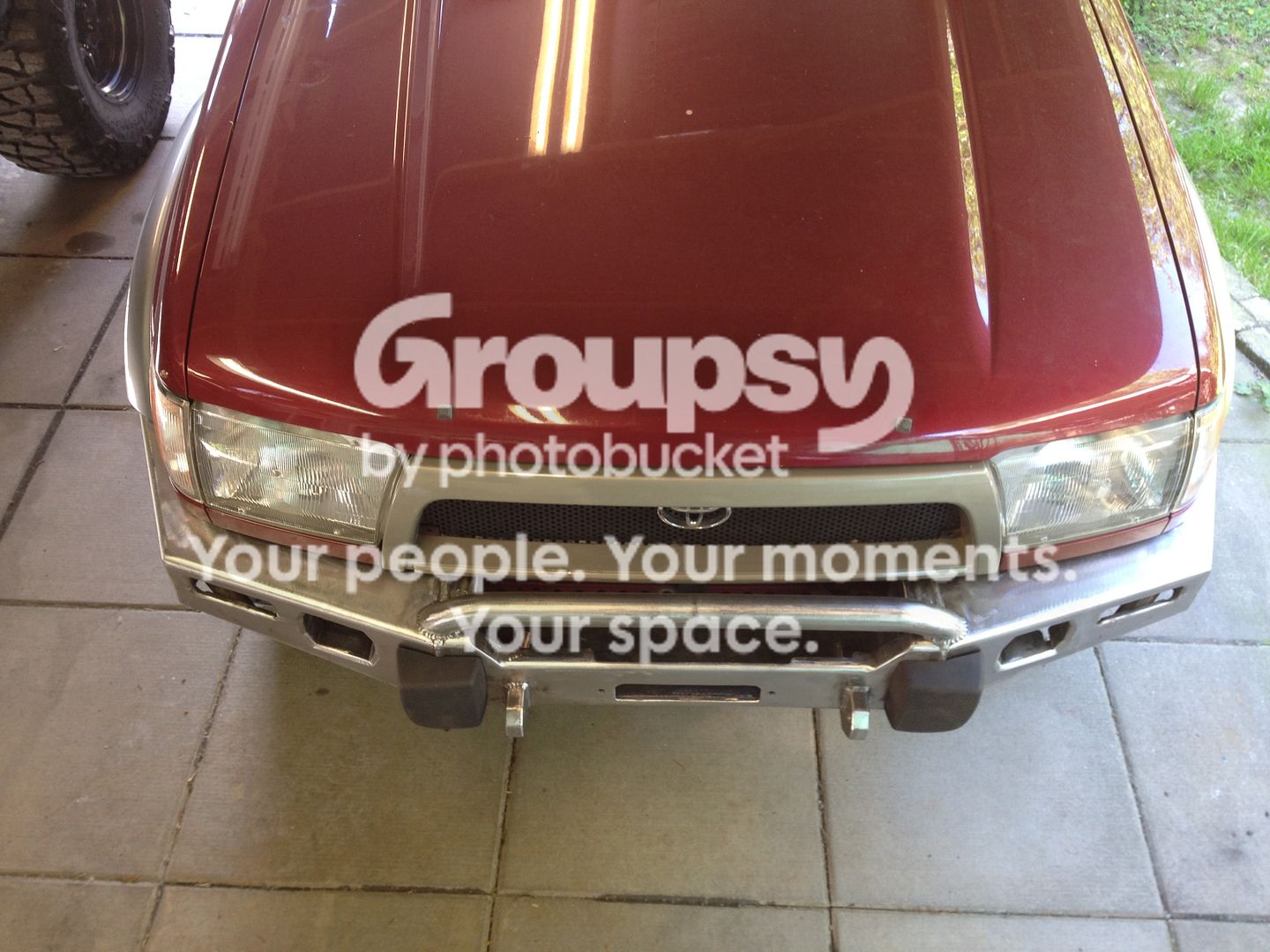

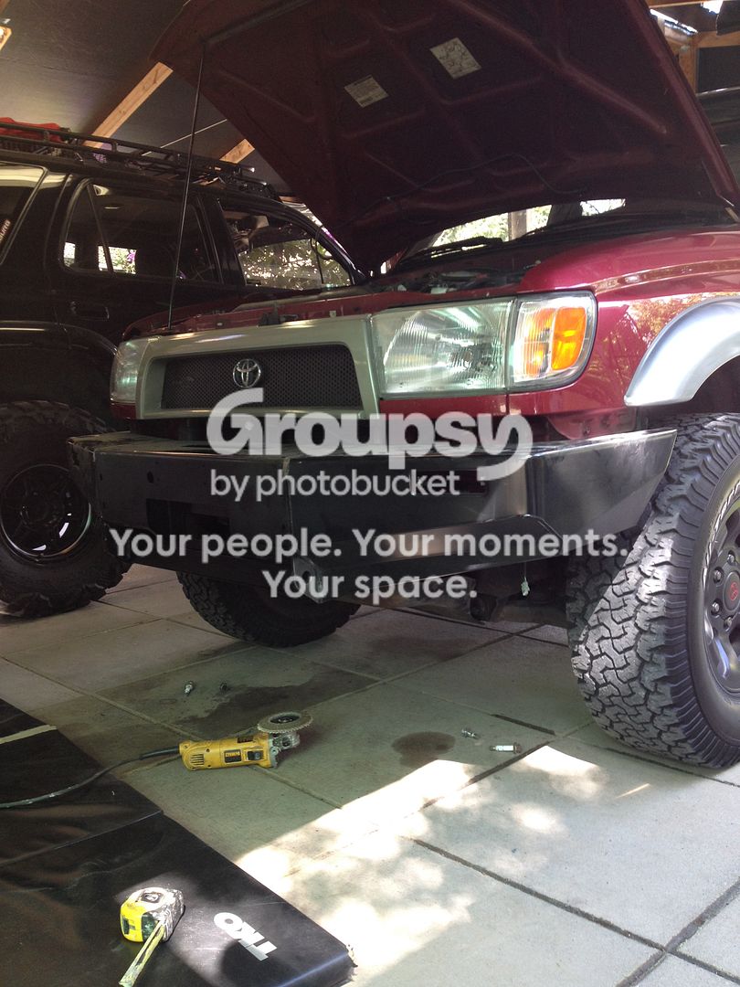

In the middle of everything else, my brother from California decided that he wanted the same exact bumper that I have- being the modified version of the ARB bumper....and so I obliged.

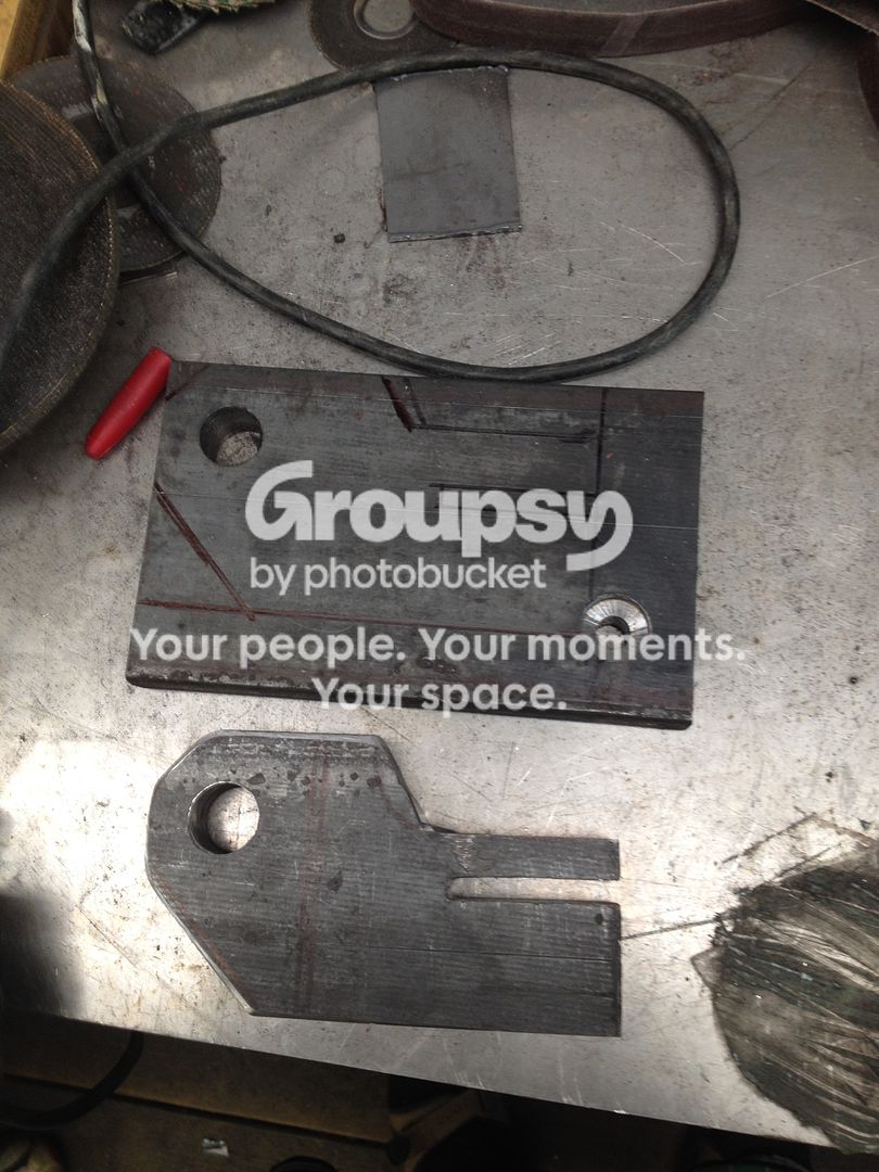

We picked it up from North Shore Off Road in the first week of May this year. But due to the things I needed to make in preparation for making the bumper, I didn't get started on it until the last week of the same month.
I was determined to use mostly the plasma cutter for the major cuts for this bumper project but knowing that 110Volt wasn't gonna get it done, I decided to hook up a 220 volt line from the main breaker to the garage and that took time and research. Now that I have the 220 volt capable plasma, it was time to get to town.
My cousins 1996 became the guinea pig for the project. Firstly, I had to put a 1" BL on it for the same reason as my brothers 2002 also has a 1" BL.
I'm just gonna post some notable pics for the documentation purpose but I'll post a Photobucket link containing over 100 photos of the whole process for you to see.
And the Finished product....
......My retrofitted headlights went into ^this 4Runner...I think it looks better on this Sports than when I had them on mine. The overall look just flows together well.
Please visit this link when you have the time to spare...Photobucket link...
3rd Version ARB Photos by blcktpgsr | Photobucket
