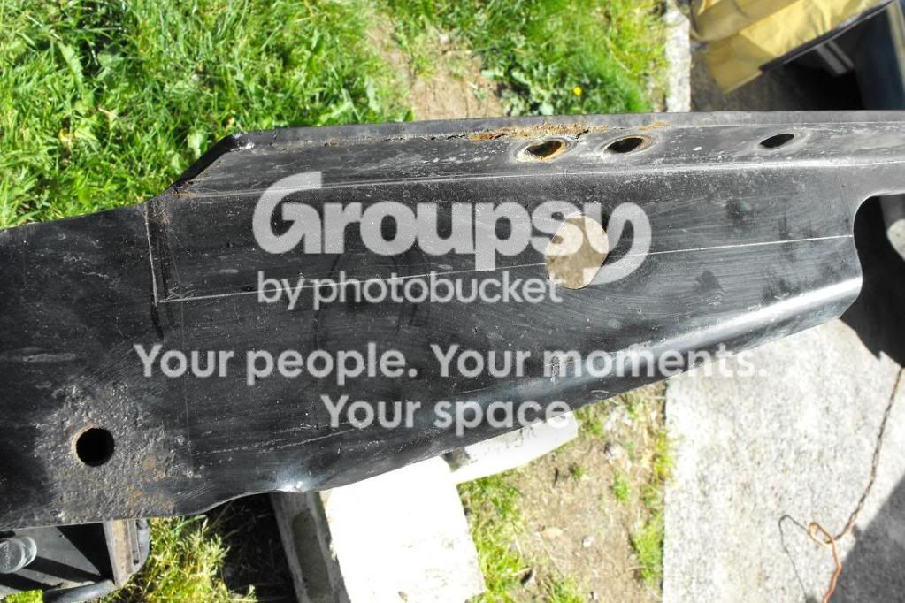

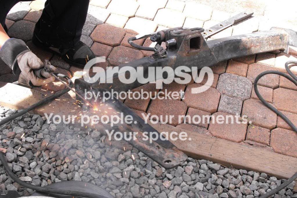

.....and lastly, to those who still have their trailer hitch but dreads the gapped look created by the Bodylift well, too bad! jk! jk!:biggrin2:
Here's what I did to put the hitch back up to stock form..
6-3.jpg~original
7-4.jpg~original
http://i763.photobucket.com/albums/xx277/erionracer/9-1.jpg[/QUOTE]
So if I understand correctly you just measured the gap.... Cut out the side and re-welded it adjusted down 1.5" or did you cut metal out...
A little additional info would be awesome.. I see the pictures but if you moved the side down wouldn't they be pushed out to the sides prevented the mounting points from aligning?... Or did you open the mounting holes a little more to allow for adjustment side 2 side?....
Thanks!
Thanks!

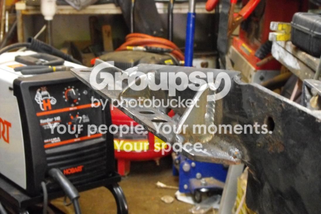

Basically, i removed the whole section from the lip/flanged part(part that physically attached to the frame) to where you see the white outline...
Cut it up again across where it bends then re-use the lip section and lower it down 1.5". Weld and gusseted after.
Hope this explains it better..Cheers!
[MENTION=46329]blcktpgsr[/MENTION]
Ahhhhh!!!! Those 2 extra pictures helped out a lot!
I understand now completely! Although I don't plan to ever tow anything.. The gussets are a super good idea. For strength especially now that there is little to no support when re-welding that back on.
What did you you cut it with? A grind wheel? It's thick metal!!
Btw. What type of welder do you have? Your weld beads look superb.

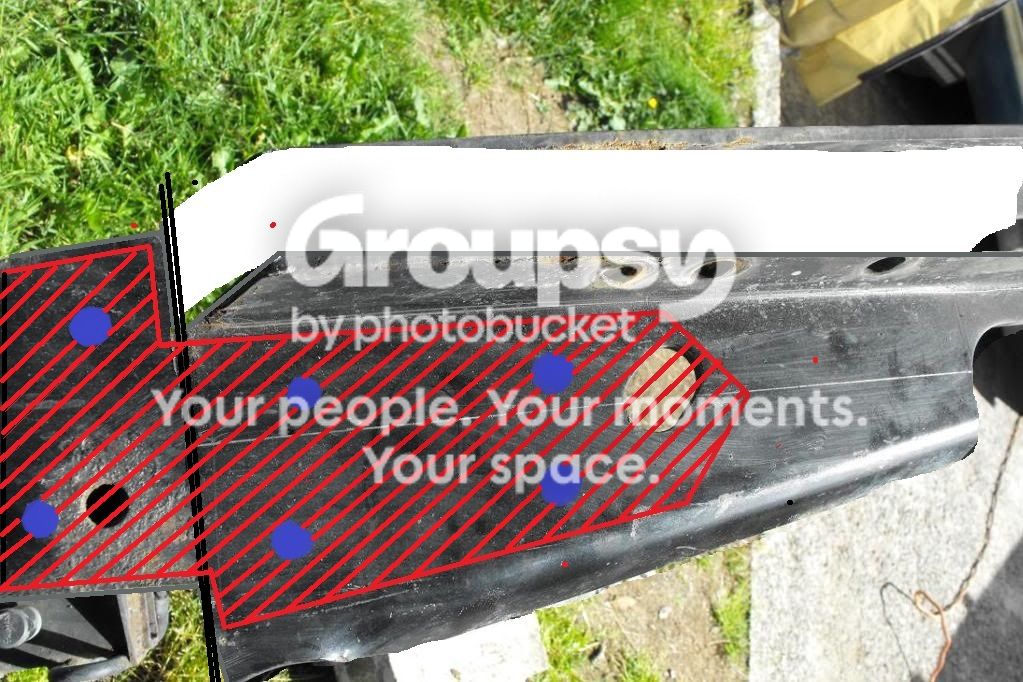

I did another one for a 1"BL application but in a completely different approach..much more superior than the previous one.
Analyze this photo and see how I did it
completely cut them in half, raise the hitch bar to suit your BL height, then slap a piece of 3/16" plate to join the two together.
Red area represents the 3/16" plate to be welded re-joining the cut pieces together....Blue dots could either be plug welds or maybe even bolt that goes thru both plates. Black vertical line is where the complete cut is. Weld around the perimeter of that 3/16" plate and you're golden.
This way, you retain the structural integrity of the bend.
Then put gussets as seen in this photo..
At the time, I didn't have plasma to use, just plain ol' cutting discs so it made cutting a little annoying. That welder is my trustee Hobart Handler 140.
Thanks
Brilliant!
My concern with doing it this was was that because a 1.5" BL is a significant drop I guess you made for that with some extra metal and gussets...
But I see how this is less cutting and less room for error because it's just a straight cut down both sides!

Exactamente. I would say 1.5" BL is borderline the most this method works best on. Atleast you'd still have a big chunk of extra plate to hold the two halves together.

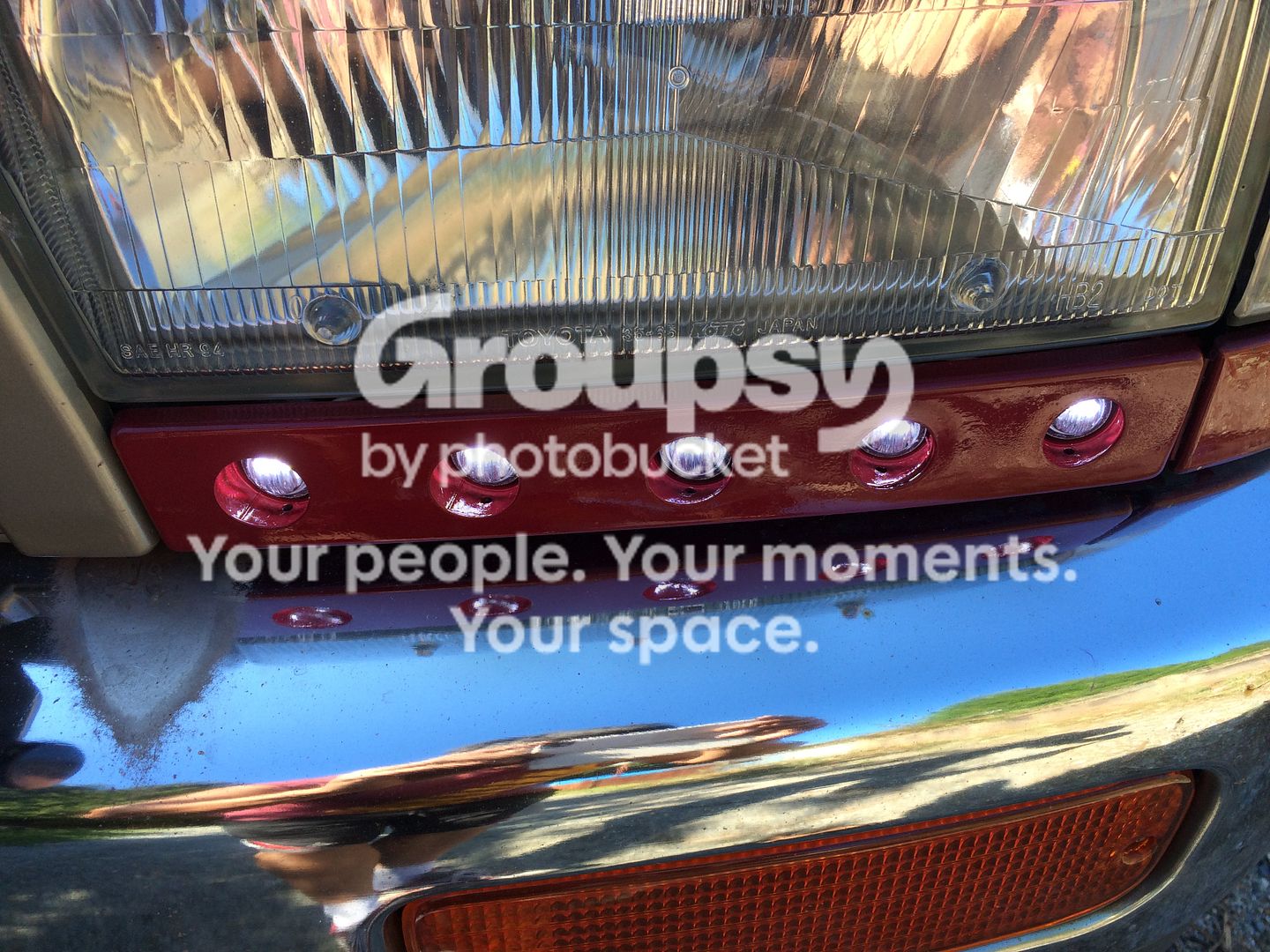

While this thread has again been re-visited, why not update it with some small mods I've done while being away.

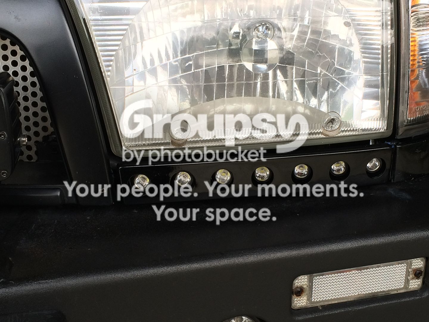

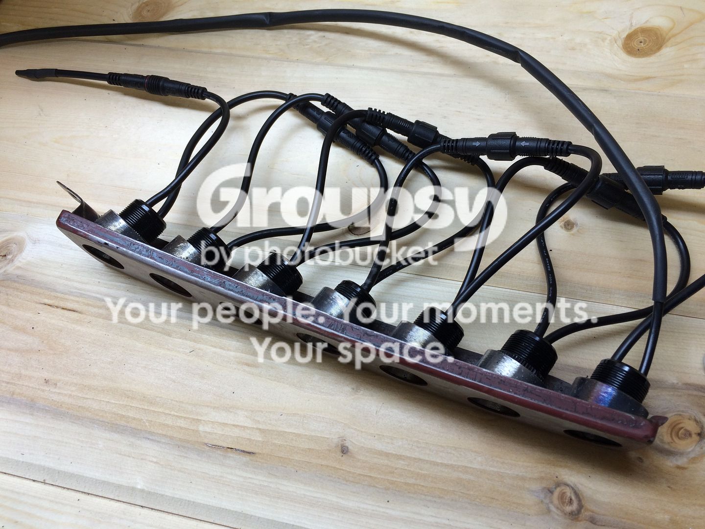

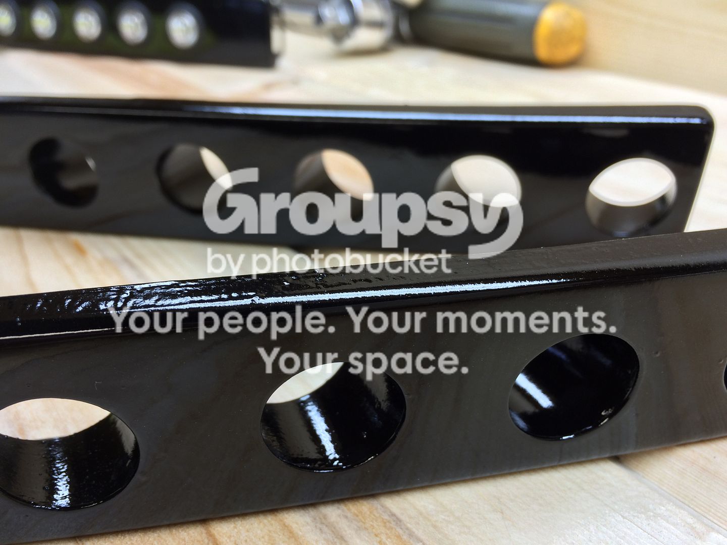

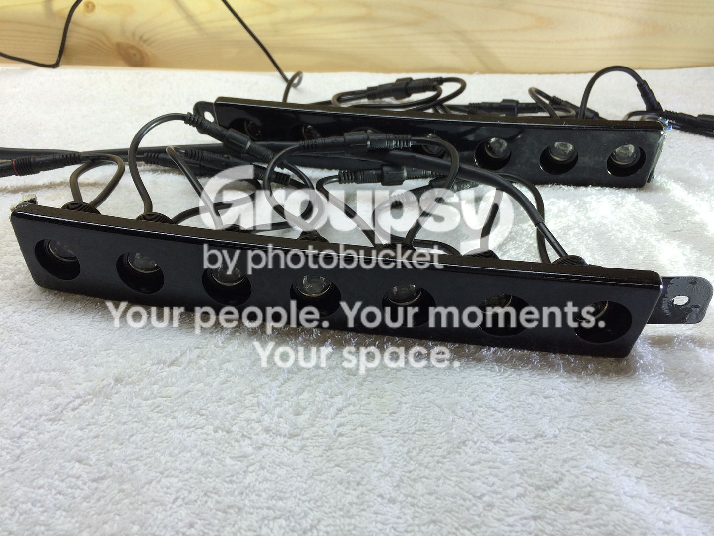

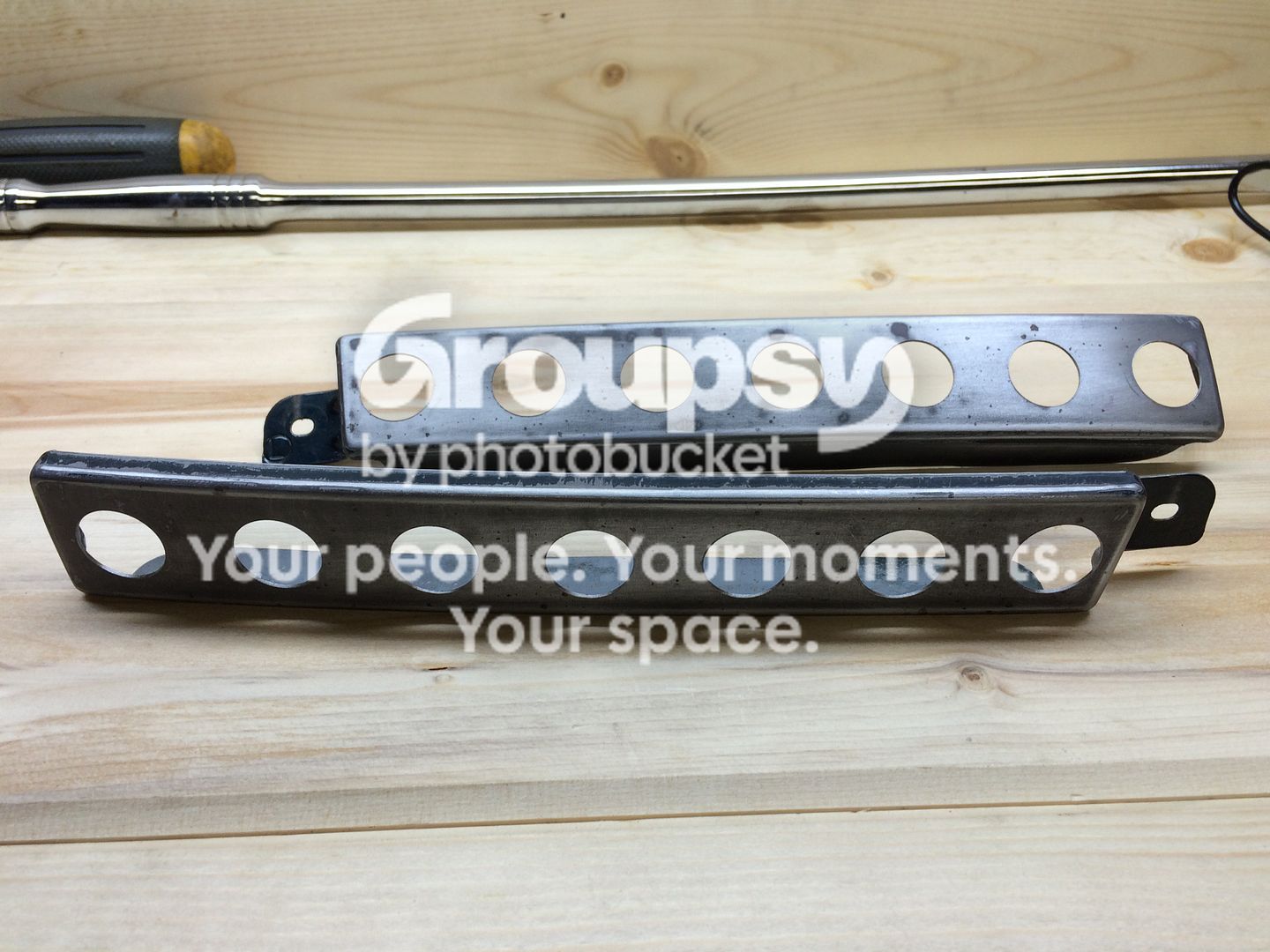

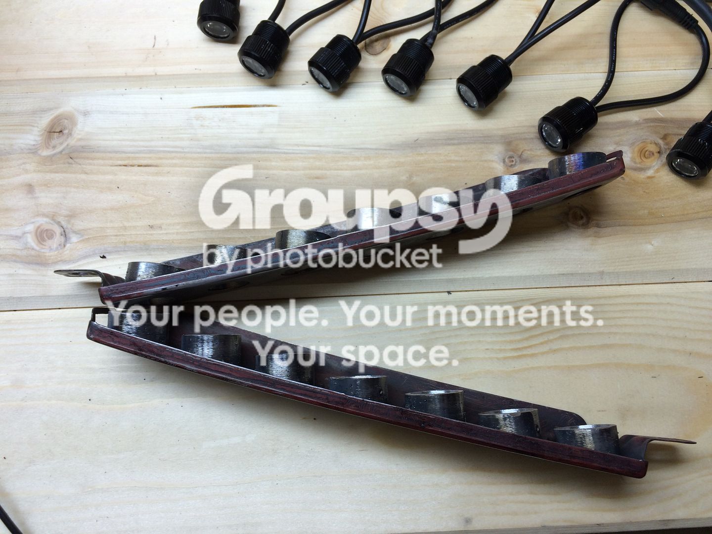

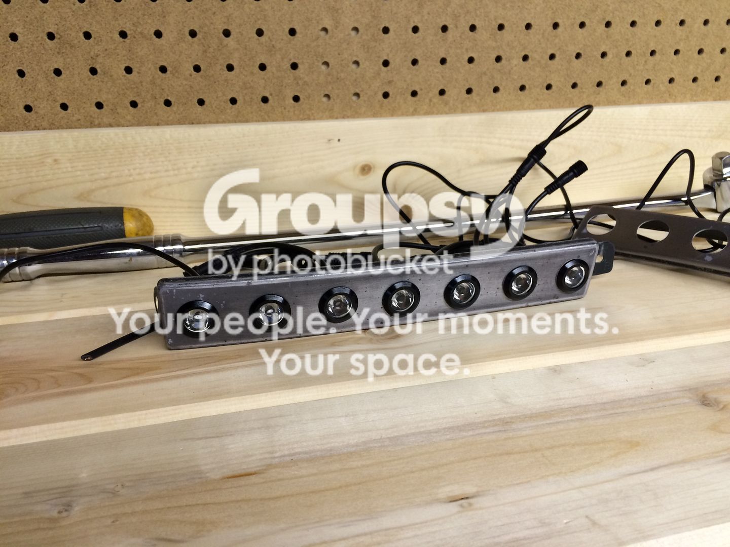

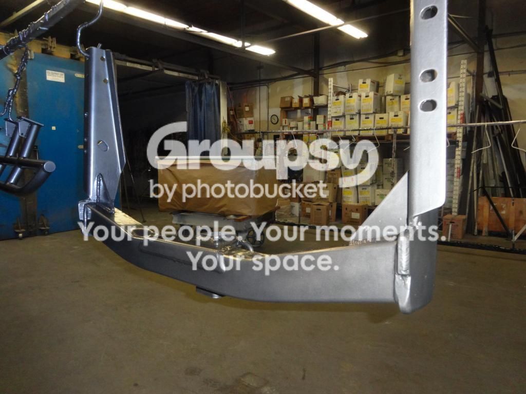

This started out simply by drilling holes on the filler plate to accept 7 LED DRL's.
Everything was fine until I had them installed back on the truck. I went in front to have a look at how bright they were but surprised to see only half the brightness looking head on, reason being, they were facing at an angle because the filler plate they're mounted on naturally sits at an angle. You'd have to go out to the sides to appreciate they're full brightness.

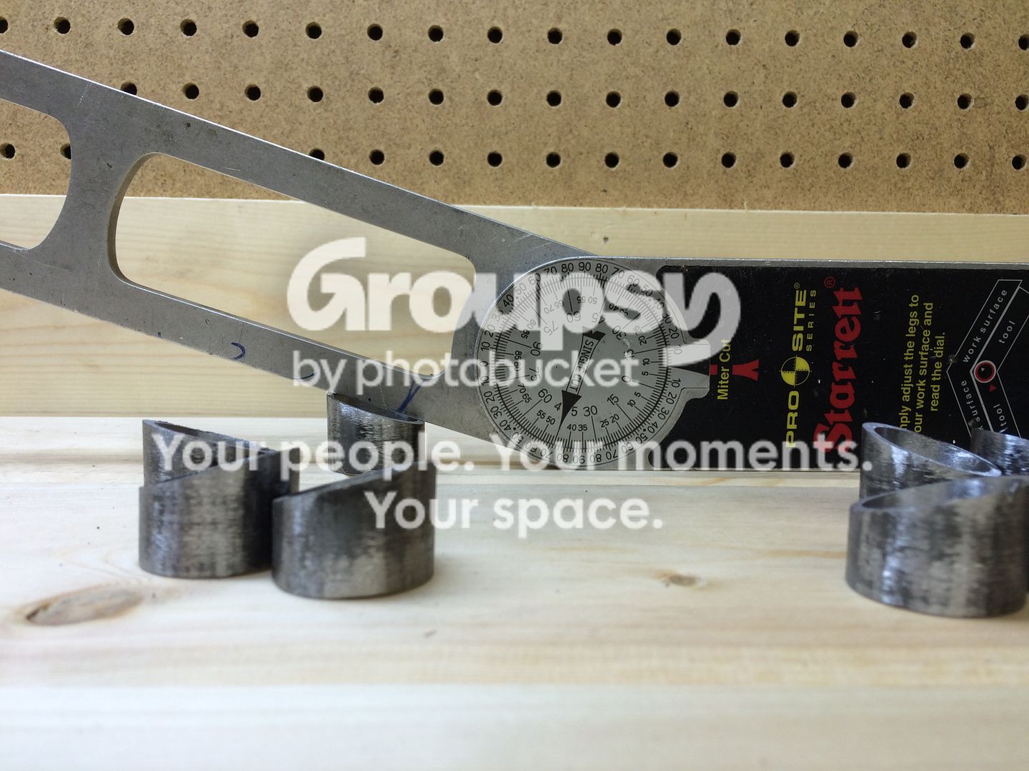

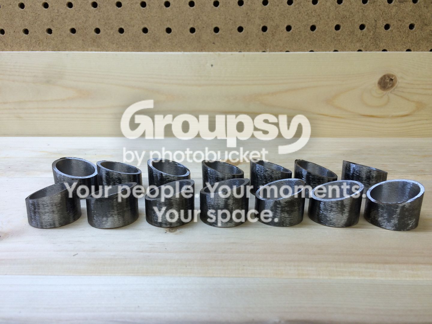

I wasn't gonna go and settle with that disappointment. I simply calculated the angle I needed and that was 8-9 degree from zero and I'd have the LED's facing forward.
This is how much of an angle the filler plate sits at in relation to the bumper, looking at birds eye view.
Then these..
Tack the angled tubings in place..
All primed, painted ready to go..

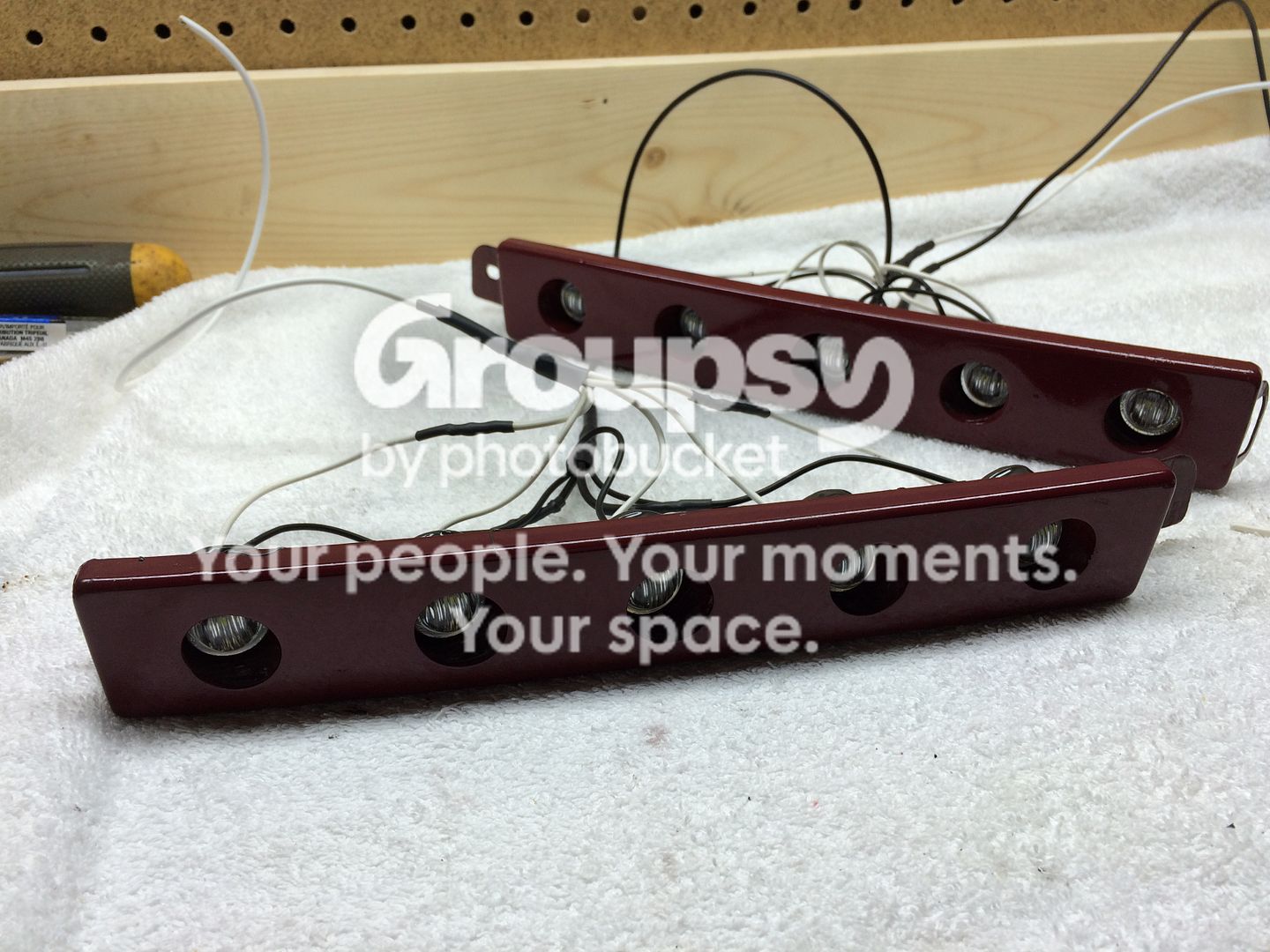

Just how bright are they? They're 1 watt each in comparison with a 20ma amp draw of the Maxxima LED's. They're really noticeably bright even during a nice sunny day.
Here's the link to the LED's
http://www.google.ca/url?sa=t&rct=j...iIKwBA&usg=AFQjCNFTZRt0CQrz0GLZq4K9VQJTvJezkA
Here's a 5LED version using Maxxima LED's

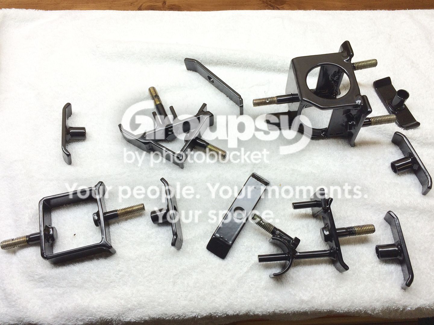

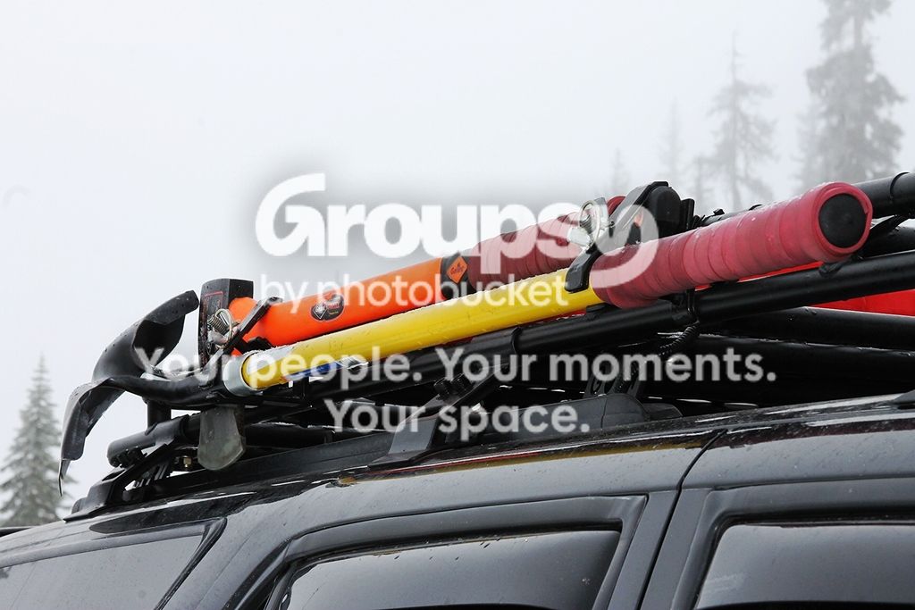

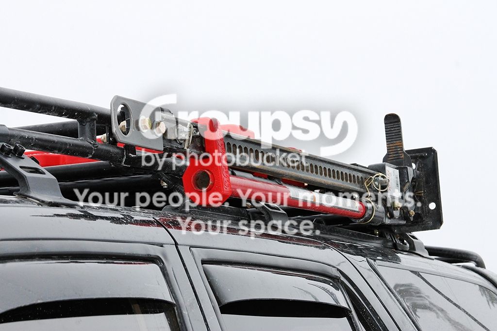

In preparation for our last winter wheeling trip, I needed to have my essentials up and ready(literally, lol!)

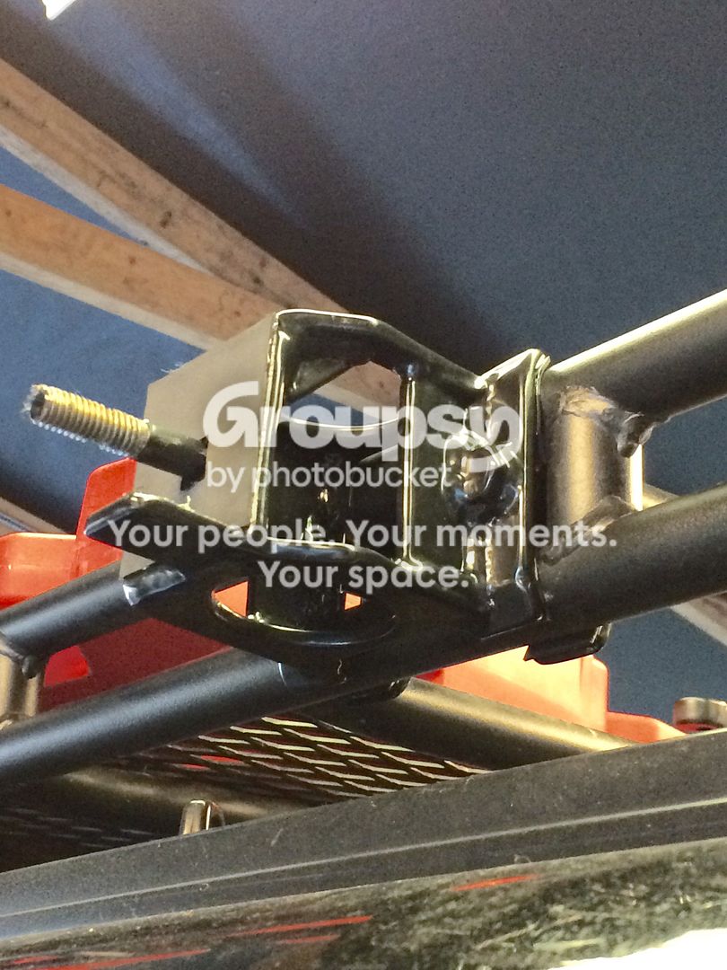

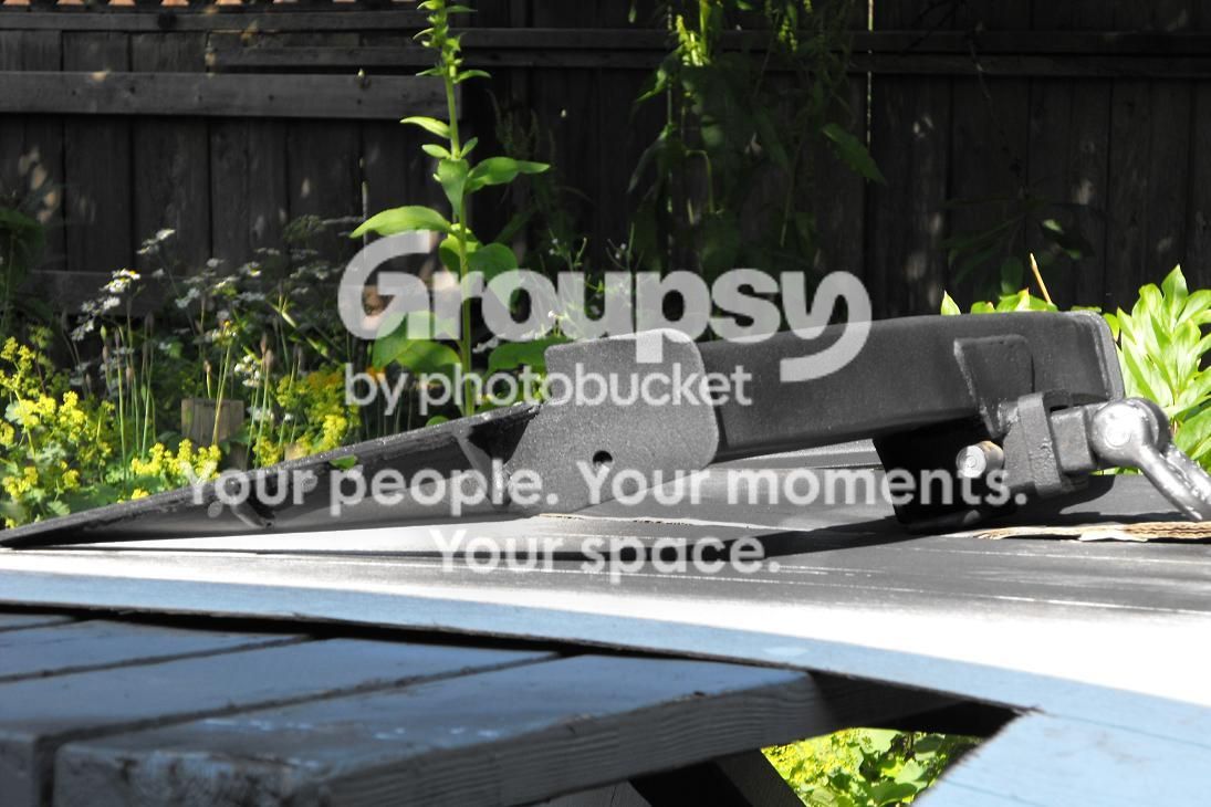

I'd made better use of the GOBI rack by making an axe/shovel mounts attached to it. Also, I relocated my hi-lift from inside the cargo area to the roof rack, too.
Majority of the steel used was 1" by 3/16" plate. I made the hi-lift mount stouter of course due to it's shear weight.

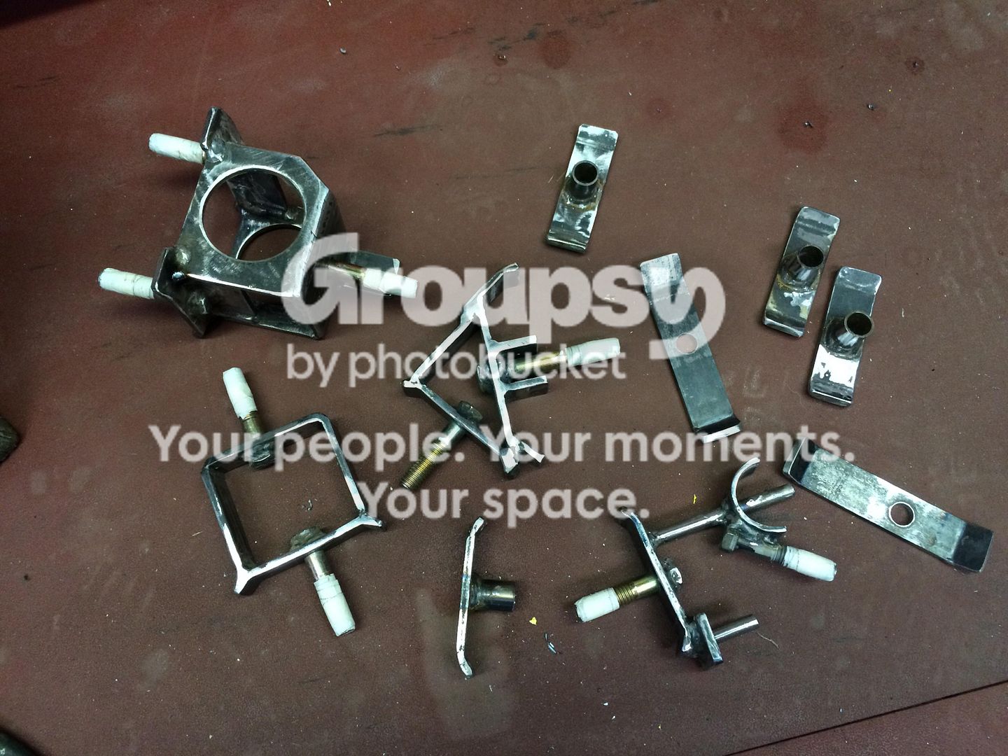

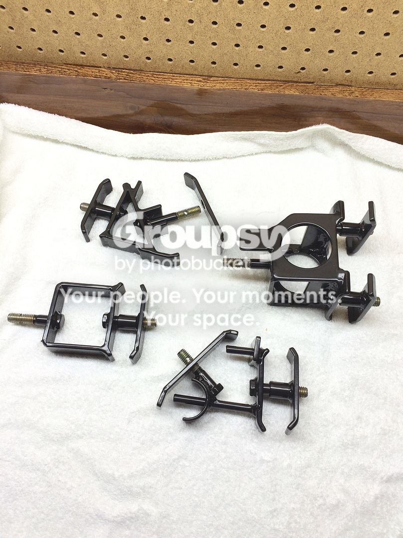

Here's the lot of it..
had these pieces powder coated..
Looks like some Chinese character:juggle:
Axe/shovel mounts..
Hi-lift mount..
I'll put up some better pics of the mounts at some point in time..
I think the accessories will stay up on the roof all year round, it adds on to the character of the 4Runner.

Love the LED's in the in-fill panel - I'm stealing that idea ;)
But why did you ditch the projectors and go back to standard headlights?

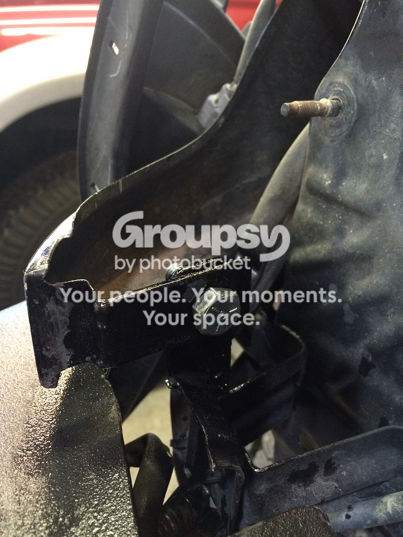

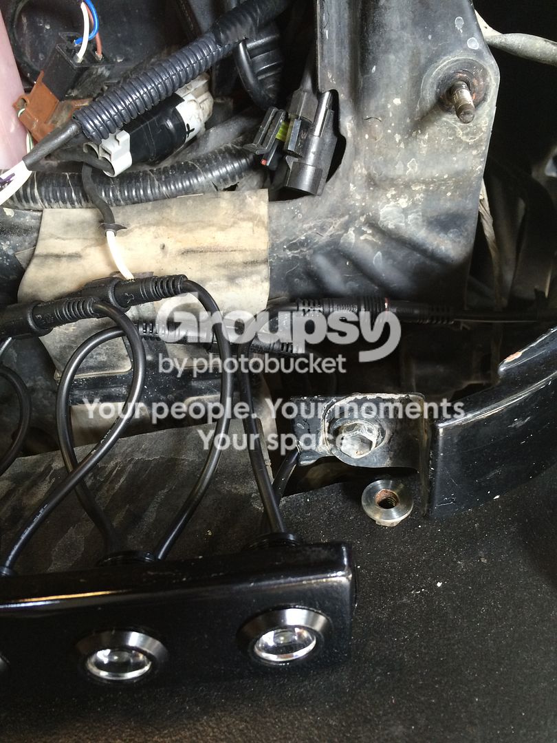

Steal away:guitar2: I must forwarn you tho, the filler panel filled with LEDs across is possible but not without some modification to the front fender where this filler plate attaches to. See the photos below.
I hit a minor snag here as the last LED to the right would hit the bolt head not allowing the plate to sit flush. Driver side fender shown.
Solution was easy enough..just a little re-configuration of the fender attachment..Passenger fender shown.
