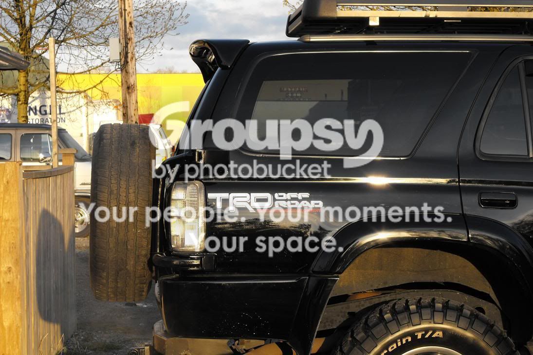

I'll be modifying the carrier in time and move it just a tad towards the center and lift it up a bit more to accommodate at least 33" M/T, plus it's good for departure angle as well.
The cost to bring the whole set up from Japan was an even $1000 CA, still considerably less than say buying an aftermarket bumper w/ tire carrier, but what attracted me to it the most is how the spare tire hugs the body of the truck close.

The only modification, provided you also get the rear door is on the hinge mounts, most especially on the bottom mount. The lower portion of the Surfs just below the tail light has some recessed area of about 1/4". The bottom mount has this 1/4" of protrusion that then goes into that indented part on the panel.
The pic is kinda small but just to give you an idea about the recessed panel on the Surf...look just below the tail light
liffffted-1.jpg~original
I didn't want to make any adjustments on the panel so instead I added approx 1/4" of fiberglass around the bottom hinge to make it fit flush with the body, otherwise you'll see 1/4" of gap around the lower mount. The upper mount was easy, you can either leave it the way it is or do what I did and also add <1/4" of fiberglass just for uniformity.
The reinforcement involved some welding of some thick ga. tubing to tie the panel and the d-pillar for strength both on the upper and lower mounts. Search Macgyver's Hilux Surf retrofit on YotaTech for some photos of the said reinforcements.

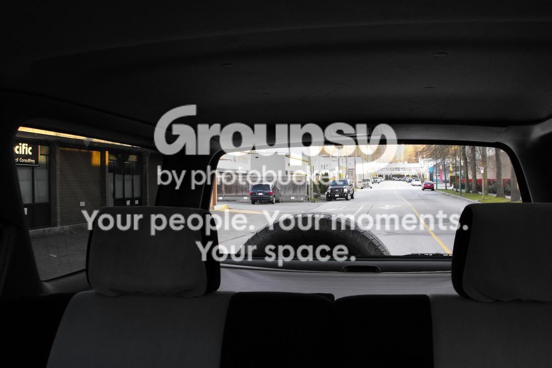

Can you take a picture of the rear view from the driver's seat? I am curious how much the rear tire carriers affect the rear view.

Here's a photo I took this morning...just for you man!
24.jpg~original
Cool, that doesn't block too much of the view. That is one of the main drawbacks I have thought about with the rear tire carriers.
How did you install the carrier mounts?
That's what I see from the drivers seat and yes the view is well...you hardly notice the wheel arch.
I had to drill 3 7/16" holes for the top mount and 2 for the bottom. Had some nuts welded at the d-pillar end along with the thick wall tubing in between the panel and d-pillar for reinforcements.
