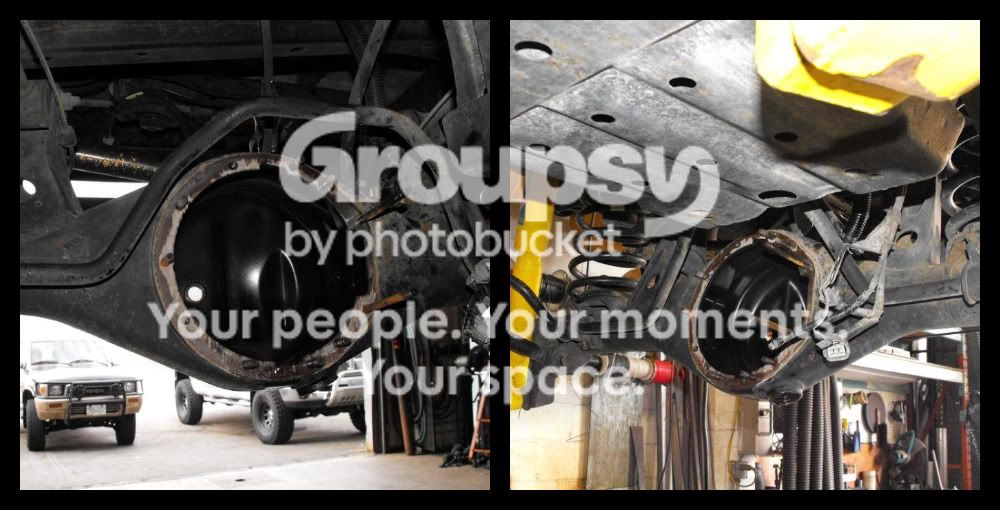

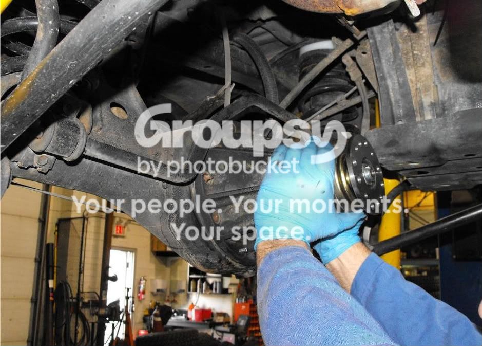

As some of you may already know I purchased a set of brand new Yukon 4.88 gears last December but it wasn't 'til last week that I was able to have it installed. Well....dust builds up no more and I'm glad it's out of the way and into my truck......whew..................Finally!
By the time i got into the shop they had already finished up the front end so I wasn't so fortunate to take up some photos, but just for the sake of this build thread, any photo to show for it is just as good as any.

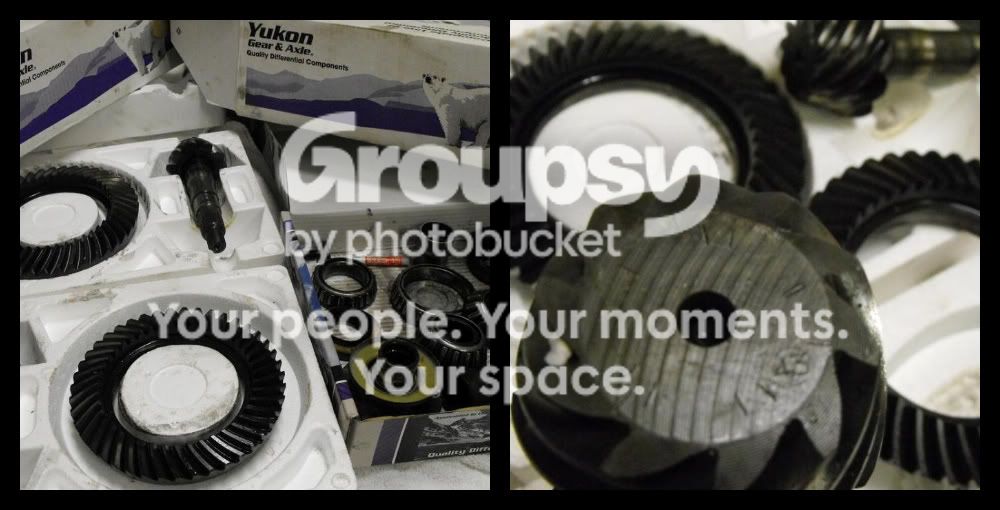

Stock 4.30 rear set
3-9.jpg~original

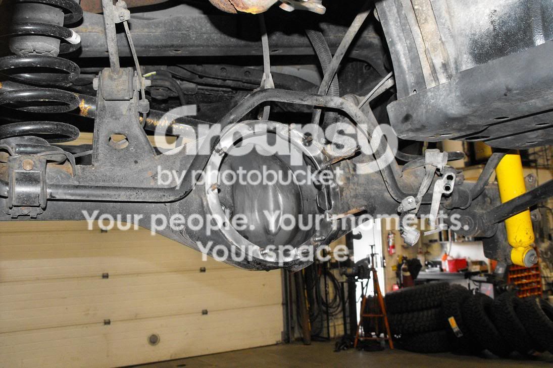

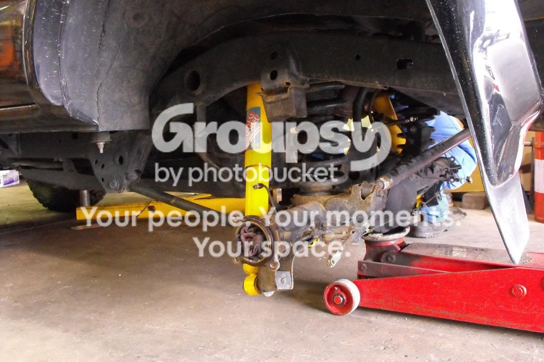

Axle off
2-12.jpg~original

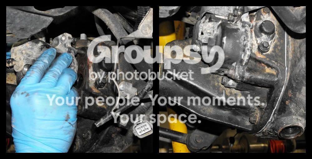

Once the axle was out of the way the stock 3rd member was removed and so was the E-locker actuator/motor.....
5-5-1.jpg~original
Housing and the sealant surface all cleaned at this point

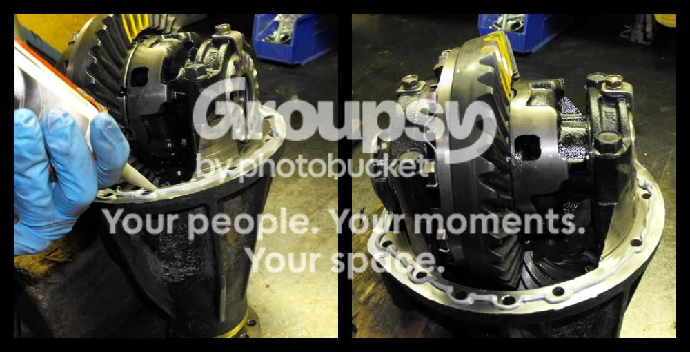

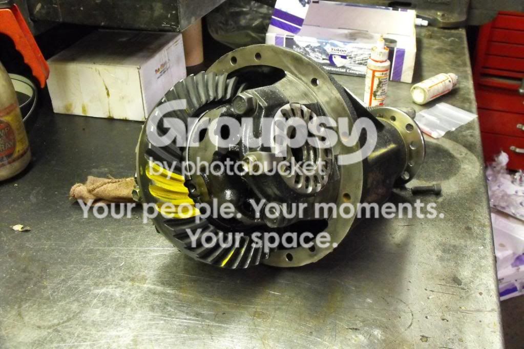

4.88 differential all set ready to be mounted
1-12.jpg~original
Bead of sealant around the housing
7-3-1.jpg~original
Just you hold on to that for a second pls?
9.jpg~original
Locker actuator re-mounting
12-4-1.jpg~original

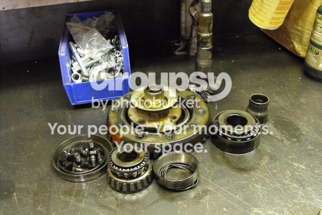

Here's some photos of the factory set with the old bearing kits. Even without counting the number of teeth to determine the gear ratio, you can see Toyota's fool-proof 4.3 brand atop the pinion, can't go wrong with that.
21-1.jpg~original

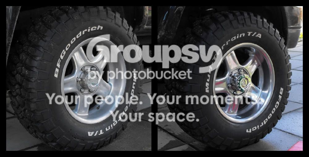

My wheels have been lacking some luster from wheeling and I thought I'd give 'em some good polishing. Used some Autosol courtesy of Fightman...very good stuff by the way, and it's brought back the shimmer from their weathered finish.
2-13-1.jpg~original

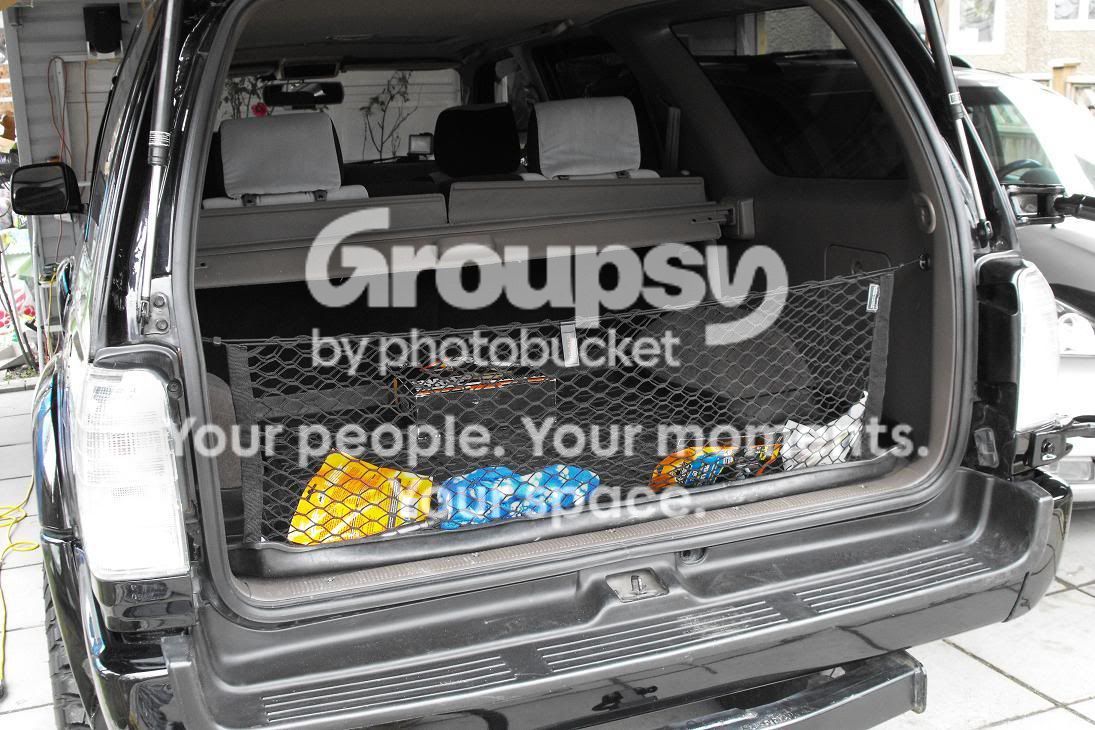

Installed my OEM cargo net I found from the junkyard...I now have less clutter in my cargo area...yippee!
17.jpg~original

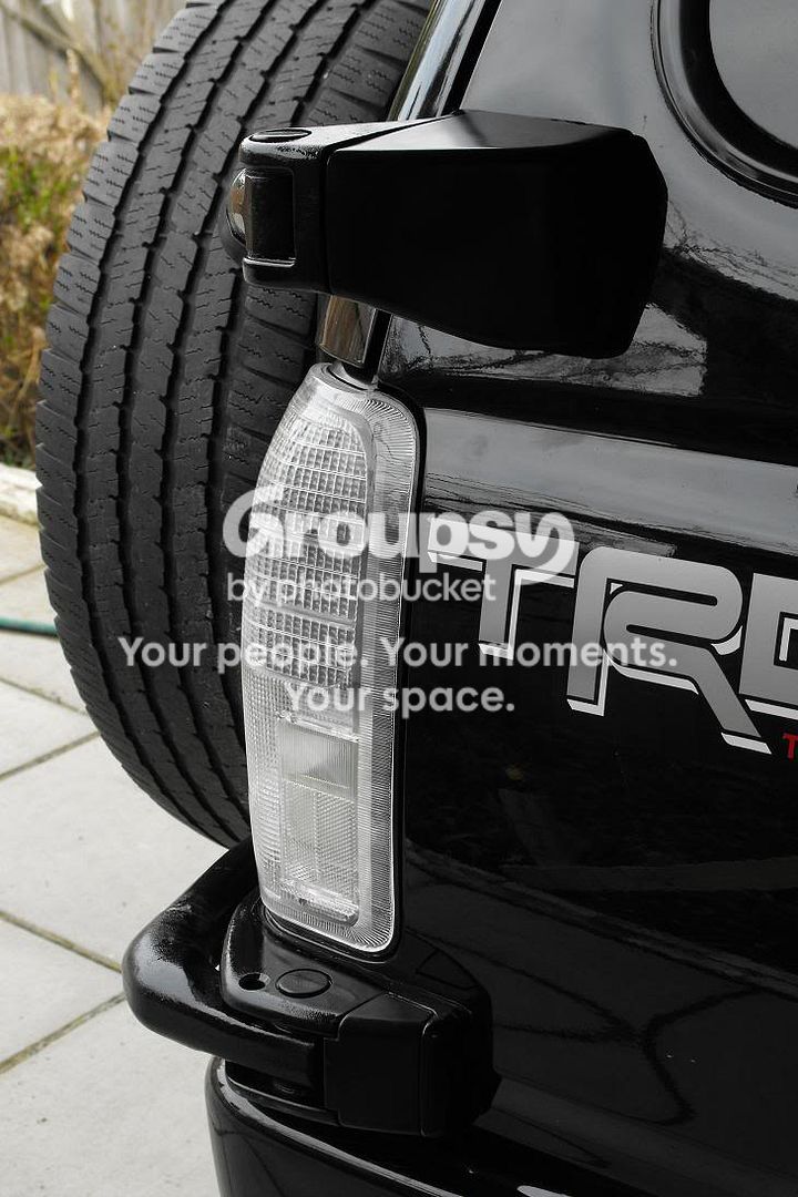

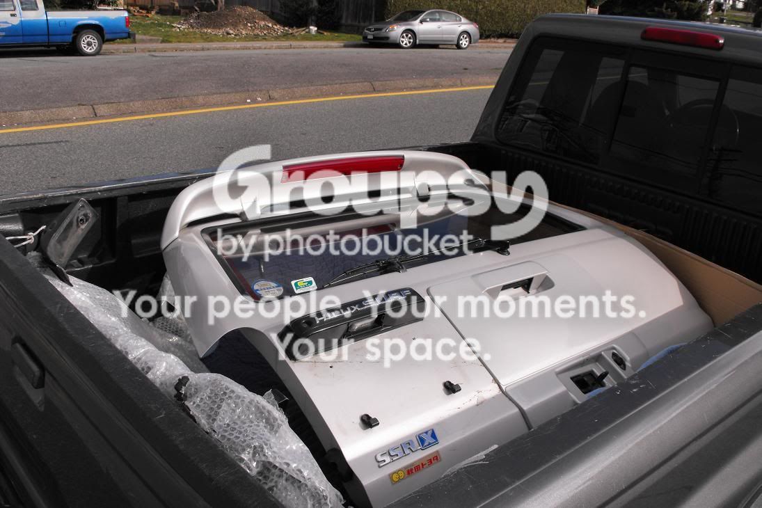

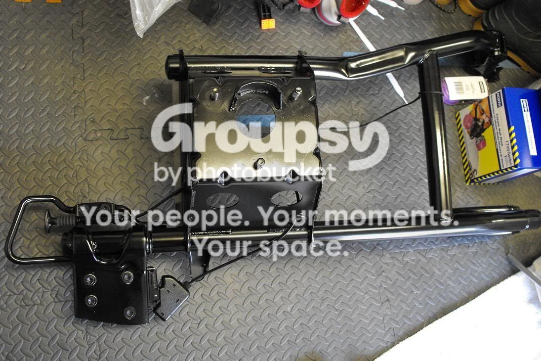

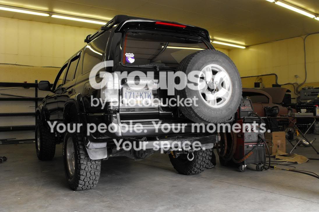

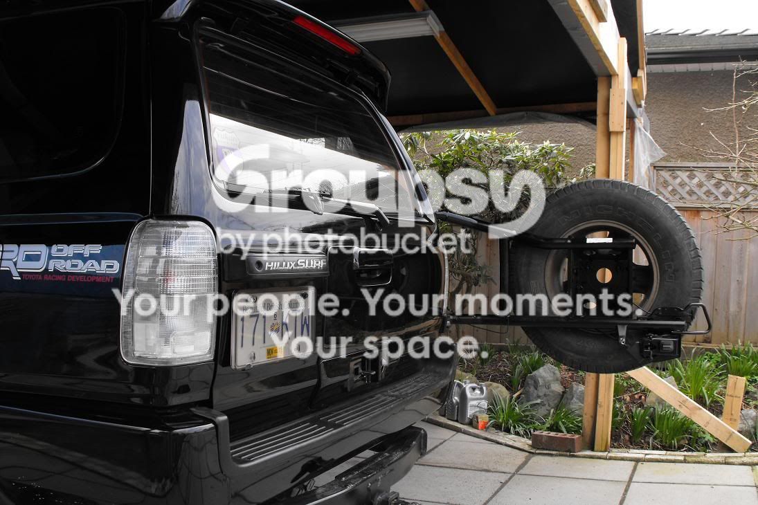

And finally....after 3 months it has arrived. I have always wanted to have one for some reason...The Hilux Surf swing-away tire carrier. The tail gate and the carrier itself were off of a '96 Surf SSR-X. It also came with the JDM rear spoiler just like the Jaos ones. The tire carrier is one hefty unit with thick plates and heavy wall tubings.
In the back of my pick up truck
3-10.jpg~original
Carrier after re-painting
1-13.jpg~original
Picture of the quarter panel mounts. I Used some 7/16" grade 8 hex cap bolts just for extra insurance, the reinforcements were the exact replica of Macgyver's retrofit in his '98....thanks man, for all the help!
16-2.jpg~original

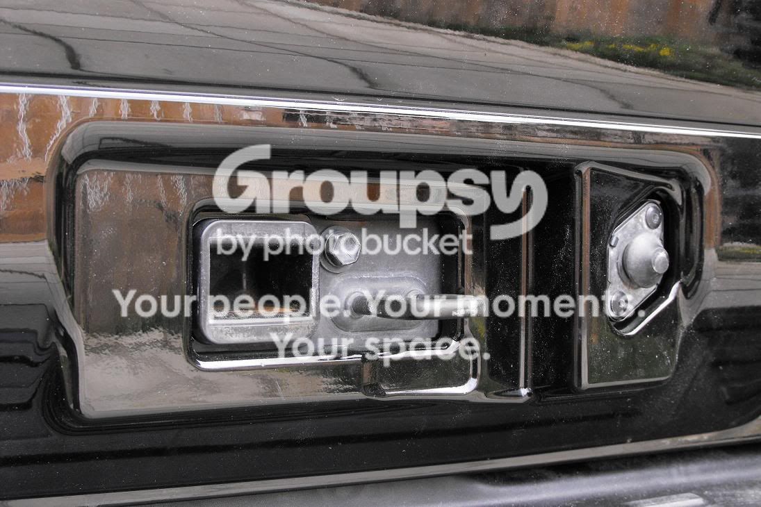

Photo of the latch mechanism and the pressure switch which I still have to wire, the carrier locks in place just like the doors that latch and then locks, and the pressure switch works just like the door switch connected to the indicator on the dash..atleast I would assume so.
18-1.jpg~original
Here's a quick video of the carrier and the Hilux Surf hatch. The 2 plugs/connector inside the headliner for the controls are an exact match, I guess I shouldn't be surprised, I'm just happy I didn't have to modify none as far as wiring goes. The only thing is that I have to find a locksmith to make me a new key for the rear Hilux Surf door- for the auto roll-down feature, even If I hardly use it.

With the carrier open
9-5.jpg~original

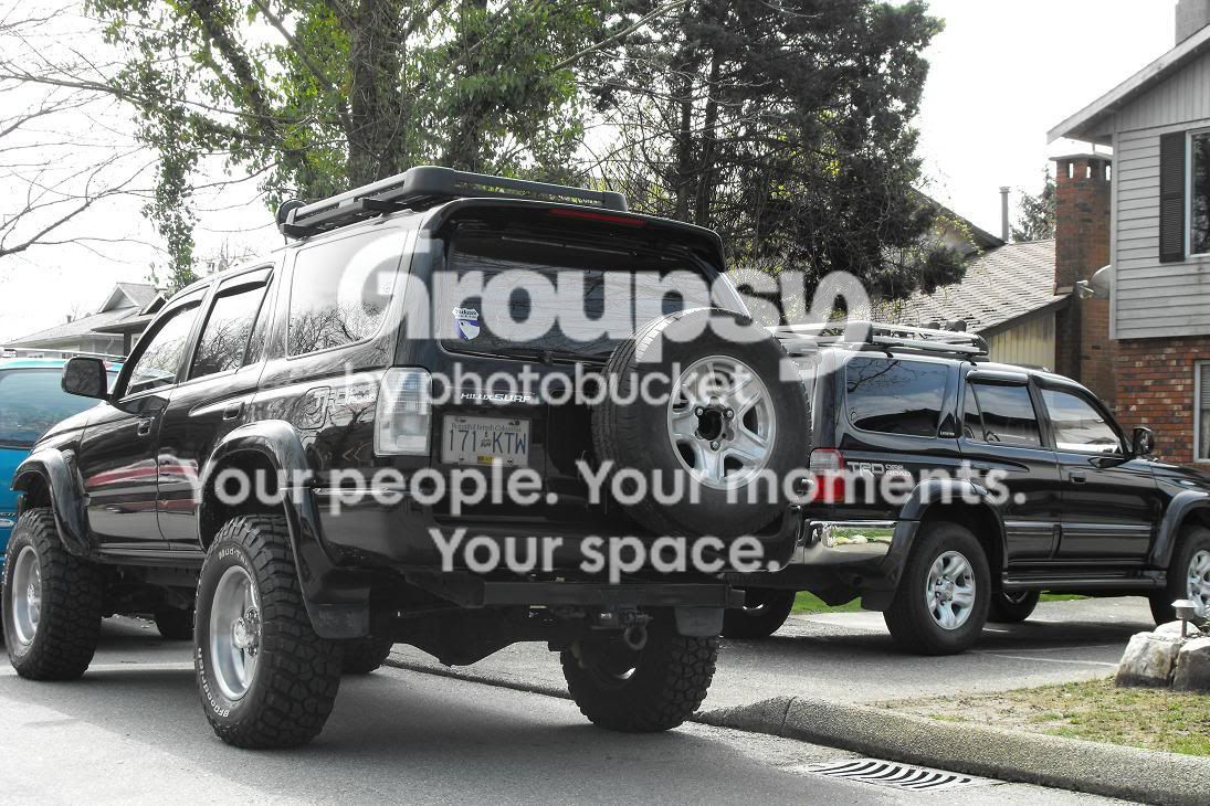

I just had to show my buddy my former 4Runner...:jk::jk:.ha ha!
5-9.jpg~original

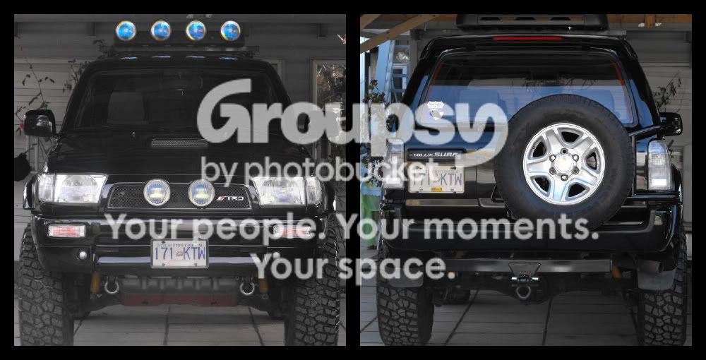

Photos of the front and the revamped rear
12-4-1.jpg~original
My 4Runner Hilux Surf...hope you like it!:D:D
14-4.jpg~original

Looks good man! I'm really not liking you now! HA HA HA! For a while, I was the only guy that I knew of who had any kind of tire carrier that didn't involve changing out the whole rear bumper......:uzi: HA HA HA! The only thing I'm partial to, between yours and mine, is that mine is centered in the rear of the truck.....but yours is definately a better looking contraption! Why didn't they bring those over here too??
Great job on the install! Just out of curiosity....what does one of those setups cost???
This looks sick, I love the tire carrier and the surf hatch gives the runner a nice new look. You need to put some details up about where you ordered all this from and how hard it was to do the conversion. :bravo:
Looks awesome! How much was the rear from the hilux?
Can you take a picture of the rear view from the driver's seat? I am curious how much the rear tire carriers affect the rear view.
All I have to say is WOW!!! I've always wanted a rear tire carrier, but all I've seen use an aftermarket rear bumper which to me doesn't look that clean. But that.. That right there is as clean as it gets! I really want to know where and how you got that there in place so I can do the same someday! :D This 4Runner has become my favorite now.
