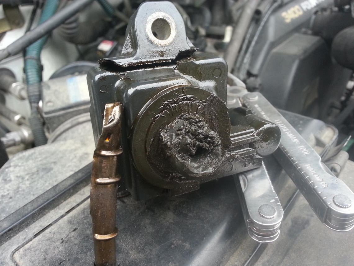

295k on my 1998 runner and on my way to work this morning experienced a loud pop, pop, pop coming from the engine, limped it off the road about 1000' to a parking lot and discovered oil coming from the top of the valve cover on the right side. had it towed home and started investigating, the middle coil pack boot was completely melted away and I fished the spark plug out which was just sitting in the sleeve and it was in rough shape with no terminal nut left on it. not sure the root cause of this but either I picked up a new coil pack and plug set (to replace all while i'm in there) and got the new plug to turn about 1/4 of the way in and stopped, I don't want to torque it anymore as it seems damage to the threads on the head has been done. what are my options (cheap) to get the plug back in? I don't want to remove the head if I don't have to but if it's the best thing to do then will.. I am not super technical but am willing to learn and have tools.

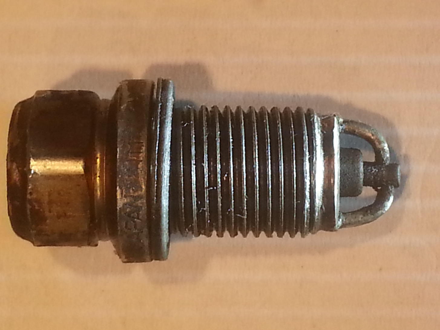

interestingly the threads on the old plug look fine except for the very last 2 on the bottom. I think it worked it's way loose somehow and banging around in the sleeve caused damaged the bottom threads.

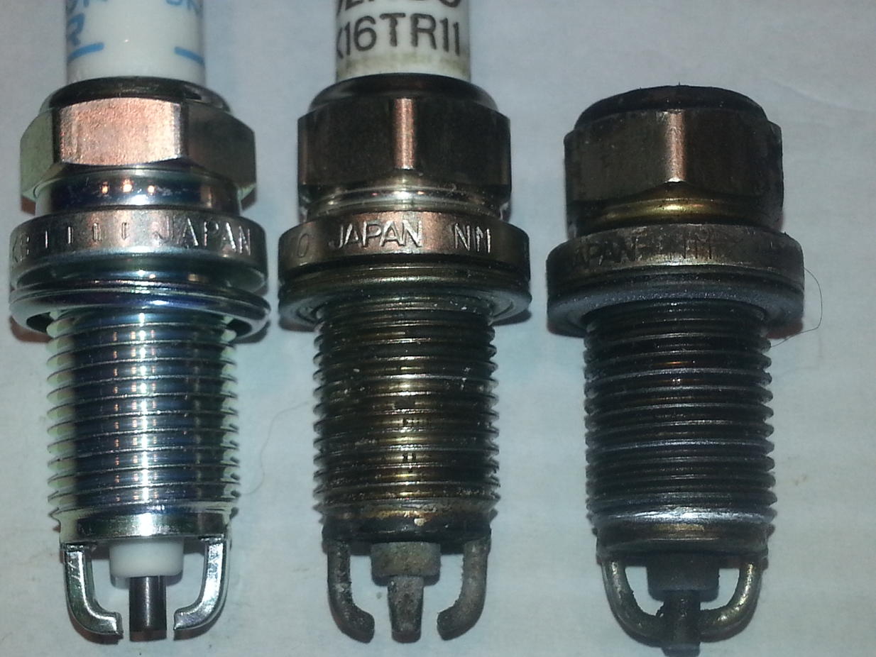

here are a couple of pics showing the blown out plug next to another that I took out to compare as well as a brand new. the blown out one has obvious damage on the bottom threads and after the first 2 or 3 they look ok aside from the edge being a bit flatter. i can get a new plug in about 1/4 of the way before it stops so that tells me the first few threads are fine but below they are worn. based on this does it look like a tap might correct rebuild the threads without having to do a helicoil or timesert? not sure
also there is a pic of the damaged parts, the coil was cracked at the mounting tab due to the pressure of the plug hitting it i guess.

Looking at that plug, I'd guess you're correct that it wasn't torqued right and just backed out over time, until the last one or two threads let go. Maybe I was too pessimistic - chase the threads real good, and see if you can get a new plug to torque. You might have gotten lucky here. :)

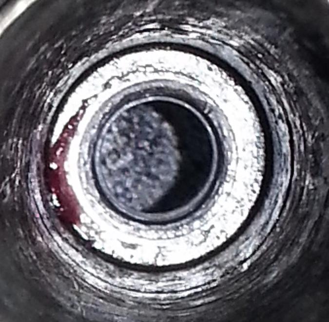

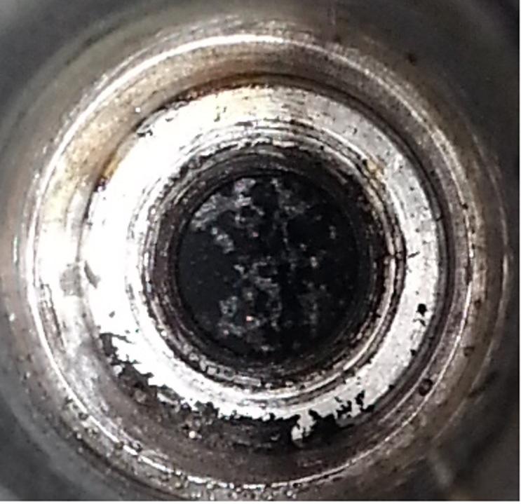

I went ahead and ordered that one but was in town today so stopped by autozone and they had a 14mm spark plug thread chaser for $8 so I bought it. I tried it but noticed that it turns in really easily which was unexpected. it also feels loose, I put it in another plug hole and could only get a turn or two before it tightened up. I also noticed what looks like a ring at the bottom of the hole on the damaged hole which and the "ring" is slightly smaller then the rest of the hole. the good one doesn't have this. I am kinda at a loss here for what is going on. it doesn't appear there was any modification done to it (helicoil for example) just not getting why the chaser is so loose and the new plug still get's stuck 1/4 of the way in. I spec'd the chaser with my digital caliper and it measured 14mm so it is the right size.. I guess i'll wait until I get the one from amazon and see what happens.
It just keeps sounding like those threads have been stretched AND partially removed (that ring you`re seeing). Its looking like some thread repair to me, as bad as I hate to say it.
I am going to try the backtap but if that doesn't work will put in a timesert. With all the shavings possibly dropping into the cylinder I plan to blow them out with an air compressor. What is the best way to make sure the exhaust valves are open? My understanding is they open on the second sroke of the cycle but want to make sure I have it right.
here is the ring I am talking about you can see it clearly compared to the other "good" hole. chaser/backtap did nothing. i'm afraid it's time for a time-sert. now to try to get this done with out taking the head off. luckily there is good clearance from the top.
