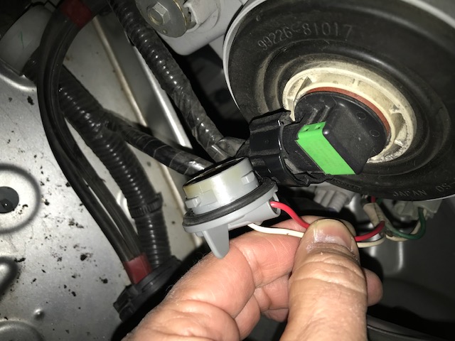

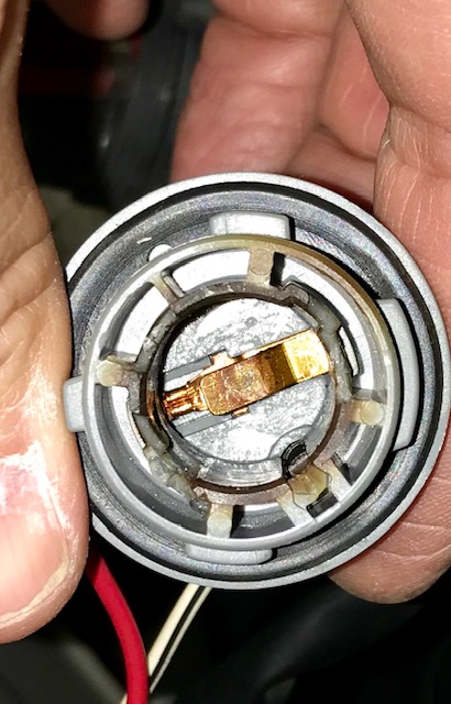

is there a part number for the 1156a bulb socket on the 2008 4 runner? I broke the socket getting a bad bulb out! may be a harness assembly??
I'm also looking for part number for this socket. 2006 4R Sport with DRL. Takes the 1156 bulbs. Broken bulb while removing and couldn't get the broken socket out of the assembly.
