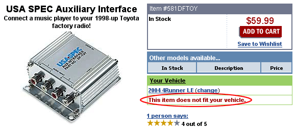

When I go to Crutchfiled looking at the product info.. I got this....
Are you sure it works with our T4Rs with JBL system?

when i put it in, i chose 2k4, toyota, sports edition, jbl without navigation, without changer
and it says it works.

What I did was basically the same, except I selected 4Runner LE with JBL audio system; without Navigation system; with in-dash CD changer. I think with the in-dash CD changer, they consider the CD changer port is already used.
