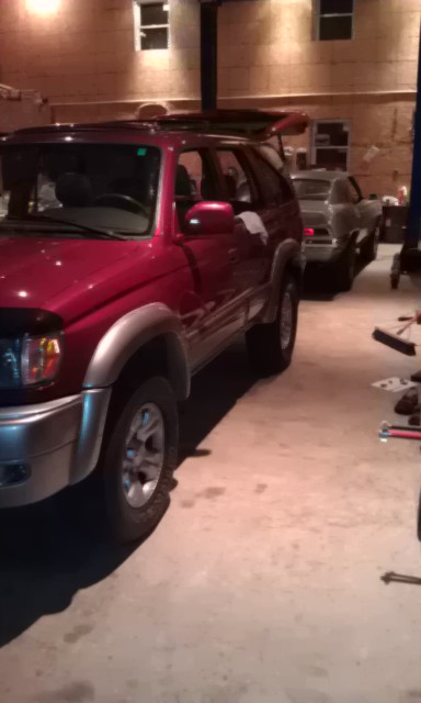

Would that be a 69 Camaro if my tail light recognition doesn't deceive me?
Great eye. My Dad and I have been restoring it for the past 7 years and it should be road ready this coming spring.
