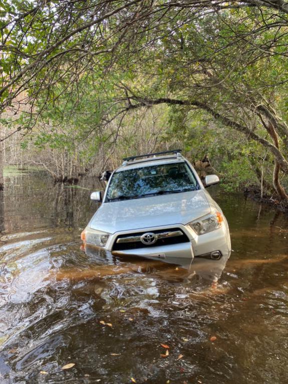

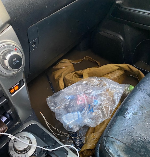

I had a bad water crossing. Since then I have removed seat, dried everything out ect. The only issue I'm still having is that the blower under the passenger side does not shut off. Even after the engine is shut down. I had to disconnect the battery. The blow does look like any water touched it. Could it be the control panel?

But the more interesting point is, where were you wheeling that required driving thru that much water? Puddle, swamp or river crossing? Did you get stuck? How'd you get out and how long was it in there?
Flooding is just about the worst thing you can do to a vehicle. You, or a competent mechanic, needs to pull out all of the interior that got wet, dry those pieces, and check and dry any and all electrical connectors. Some electrical components could have been damaged by water, and might need to be replaced.
You'll also want to check the rear axle, front diff, and the rest of the drivetrain for signs of water ingestion. Change any drivetrain fluid that has been contaminated with water.

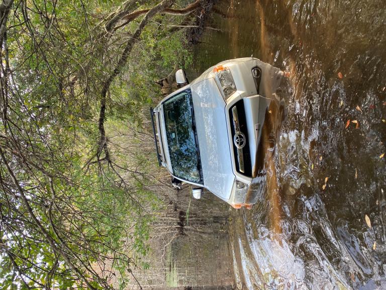

I live on the pan handle of Florida. It was a road I have been down before, so the hurricane must have added more water. I walked half way down and it was below my knees. Obviously the right side ended up having a big dip. I climbed out the driver window and deflated 2 tires. Then used A-Trac to move forward, followed by a hard reverse to get out the hole. Probably spent 10 minutes doing all that. Drove out back home. Ripped out seats and carpet. Cleaned, dried wires and RE connected. Only thing that is messed up now is the blower never turns off. The water was well below the control panel. I have unplugged the blower so now I don’t have to disconnect the batter.

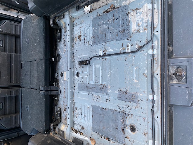

I pulled the back apart and had a bunch of mud under that carpet. I also changed the oil and both Diffs. The diffs had no sign of water. Now the starter is acting up. I still need to pull the driver side doors and lift the carpet and dry that side out. I'm working on it when able, since I still need to drive to and from work.

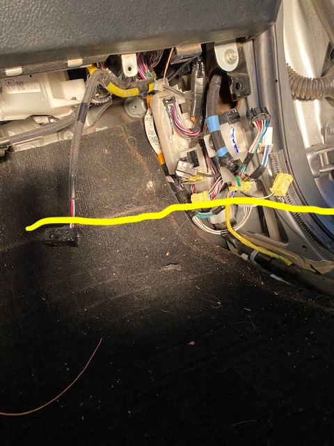

More Pics

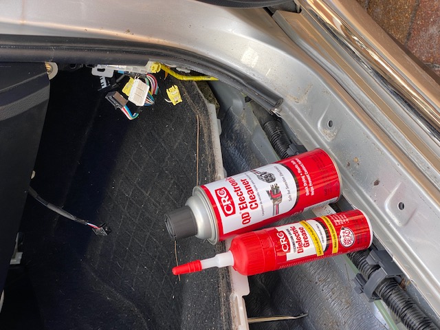

Pic 1: After drying the connectors out under the seat and under the passenger side I hit them with these products
Pics 2:Under the back carpet
Pic 3: Approximate water level
