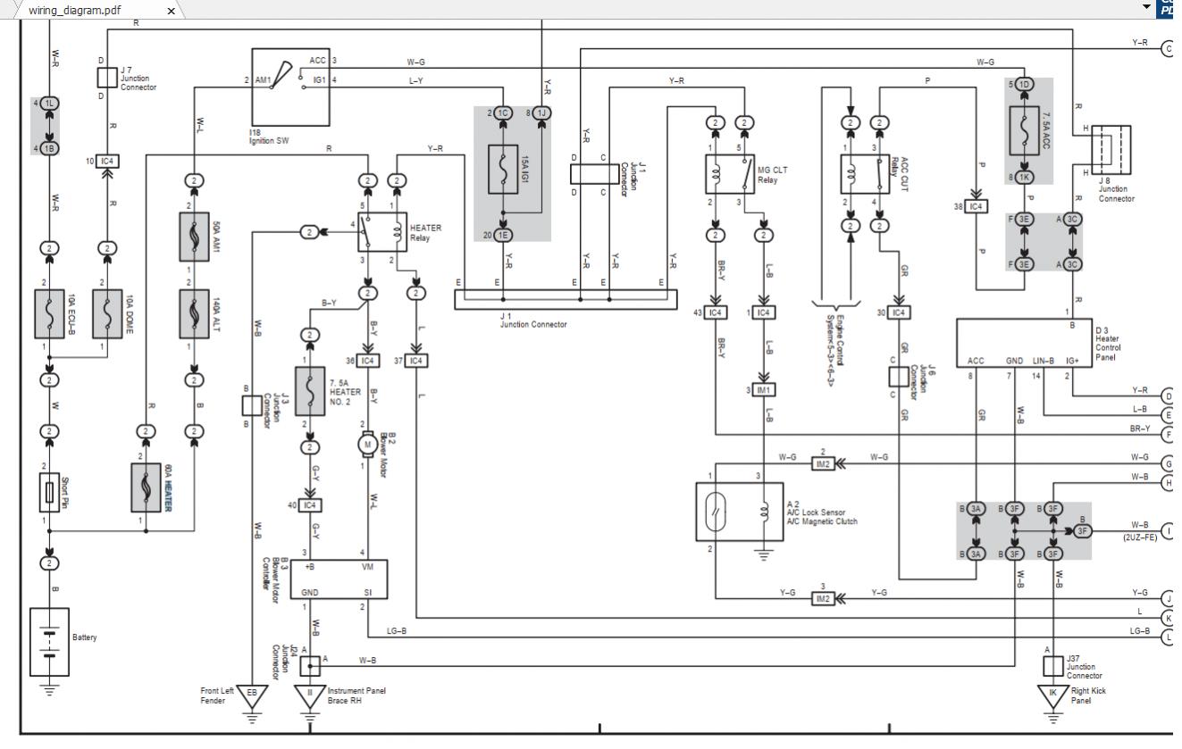

As for the relays I watched a helpful video last night. There's a 60amp fuse that sends power to a big heater relay. If that relay works it sends power to the little 7.5amp fuse I keep having to pull. I'll pull apart that relay and clean it if need be.

There is a second contact for that relay in the off position, so it may indeed be sticking, there would be no power to either side of 7.5amp fuse if it were. If there is power there then the problem is likely in the contacts at that fuse or in the blower motor controller. Here's your circuit
