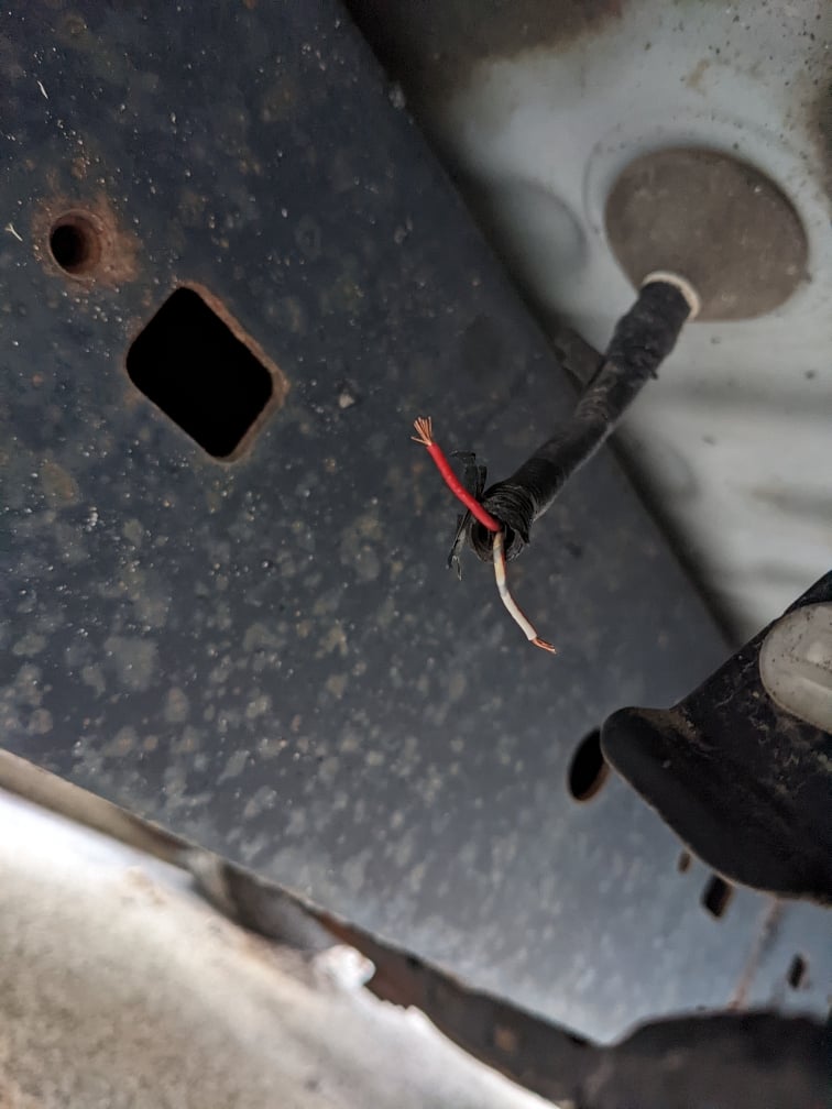

Hi guys. I know this is kind of an old thread but I'm having the same issue. Fuse blows right away. I took out the driver side sun visor and it still blew. That was the only spare fuse I had. I subsequently took the passenger side visor and tested both on the bench by supplying power and they both function properly. The light comes on when I slide the cover. Wiring looks intact.
I ordered a 25-pack of 10A fuses that arrives tomorrow so I can do more testing.
Could it be the running board lights? I can test by disconnecting them.
Any other common cause for this?

The common cause is a short in the circuit.. Also, just because you pulled the visors off and tested that the work on a bench doesn't necessarily mean there isn't a short when the visor is in the closed position. However, with the amount of wire paths there are in this circuit I would start looking elsewhere.
Just as a note of advise, don't do what was suggested 2 posts up and install a larger fuse. lol
Thanks. Definitely will not put a higher Amp fuse. It's rated at 10A for a reason.
I will test with both visors out and see what happens. Hopefully it won't be a major pain to track down. Luckily the fuse is for things I can live without for a while and doesn't affect the drivability of the truck.
Turn out to be the wires for the passenger side running board lights. The wires were completely out of the plug and touching hence causing the short.
It will be an easy fix. Glad it's as simple as that.
