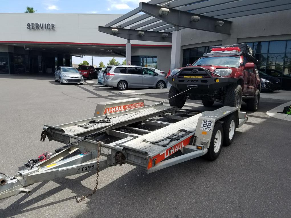

Soooo...I take a vacation last year of biking and going around CO. So over the course of the year I build my truck so I can go to places other can't, bike and...stay in my RTT instead of spendy hotels. Well...this year I take a 2 week vacation to go to Bryce/Zion/Moab/Telluride/Ouray/Alpine Loop/ect. I leave on a Sunday (first day of vacation) and stay in Mammoth on Sunday night. Monday, grab some breakfast and head towards Bryce/Zion. Well, middle of Area 51 (literally) my CEL comes on along with the christmas tree on the right. I'm going up a grade so I figure just make it over the grade and cruise on down the other side. Well, little did I know the whole time coolant was spewing out everywhere. Halfway down the grade my engine just dies and I coast to the shoulder. F***! I see what I think is smoke so I pop my hood, get out and run to my hatch and grab my 5lb fire extinguisher. Do I let her burn to the ground? He** no! There is beer and food in the back and I don't want to start a desert fire! Well, it wasn't fire, it was hot cooland and steam from the return line from the cap to the reservoir spewing lovely colored pink coolant ALLLLLL over my engine compartment. SH*T! Not good. Sooooo I spend a half hour looking around my engine and noticing all my skids and wheel wells covered in coolant. Finally call AAA. "You should hear from them shortly." OK...I have beer in the back. Car won't start. What will they do? Pull out my chair, put on sunscreen, put the keys on the front left tire, pop a craft brew. Wait. Wait. Wait. Finally....1hr phone rings on 3G network. "Hi, will be there in an hour." SH*T! Do I pop my BBQ out and cook the rib-eye I have in the fridge? Nah, I'll wait. Time goes by...one beer, two beer, three beer...F*CK it! Lighting the BBQ up. Well, truck pulls up. Load her up 3hrs later. Now it's the 2.5 hour trip to Vegas.
Get to Vegas, unload at dealer. Appt first thing in the morning. Stay at some crap hotel. No I don't gamble or really like strip clubs. Prefer to spend my money on other things. Dealer says $135 to diagnose coolant leak and $135 to run codes. Uhhhhhh, codes have to do with the coolant dontcha think?! 2 hours later and them telling me it'll be $500 to pull part of the engine apart and/or $9000 to put a new engine in a decide, I'm towing this ***** home. I can do my own work! So after Penske told me my 4R was a fat pig and couldn't go on their trailer a U-Haul was rented and back to NorCal it was with her with an empty truck and a full trailer and SUV. 2am. Park.
Next day unload it and put the 4R in the garage next to Triumph TR4 restoration project. Shut door. Say goodbye. Go home. Use miles to get plane tickets to CO. Leave because just don't want to deal with it and it was supposed to be 100-115 for the next 5-7 days.

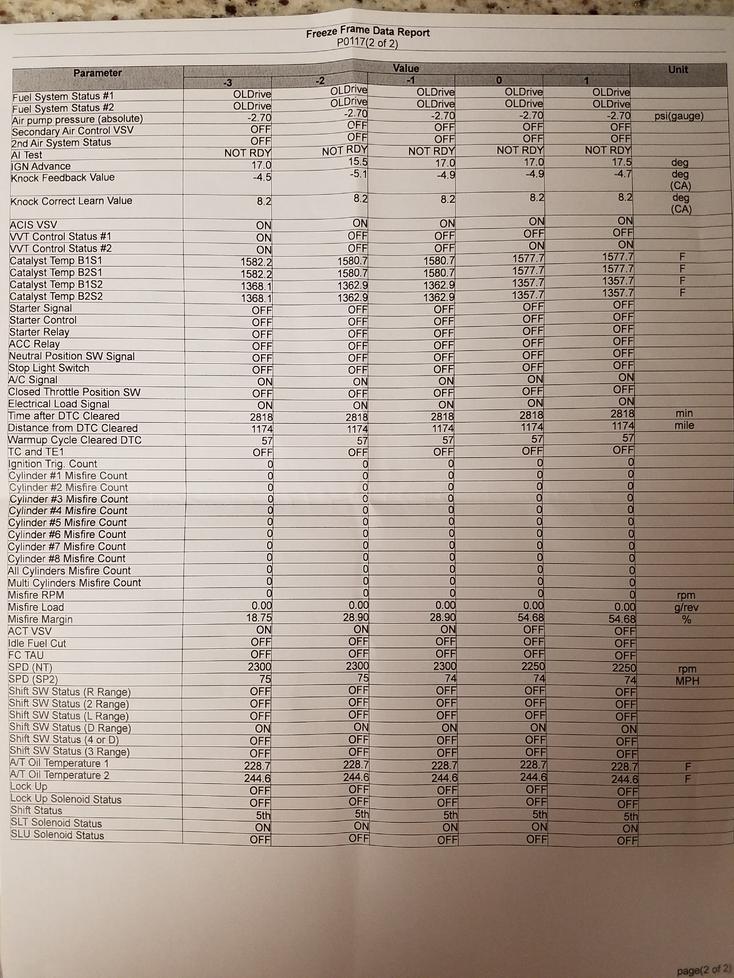

So here we go, get back Wednesday night and then Thursday do a quick compression check. Front forward right (1)-100 Front right (2) - 60 Front left (1) - 0. Stop that. Drain radiator (see pic). White chunks. No...not me throwing up from drinking. Buddy thinks stop leak was used. Does have an exhaust smell to it. Definitely not a coolant smell. Tear off complete front end and nothing seems out of place. Timing is on. I'll bearings are great. Everything....perfect. So all I can think is, that shit in the radiator clogged it and it backed up and caused the coolant to spew out the hose connecting near the coolant cap and the reservoir. Oil has a VERY bad "burnt" smell to it. I definitely overheated the engine. Sooooo, my question to you gurus is....

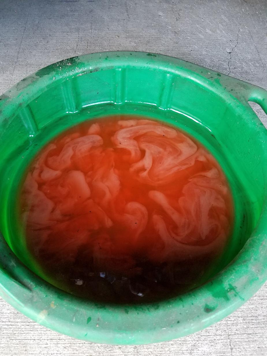

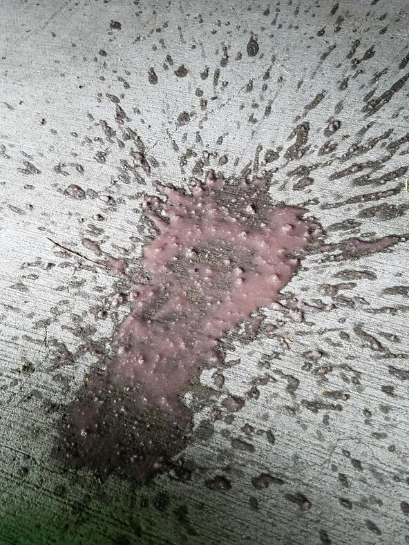

3. Buying a new heater core and going to swap it out. I know...overkill, but I heard it girgling and you should have seen how much white stuff came out of my radiator. So I can do this

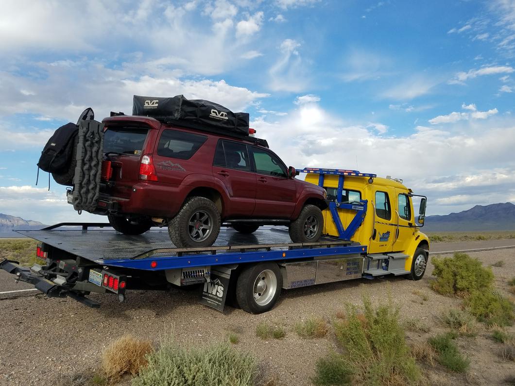

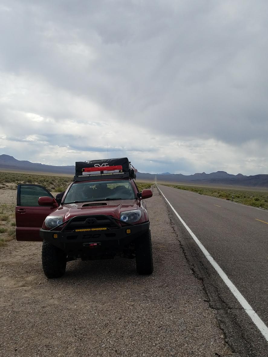

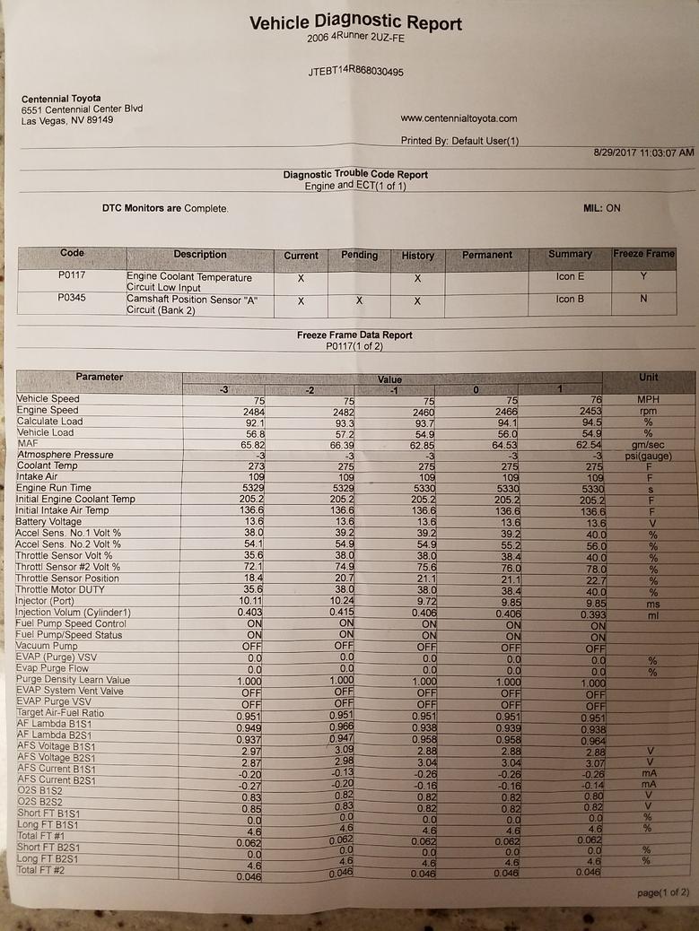

Pictures: Stranded in desert. On the flatbed. Winch works (Gotta load the trailer!). $135 diagnostics even tho I had an app. White stuff (Gross). White stuff in coolant that smells like exhaust. And the gunk in the radiator AFTER it was flushed (took a good minute to flush it all out)

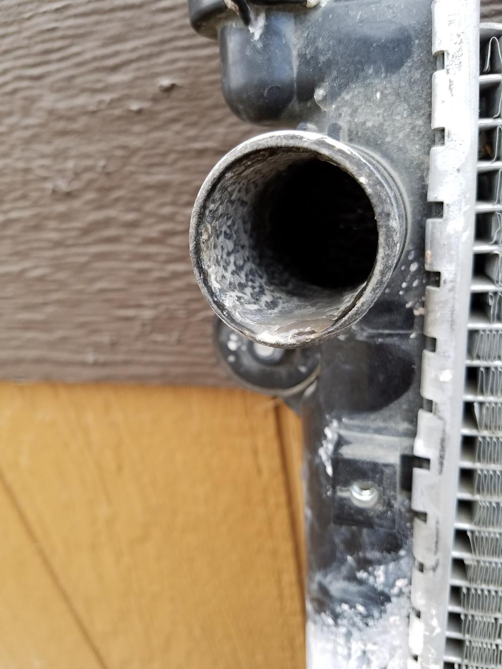

If its that far torn down, I'd pull the heads and check the cylinder walls. My guess is clogged coolant passages with all the stop leak crap. And with 0 compression on one cylinder (if I read that right) its going be a cooked valve or blown head gasket?
Would recommend cutting ties with the engine. You have compression going into the cooling system, problem being head gasket(s) and heads that now need to be serviced(not to mention possible damage to the block).
Have to price out 2UZs in LC200s all the time at work due to the coolant Ts(back of engine splitting coolant to heater box and rear AC) cracking without warning and the customers running them hot.
Grab a nice used motor(source from LKQ or similar), buy a new Denso rad(and hoses) off Amazon, and just clean the heater core out with water from both directions when the engine is out.

Factory temperature gauges (and/or the sensor) can be notoriously insensitive to sudden changes in inputs. Result is what you saw: sudden temperature spike and the gauge doesn't budge.

Well, I took off the intake manifold yesterday. It was melted on the passenger side which caused the plastic to go down into the intake tube. PRETTY sure that this engine is toast. Every experienced Toyota tech I've talked to said if it got that hot that motor is done. I found one for a good price with 140,000 from a reputable place in the Bay. So may go that route.
