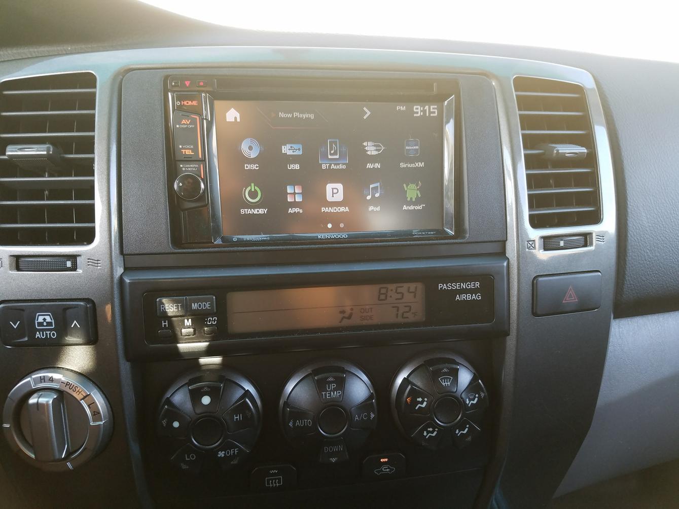

I have a Kenwood i purchased from Crutchfield.com. I was able to add bluetooth audio streaming, bluetooth for phone calls (came with microphone), and backup camera (purchased separately). Purchased the adapter from crutchfield for steering wheels controls.
All in all I am quite happy with it. My only complaint is the volume knob is too small in comparison to the stock stereo (I had the non nav jbl system in there before). Luckily i have the steering wheel controls :D
Did you have to use the pac or metra wiring adaptor? I want to pick up a scion head unit but have heard nothing but headaches about volume issues and stuff.

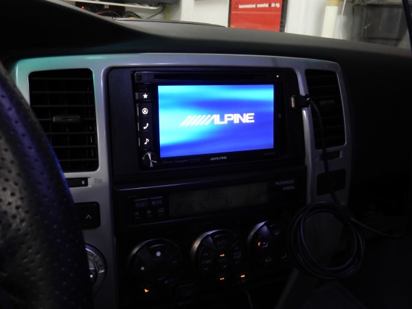

I put in an Alpine head unit. Bluetooth and navigation.
Added an Axxess steering wheel adapter kit. No issues at all.
I dont remember, but if you go on the crutchfield website and pick a unit and hit checkout, it will give you the option to select the adapter. It should have the detail on the kind of adapter there.
