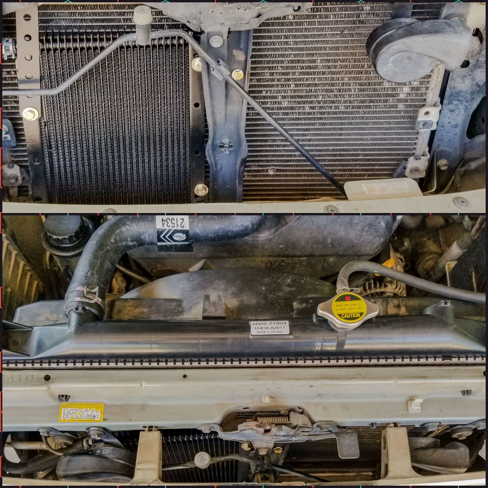

I flushed both the coolant system and the transmission, the PO had switched to Prestone green, after 10 gallons of distilled water I switched it back over to Zerex pink (I really wanted Toyota red, but my local dealer refused to order any for me), the trans got a full flush with MaxLife.
In the middle of all this I also replaced my radiator (OE), thermostat(OE), and radiator hoses (Gates), and maybe most importantly mounted a trans cooler. I went with a Hayden 698, it's the same size as the TRD cooler, buy has a pressure by-pass that doesn't send fluid through it until it hits 180°F. I also replaced my horns with a pair off a Lexus LS400, they're a lot better sounding and are plug-and-play.

Here's a picture of how I rigidly mounted my trans cooler; I didn't want to do the whole zip-tie through the condenser/radiator thing, it just seems stretchy to me and would make replacing any of three a pain down the line. Also, here's my horns and other new parts, posts are always better with pictures.

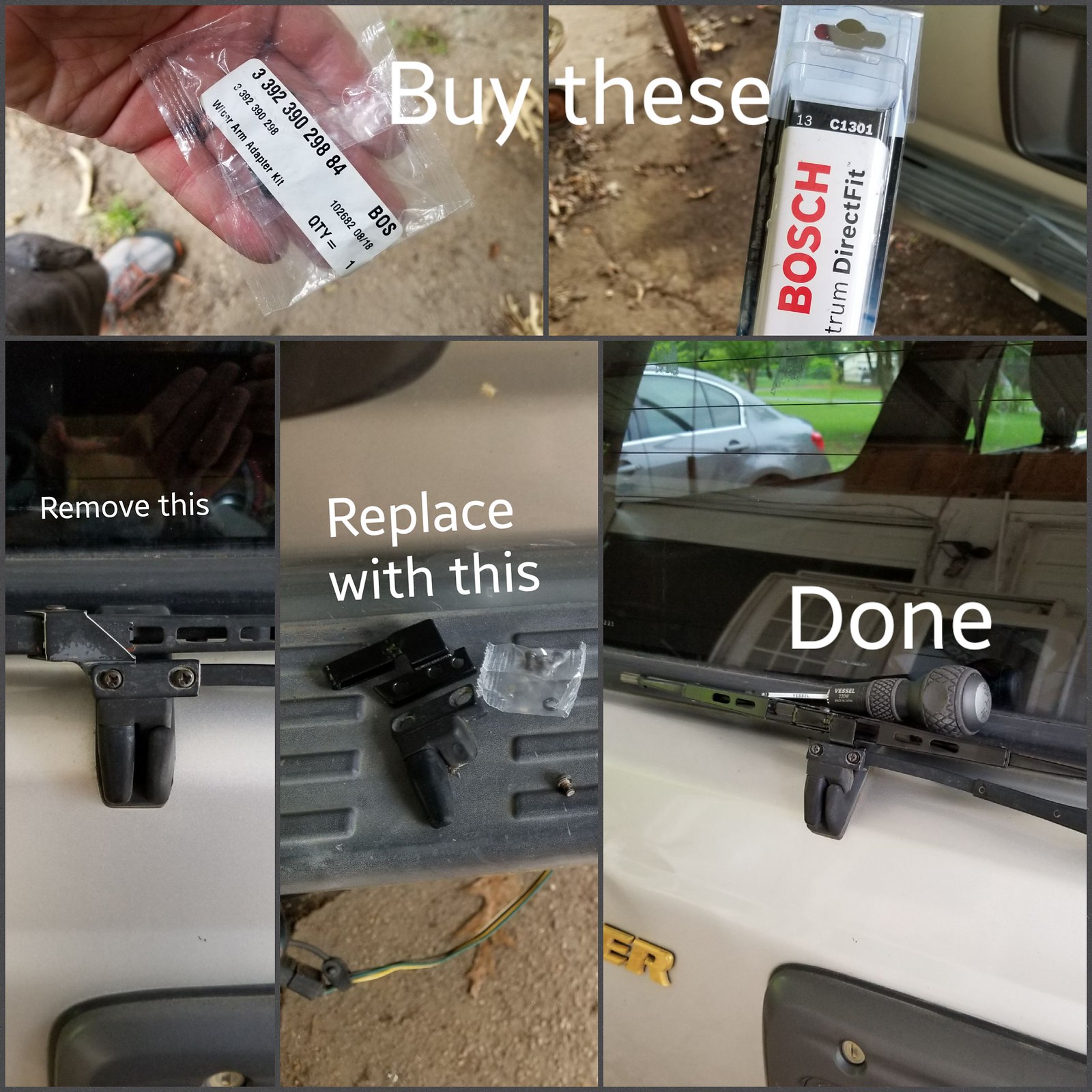

I did replace the rear wiper though, and converted to arm to standard J-hook from whatever Toyota had stock, everyone should do this...
Is this a Toyota adapter?

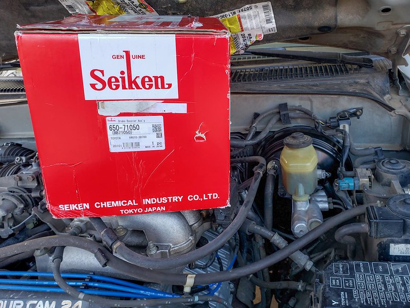

At some point during all my COVID hiking trips I realized my brake pedal had become very hard making panic stops impossible, so I started driving a lot more cautiously. After hiking and deer season ended I started diagnosing via Google and a vacuum tester/gauge, I determined it was the brake booster and some more Googling turned up the fact that the OEM is/was Seiken. I knew I wanted the OEM as a lot of people reported issues with parts stores' brands and the OE lasted me 20 years; in my search for the best price I got with Cruiser Yard as I noticed they great deals on Seiken boosters for LC's, and he was able to undercut everyone else's prices on 4Runner boosters and offer a 2 year warranty, also better than everyone else. I read a couple of how-to's & watched a a YouTube video on replacing the booster and did the swap today, I won't go in to much details as there's been plenty about it online, but if anyone has questions I'll be glad to answer them. I was able to pull off the job without completely removing the master cylinder, and you basically only need a 12mm deep well socket. Got everything buttoned back up and my test drive revealed perfect braking again.
