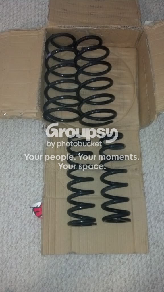

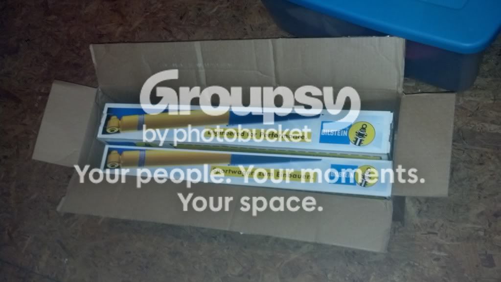

Some initial pics.
IMG_20131015_103349_123_zps875e767f.jpg~original
IMG_20130927_101754_708_zpsb496a74b.jpg~original
FJ springs
Just need to get a 1.5" spring spacer for the rear springs and will have pretty much what I need minus the time to install (the hardest part). Not looking to do anything crazy. Gonna go 1.75 on the fronts and plan on getting some 265/70/17's when it's time for new shoes.
